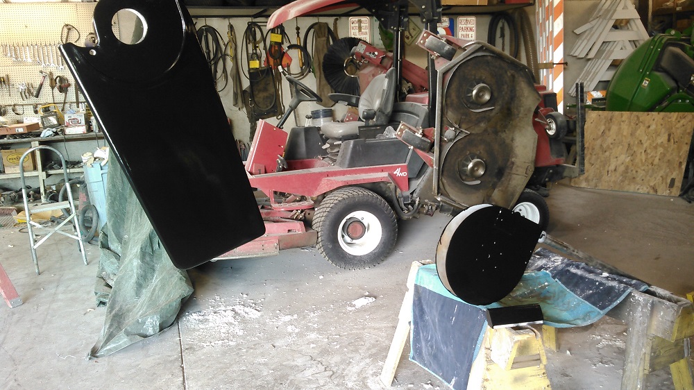

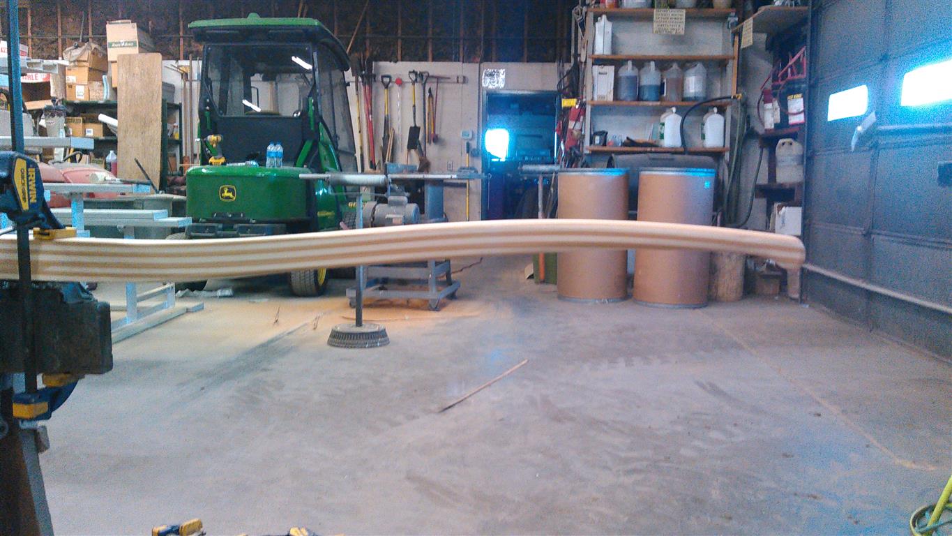

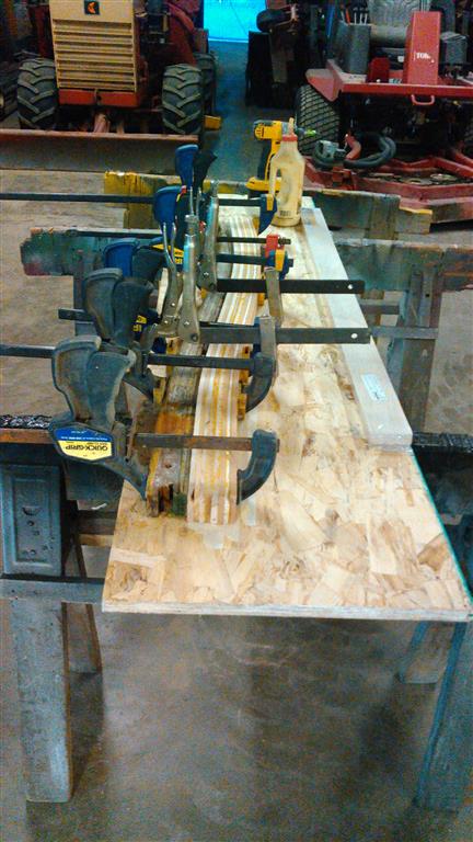

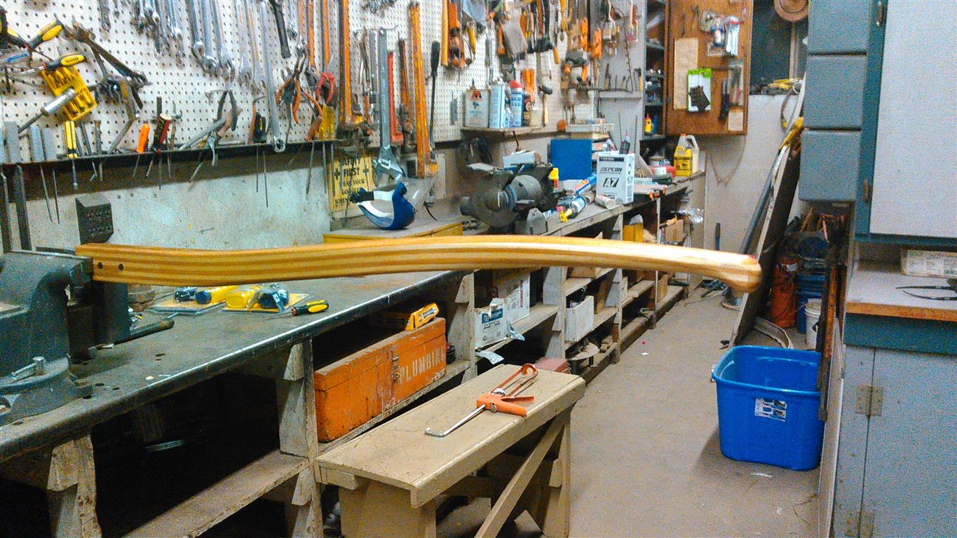

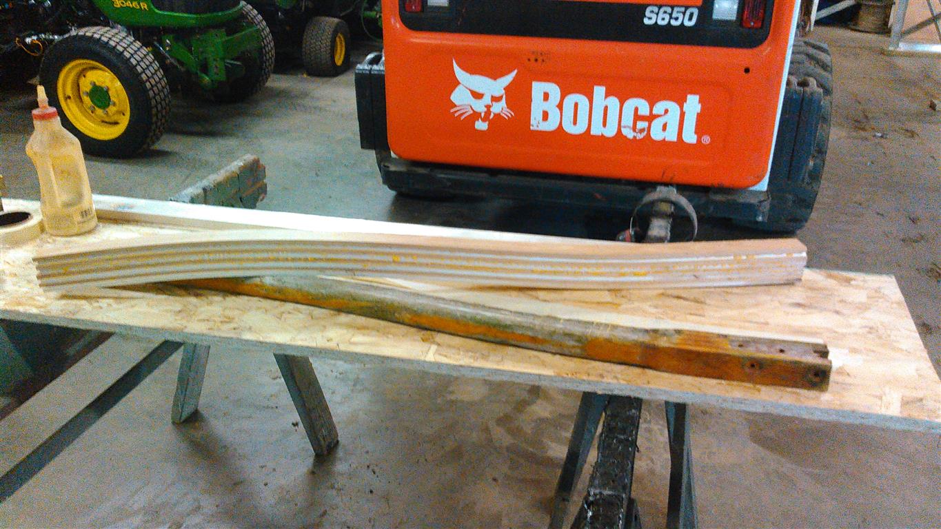

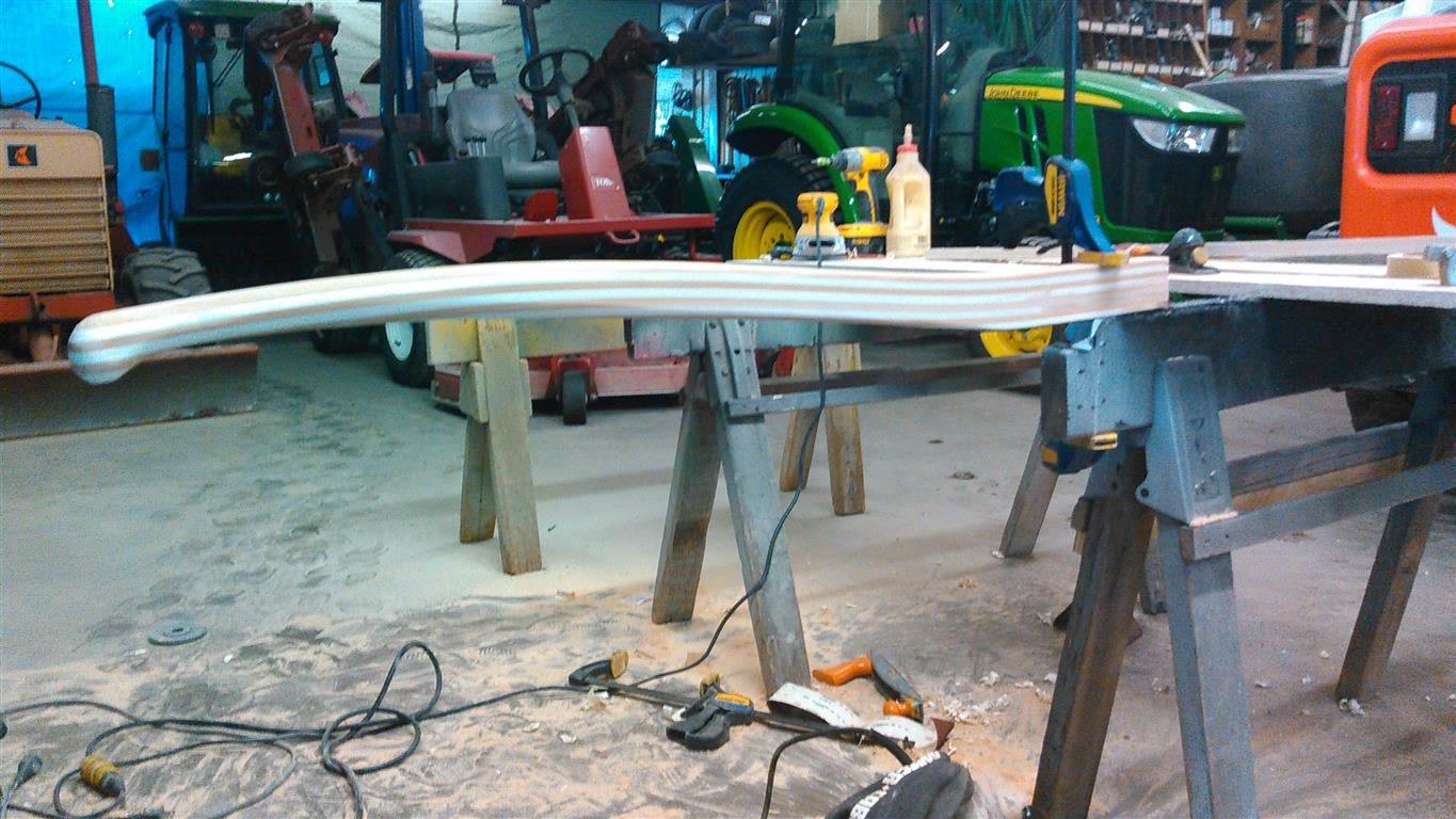

My new tiller. :clap: I wanted to make it from Hickory and Walnut but I could not find any walnut so I used Maple. My next one I will use Walnut and Ash if I can find it. Some major carving to go but I can do that during the week. The SS rudder plates are at the welder should be done. I should be able to finish up the rudder this weekend. I see on the rudder site that they do not use the large hole but only a small bolt hole. I think I might call them and find out if it is a better system.

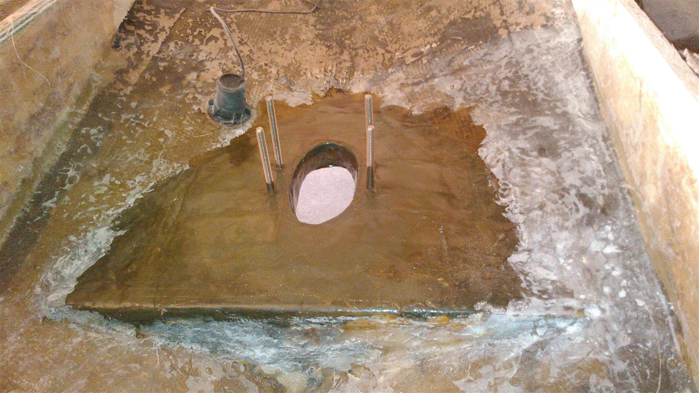

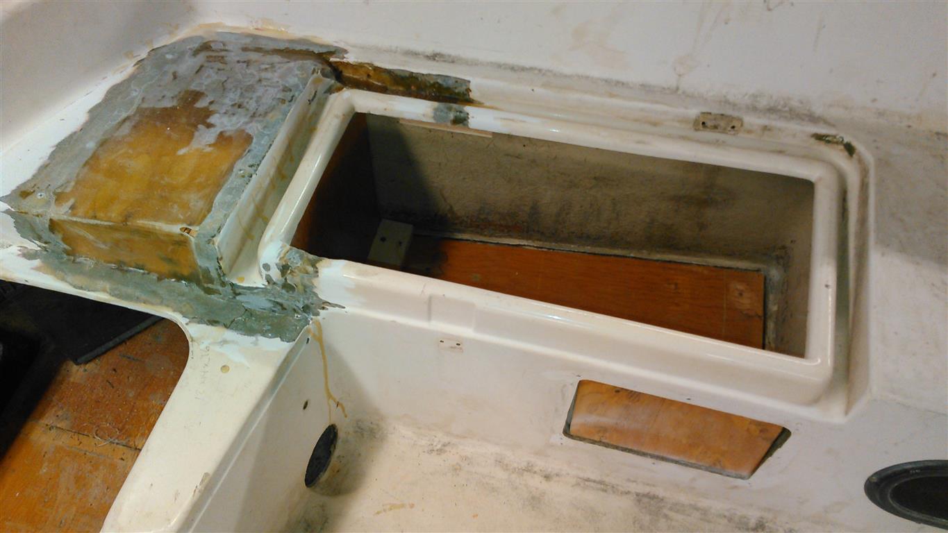

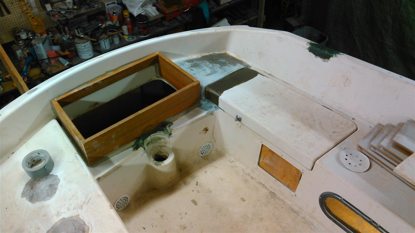

Another long weekend comes to a close. The rudder only needs three more coats. The generator locker turned out pretty nice very water tight and hopefully burglar proof. maybe one more weekend of fiberglass and I should be done. top to hull connection is mostly finished. I filled it with fiberglass so it is now water tight and very sturdy.

Well I have been working on an electric drive using an outboard lower unit. I have the bed for the unit mounting finished and will look fore some aluminum to finish the mount. Most of the interior is finished. The windows are done and we may get some rain so I will find out how good a job I did. Some of the new parts are in so I can arrange them on the bow.

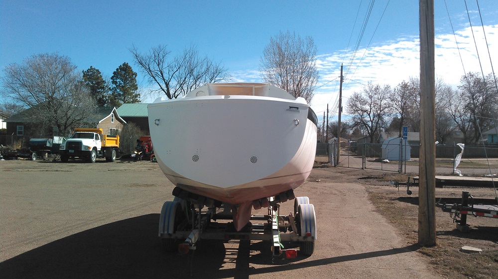

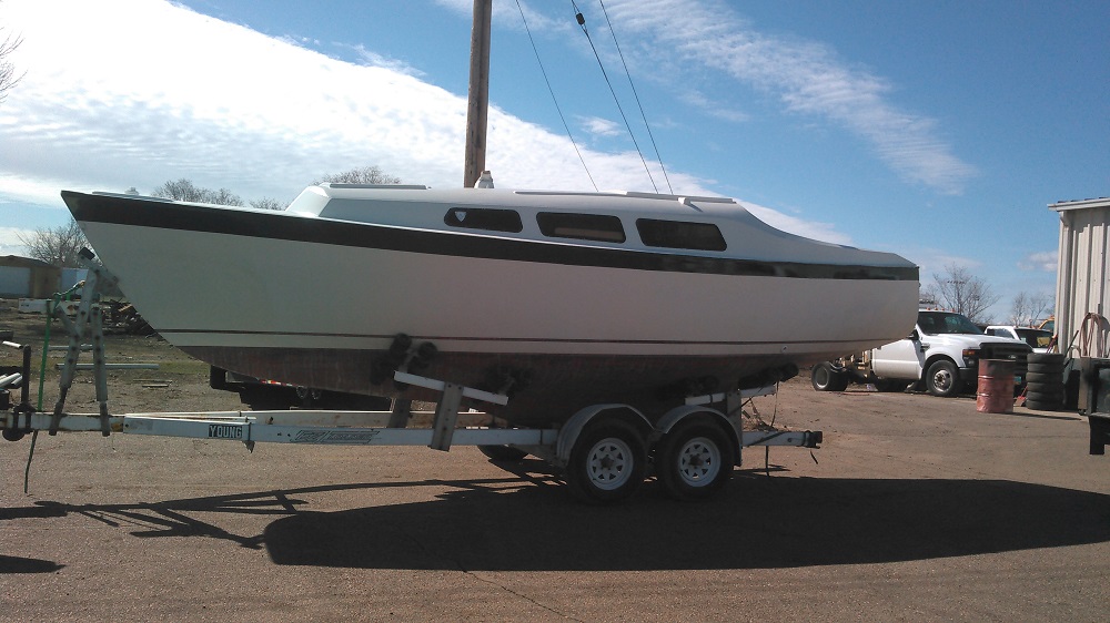

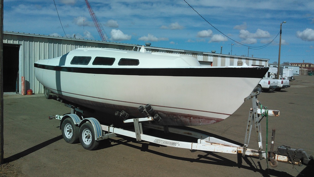

A lot has been done. Most of the painting is finished, I still have the non-skid areas to go. Starting to put it back together. I still have a maroon stripe to go below the black. I tried to match the color of the hull and that is as close as I could get it. I figured the Black stripe would break it up some. I also will get my lower unit installed by next week. I found a motor that is liquid cooled so I can just attach a line from the lower unit and I have cooling without all the radiator and pumps normally needed.

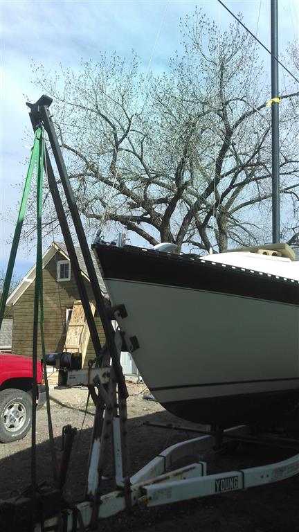

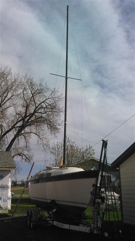

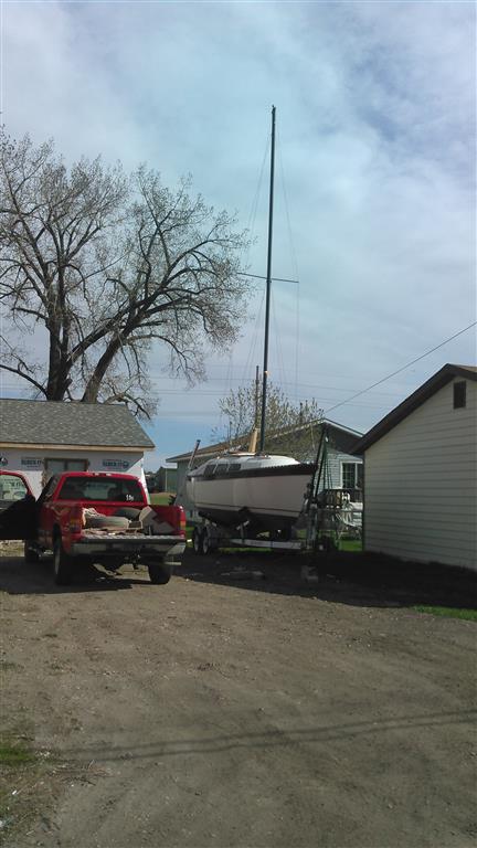

Not the scariest thing I have done but close! Basically because I have not done it before and had no idea if it would go up or over. In the end it went up just fine one handed, about as easy as it gets. next time I will have a couple of blocks and lines from the toe rail to the spinnaker attach so I can guide it a little better. The winch made it a snap. The rear mast support needs to be a little higher and attached to the boat for support. my plan was to just roll it out the rear support but it is over center so that was not working. Once I had the mas base in place though it was not bad after that. Now I am going to measure all rigging and order new, just not taking any chances at this point. I figured out that even though the turnbuckle is 3/8" you still have to order the swivel 5/16".

Could not tell what you were doing. Stepping the mast? Oh yeah. Meant to tell you I worked all day yesterday...I am as slow as Christmas. Just ask anyone who knows me, lol. Put on the new rails on top of cabin and covers for the slides on the companionway. And scrubbed two years of stuff off the topsides on m hands and knees most of today but sure looks better. Going to check out this product a clubmember recommended; Costacoat. Mop it on and it protects gelcoat like a clearcoat on automobiles.

Yep. It went well, but the stays had the wrong turnbuckles. I used the winch and it went right up. Since I did not do this before I had no idea if the stays were even the correct length

The winch goes up by the mast support then attaches by the Spinnaker eye. The yellow strap. I have a remote so I just hold the mast as it goes up.

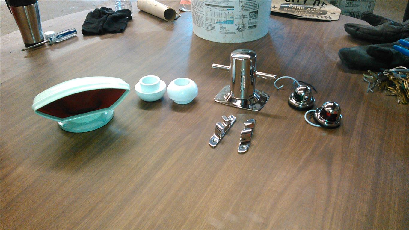

Just realized I am missing the blocks for the jib sheets. Carl do you have a photo of yours?

Hunters are different. My jibsheets are preattached at the clew of the jib so I can run one each along port and starboard side of my boat I have a block looks like on a spring on each side of the boat as well and it looks like I can adjust this to my needs depending on which size headsail I use. I do not have any other turning blocks or leads that I can remember and they terminate on the winches one on each side as well with self tailing device on the top of the winch. Since I have never had a boat this nice or this large, I am looking forward to using them. I have seen several different variations of this, though depending on the manufacturer. They all do the same thing, but have slight variations in how it is accomplished. Yours may have blocks attached to your clew and then the sheets, one port and one starboard lead from some point of attachment, then through the block, and from there, back to the cockpit. I am most familiar with this but not the Hunter. I am going up later today and will take a photo of mine if that will help.
