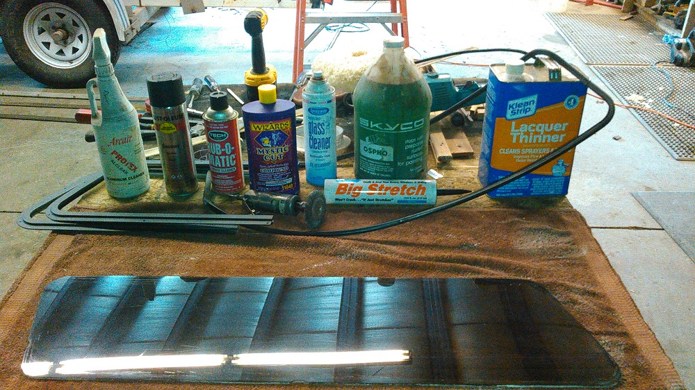

I refurbished one of the windows just to make sure they would be OK. I was figuring I had to replace them. What I really am trying to do is seal up all the leaks so I can wash it down.
First I stripped the aluminum frame with a non metallic wheel. Cleaned it with alumi prep (The two options are shown, one is just aluminum cleaner for welding aluminum. The other is Phosphoric acid.) Then I just painted it with flat black paint. For the rubber insert I used lacquer thinner and Rubber cleaner from the tire shop. for the glass which I thought was shot I used the swirl remover and it took almost everything out. Since the rubber was a little hard I used some sealant on the inside and outside (water based so I just cleaned the assembly up after. Turned out good and solid. When I install it for good I will use regular automotive butyl tape behind the frame. We used it for installing windows in cars. Still needs to be cleaned up but there is a big difference between the old and new. Hard to tell from a pic though.Window restoration.jpg Window finished.jpg

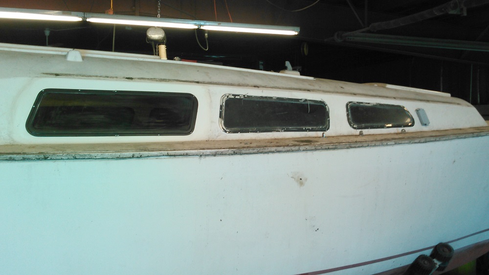

I was not aware you could still get something like that. Most likely it is leaking from the attach point to the boat though. Not a good design! There is no support behind the frame just a honeycomb paper. This really needs to be filled with epoxy all the way around. then attach the frame to that. General rule of thumb is when ever there is a hole it is filled with epoxy then drilled. This insures that if water does enter it does not get past the epoxy to the core. The window is a big hole, fill all the way around so if water does enter it cannot get to the core. It will just dribble into the boat and back out the bilge pump.
