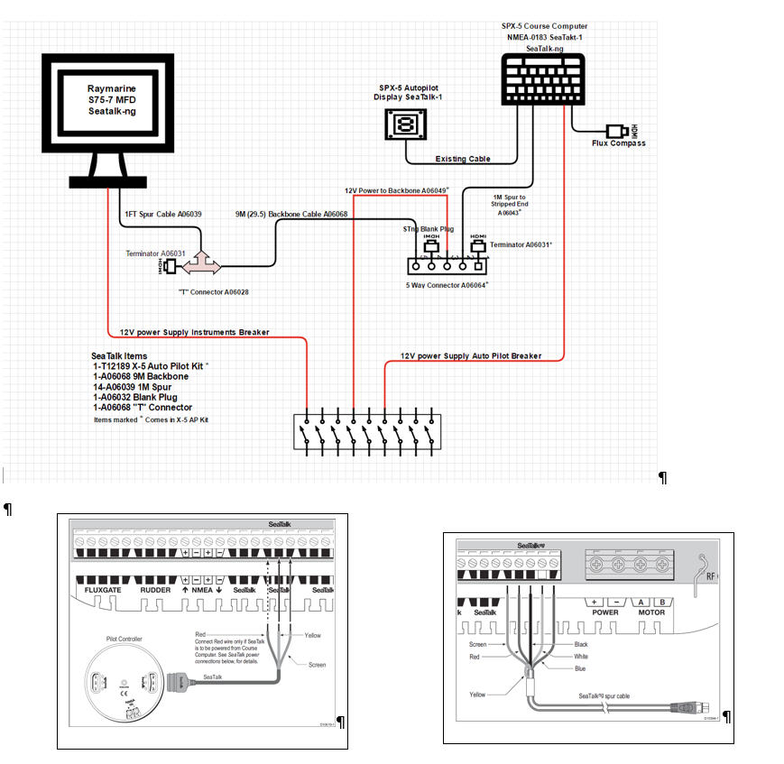

Having just installed a new e75 MFD and seatalkng backbone along with an X-5 autopilot seatalk kit (T12189) on my existing 2011 Autopilot as shown. The MFD shows the AP status as online (Green) and available, however when I am following a route the GPS data from the MFD is not coming through, as the AP display head doesn’t show XTE, BTW or DTW.
I installed the X5 AP as a spur from the 5 way connector supplied in the kit to the course computer’s Seatalkng connectors studs, the MFD is also installed on a spur cable from the backbone.
I was told that given that the AP had Seatalkng connections all would work well. Could it be that this connection is only one-way data transfer from the AP to MFD and not MFD to AP. Do I need to install a Seatalk to Seatalkng converter also, or could it be a firmware issue.

SeaTalkng / NMEA 2000 devices are each designed to be interfaced as spurs to a powered and properly terminated SeaTalkng backbone rather than as you have indicated. Additionally, Raymarine's X-Series autopilots are not designed to function as complete SeaTalk to SeaTalkng data bridging devices. Accordingly, it is recommended that the SeaTalk bus be disconnected from the X5 and that it instead be interfaced to a SeaTalk to SeaTalkng Converter(s) which will be installed as a backbone component within the backbone which will be installed. Please click here to view a FAQ addressing how to interface products having a SeaTalk interface to a SeaTalkng backbone, to which the Data Master MFD and SPX5 will also be interfaced. Following installation, it is recommended that the SPX5 and SeaTalk to SeaTalkng Converter each be updated with the latest available Raymarine product software updates.

In looking through seatalk.ng accessories I found that the “T12189” X-5 Autopilot Cable Kit which I installed is described sometimes as for use with a ST70 Control-Head, no mention of for use with ST6002 control head which is what I have, could this be the problem?
(Retail Discription:“Raymarine T12189 Cable Kit For X-5 Pilots to ST70 Control Head. Comprised of Two A06031, One A06043, One A06049, One A06064.”)
If not will post Diagnostics in a few days.
RE: X-5 AP to e75 MFD Data issue - Chuck - Raymarine - Moderator - 06-28-1703:29 PM
Genesis V,
As you have suggested, a powered and properly terminated SeaTalkng backbone should be installed onboard the vessel. This backbone will include a SeaTalk to SeaTalkng Converter which has been updated with the latest available Raymarine product software update. The MFD and X5 Course Computer will each be interfaced to a spur socket within the backbone using appropriate lengths of SeaTalkng Spur Cable. The ST6002 will be disconnected from the X5's SeaTalk port. The ST6002 will instead be interfaced to the yellow SeaTalk socket of the SeaTalk to SeaTalkng Converter.
UPDATE :Installing the Seatalk to Seatalkng converter solved the the data issue, if only the dealer had sold me the converter to begin with instead of a 5-way connector, we did discussed it for some time, he sold me origanal AutoPilot> Thanks Guys
