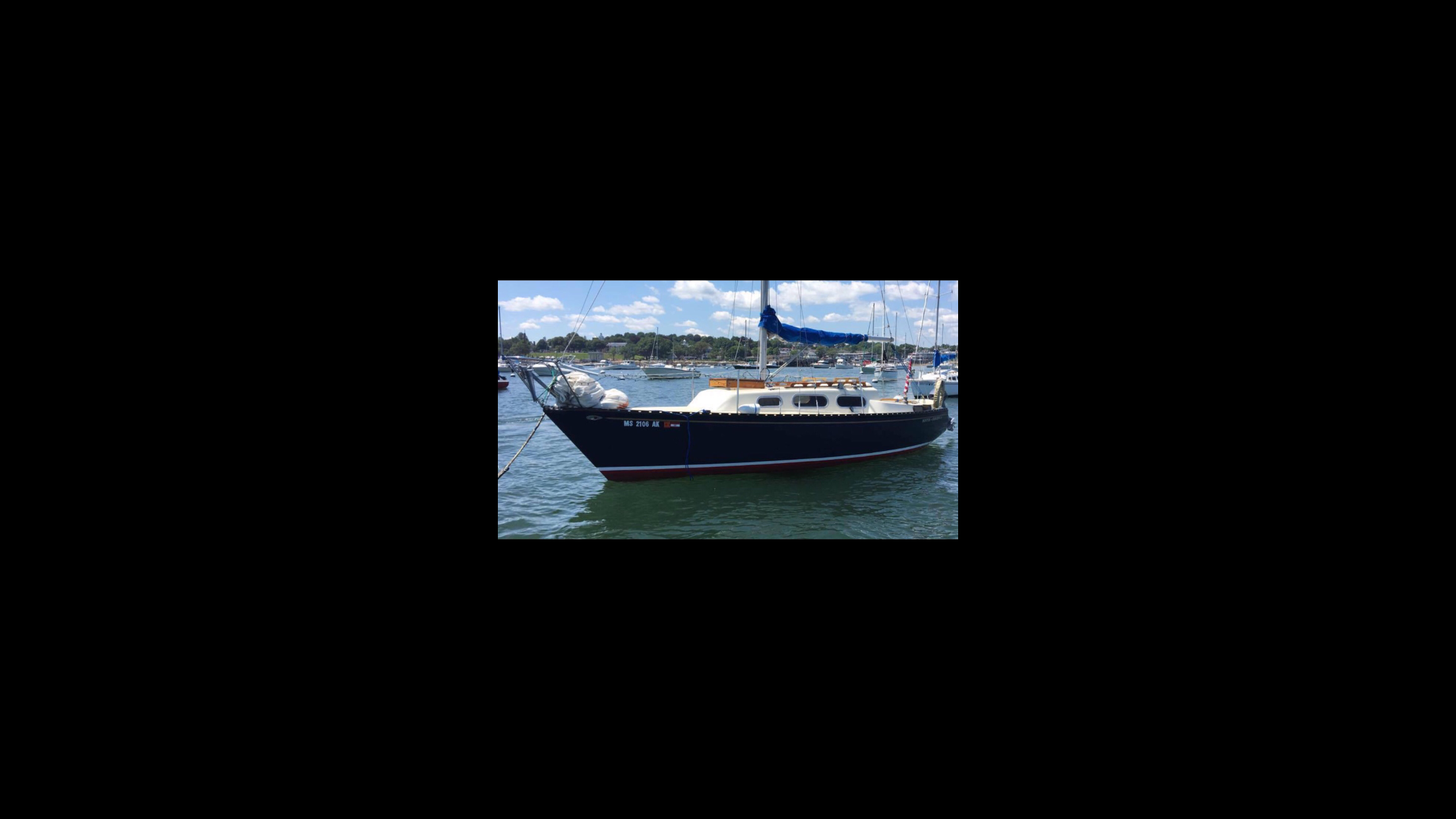

Thanks to everyone for your wisdom and advice. The rail was originally a brownish-black and was beatened up so I painted it black with rustoleum a few years back and it’s lasted quite a while. I’m always changing and improving the vessel as I need to keep her for a while longer due to a size restriction on my mooring that I waited 10 years for and my wallet (daughter in college $$$). I’m pretty handy so though my Hunter will never be a Morris, I keep trying to make her so (the design is a bit dated and I’m sure John Cherubini would change the looks!

She looks good.

She does look good, although with the dark blue hull, I think black or dull aluminum would better than "bright". I hadn't thought about Rustoleum, I might look into that after I dremel a few rough spots on mine.

Beautiful. I'm in favor of changing whatever makes you feel like changing if it improves your enjoyment and satisfaction with your boat. I believe sailors express their sense of art in their boats more than power boaters do. Your boat is your Magnum Opus, in a way.
Get it just right, but also, go sail. That's why you own her.
