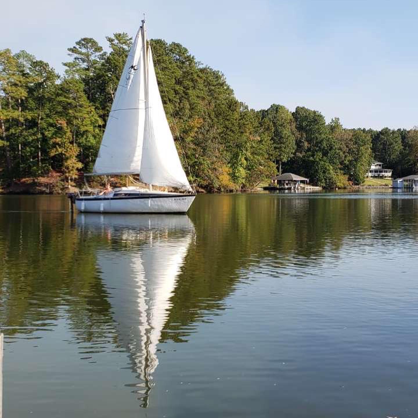

Hello i'm very new at sailing and everything involved with it so bare with me. I own a Merit 22 and im contemplating painting it a different color from white. Im considering painting it a light blue but im hoping that a current or past merit owner will answer me this. Is the black decretive lines, that run through the windows, decals or paint? will i be able to remove them? And one more question how in the world do i prevent water from getting in the bilge, it seems every couple days im pumping out 3 buckets of water from inside my boat its crazy, it seems like where the bilge pump is currently is having a hard time reaching the water, any suggestions?

The cove strip and the side of the cabin are likely gelcoat.
Painting a boat can be an expensive and time consuming process if done well. Slapping a coat of cheap enamel or God forbid housepaint on the boat will make the boat a mess that you will regret from day 2 and especially when you start to take it off.
Alexseal, at about $100 a quart is probably the easiest quality paint to use.

Yeah I painted the topsides of my SJ24 way back last millennia, but that's because the topsides had been painted previous and had gelcoat blisters. :yikes:
Just buff that thing out it'll look real nice in a Merit kind of way and then paint and burnish the bottom and foils and go fast!
Hi, and welcome. We almost bought a new M22 in 1983, but settled for a used Catalina 22. Nice and fast boats.
Here's how to shine your hull: Tips For A Great Buff & Wax
It's much a choice that YOU have to make, but if you do wax the hull properly, you won't ever regret not painting it.

First of all, don't paint it unless there's a problem with the gel coat. See the comment above on sprucing it up. And.... sorry to tell you this... Light blue is not a good color for topsides, although it works well for non skid areas. I've seen a few light blue hulls on boats and they just don't sparkle and shine. Red, a darker blue or even yellow will shine much better. How you deal with the striping is a personal choice, but you might want to talk to a marine paint expert. Finally. don't buy cheap paint.
8,023
The Ranger 23 "Blue Skies" came from the factory with a light blue deck with dark blue accents. The topsides were dark blue. It was a very good looking boat. It may have been the non skid areas that were light blue (Robin's egg.) Painting non skid is a PITA. Topsides is pretty easy but you have to do excellent prep.

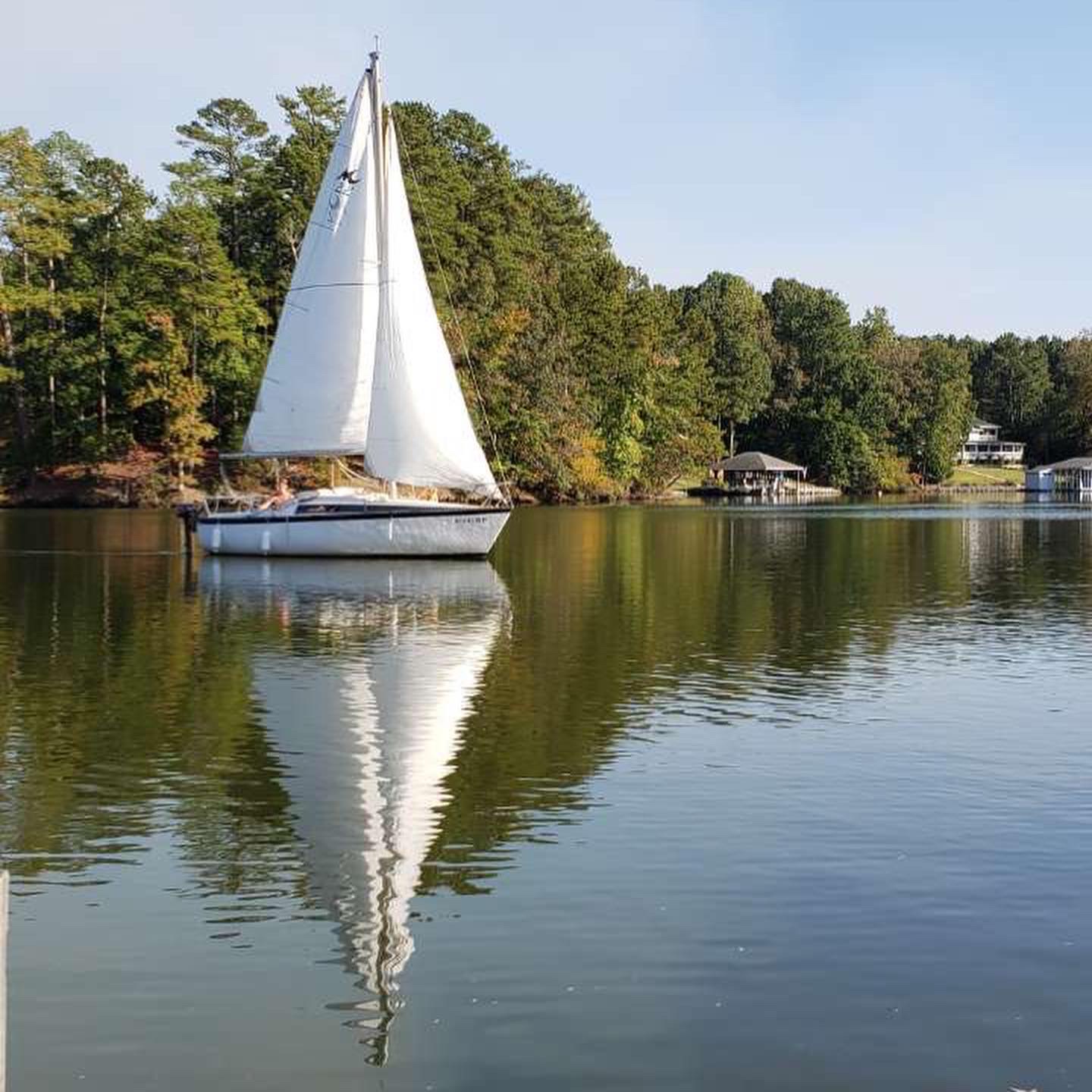

Thank you kindlyView attachment 191445
If you are getting water in your cockpit you might be getting water in the bilge through your cockpit drain if the hose is rotting or falling off. I had this problem after every time it rained or I washed the boat. I bought a 2 inch radiator hose at the auto parts store that had a 90 degree bend molded in it. Installing it is another of life's little joys.
The only other place for water entry I can think of is a through hull fitting. The Merit 22 has no through hulls except for a depth finder or knot meter, if some one installed them. Where is your bilge pump? My boat is totally foam filled except for the space under the port side seat aft of the table.
