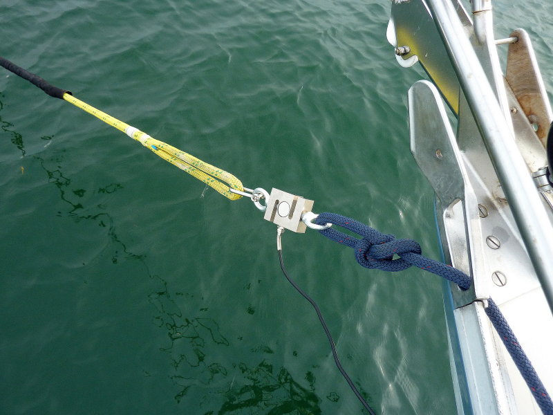

I've done extensive testing using a 5000 pound digital strain gauge on my own boat. I've tested all my anchors, my boat in a number of storms and even how much just the chain can hold. What I found is that the ABYC guidelines, while a bit conservative, are pretty darn close.
What you will find is:
  • Loads are never static. They fluctuate from 0.00 pounds to a spike then back down as rode stretches & relaxes.
  • Shock loads in waves will give you the highest peak numbers. The peaks don't last very long but do induce high loads and heat from chafe.
  • If you use all chain you will see very high shock loads during chop & waves some times exceeding 10X the average
  • If you use a long snubber you will see much less shock loading.
  • The strain gauge must be before the chock or the readings will be incorrect.

Practical Sailor has published several articles on just this topic, discussing chain, rope, and the use of snubbers. I've spent many hours reading strain gauges. The difficult part is not the measuring, but determining the effects of scope, rode type, water depth, and waves.
I would not tie loops, I would use either a rope grab or gripper hitches. A small tackle is handy for getting the load onto the gauge (you really don't want it in-line in strong winds--you want to be able to retreat!).
If the spikes are 10x the average, there is a problem with the anchor system design. A snubber is badly needed, as you suggested. I seldom see spikes over ~ 200% of the average, though perhaps 4-5 times the minimum.

A simple way to get rough numbers, if you are curious, would be to attach a skinny nylon line (1/4"?) of known stretch with a camel hitch, pre-stretch a few times, place 2 marks 2' apart, transfer the load, and measure the stretch. You'll get within 20%

If I take ten accurate measurements on ten different days near the same spot in say 14-16 kt of wind each time and get a measured average load 15% lower than the design load offered in Stu's table at 15 kt--there's no issue. The number in the table tells me for a sail boat of the size I own what loads my ground tackle should be capable of handling (in their opinion) at a given wind speed; the numerical average of my ten reads tells me what loads the boat actually experiences in 15 kt. There's no right or wrong here. If I ignore the table and end up on the beach b/c I chose tackle too light for my anchoring jobs, then--it's my ass! I think I understand all of this much better now.
And by the way, I do carry three sets of ground tackle with three different anchor types. However, considering some of the discussion I've followed in this forum, I'm considering exchanging one type I'm carrying now for a Rochna.

Have you thought about using trigonometry? Draw a free body diagram with the chain as a bent line and a force applied at right angles to where the bend occurs. calculate what the angle would be for a given load in the chain and a constant and repeatable force applied to the chain at a right angle. Alternately you could calculate the force in the chain given a fixed angle of bend and a known applied force causing the bend. you can make a table of angles and/or applide forces for given chain loads and check under actual conditions.
Or you could use MS's "bar tight" assessment
example: if the bend you can make in the rode is 120 degrees measured angle from rode to rode on the opposite side the force is applied to and the force applied is 10 lb then the tension in the rode would be 10 lb also.
summing forces perpendicular to the line of the rode with the applide force being the positive direction
Fa=Fr*cos(60)+Fr*cos(60)=2*Fr*cos(60). Solving for the Force in the rode (Fr) gets
Fr=Fa/(2*cos(60))=10/(2*0.5)=10/1=10
You can use the formula for various applied forces (Fa) and angles where the angle is 1/2 of the rode to rode angle as described above.
a more realistic example:
I can apply 25 lb to the rode and get a rode to rode angle of 175 degrees
Fr=25/(2*cos(175/2))=25/(2*.0436)= 287 lb

I'm thinking a simple angle measuring device (protractor) and a calibrated hand and arm. Lean over the bow and attach the not so expensive angle measuring device to the rode (or do this right after you anchor) and then use your calibrated hand and arm to apply a known force perpendicular to the rode. measure the angle through a couple of surges and retire to the salon to consult with your calculator. Probably want to practice on the hard to get your hand and arm calibration or use a spring scale if you want to go the more expensive route.
Keep in mind that was based on "all chain" no snubber as many a lax sailor will do when they assume fair weather. I never do this and only did it to see the results. In flat water you'd not see this but I anchored our boat in a fairly exposed anchorage with a fair swell and chop n top of that and did capture a spike at about 10X what it was averaging. Based on my testing I went back to a mixed rode as it greatly reduced the spikes..
Bingo. I did that test as well and got exactly the same answer you did; good agreement with ABYC tables. I actually busted a 2500-pound load cell in 10 knots when a wake caught me by surprise in 6 feet of water and straighten the chain. Wham. Fortunately the load was on a Dyneema bridle and not over the roller. The average load was only running ~ 25 pounds at the time.
And that is how you bust chain and ruin bow rollers.
