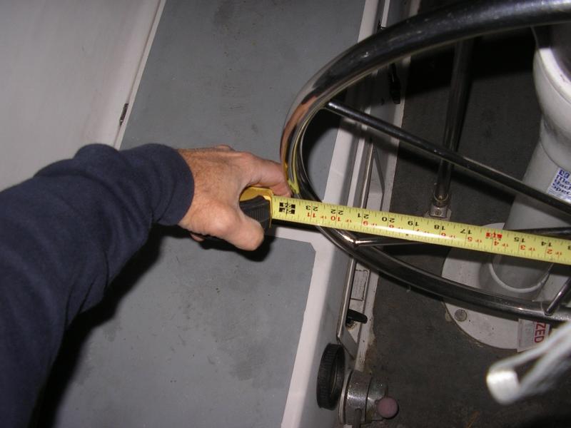

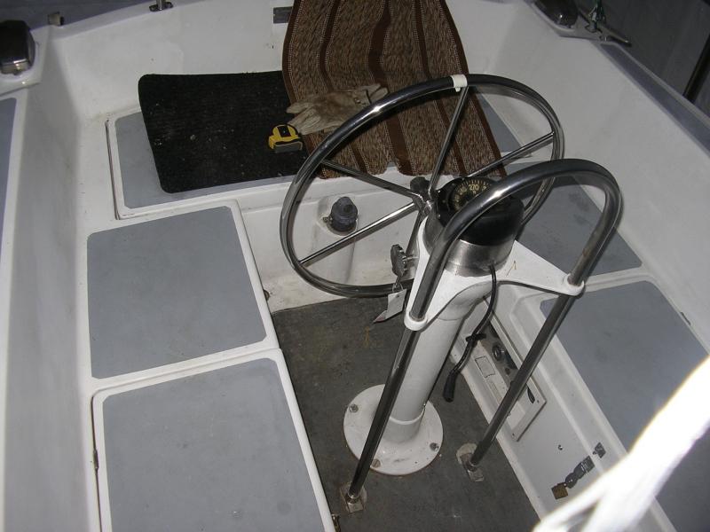

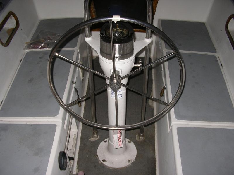

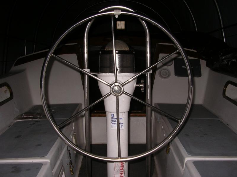

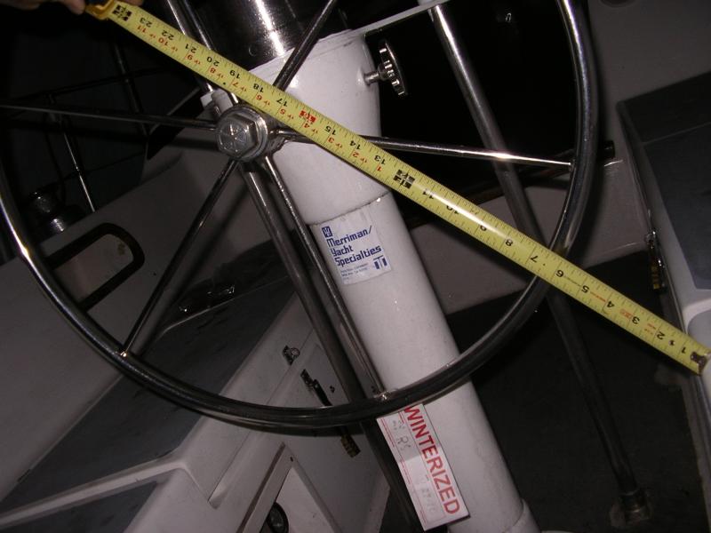

Sorry about the delay, single numbers this morning. Mine is 24 inches and 6 inches to the cockpit seat. Here's some pics.

Thank you All U Get
Pics help a lot just like mine
It looks like I could install a 34in wheel
