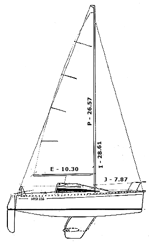

I have a boat with no sail rigging at all. Found a very good deal on a mast that is the same length as the original. The boom is longer, by about 3' or so. Probably because the boat it was designed for was 4' longer than mine.
Is it reasonable to think I could cut the boom down and make it fit? I think I have the original boom so maybe it could be used? Not sure how much of this stuff is generic. Is it at least reasonable to assume I could adapt this mast to my boat? Totally new to sailing and starting with a fix it up boat. $$ always important.
added info:
I have the orginal specs on the boat. I 28.6' , J 7.8, P 26.3, and E is 10.3
The boat was recovered from flood damage and was rolled over on its mast. I have the sails which are well used and will have to be replaced as well. I have "a" boom but not sure it is the original so I might be wrong about the comparison made above. Seems a lot of stuff got mixed up in the yard during clean up. The mast I found says it is almost new. Mast, spreaders, boom, haylards and stays.
Mast is 28' tall, 5" by 3 and 3/4 with a 12' 6 boom. Not sure again how well this stuff swaps around. I would like to keep the boat as close to original as possible but a new rig with all the gear was over $5000 from US Spar. This one is $1700 and same brand. I have only been looking for a few days and this is probably not the only deal that will come along but does look like a good match for a reasonable price. I appreciate the feedback. I have already learned a lot and realize I have a ways to go as well.

I really can't think of a reason why you couldn't shorten the boom. remove the endcap cut the spar then put the cap back on. Assuming that there is no taper to the boom.

Gary is right about the boom but before you start on this road here are other items of importance. You mentioned that cost is a factor which brings about these items. What do you have for standing rigging? What do you have for sails? etc. The foot of the sail is important for boom length. Mast heigth and whether it is a fractional or masthead rig has bearing on your choice. Standing rigging with the required wire and end fittings and deck hardware can be very expensive so if you have good rigging you might want to be able to use this.
If you have sails then your rig plans must be around the type of rig they require. Additionally, if the boat is a popular model or carries a good resale value then you might think about restoring it to the original rig to be able to recover the money invested.
Now my thought is......if you have very little tied up so far, and the new mast is a sweet deal and will make her a hot-rod, then make her a true HOT-ROD. In my old life there was no substitute for cubic inches. Now the holy grail is measured in square feet of canvas.

The boom just has the clear the back stay when the sail is set. there is no law stating the length of the boom.

Do not bastardize this boat! Restore to manufacturer specs. This boat is a popular racing boat...yours might have been used as a donor.... thus the lack of spars and rigging. Get a copy, or picture, of the sailplan with spar and rig dimensions. Follow it. Since you know nothing about sailing and sailboats.... start studying.... explore sailmaker websites...peruse anything you can find. try googling "beneteau 235". Here's a start: http://www.beneteau235.com

Changing the sail plan is ultra-tricky because it will change the balance of the boat. Generally speaking since there are many other factors involved: A taller mast will add weather helm when heeled over. A longer main sail foot will probably add weather helm all the time. The OP's possible changes could open a big can of worms, not just boat trim but rig stress and safety.
Could anyone less than a Naval Architect do this safely - rig stress - and maintain rig balance?
Changing the boom seems safe if of adequate section, length and wall thickness. The other stuff requires a lot of engineering study.

Will restoring the boat to factory specs prevent you from sailing due to cost? If so, bastardize to your hearts content. Come as close to the standard lengths and heights as you can. If you change overall dimensions you may adversely affect the handling characteristics. Not a good thing. But if you're shallow in the pockets as some of us are, and a slightly longer boom is all that stands in your way, SawzAll do your stuff! Just take your time and do it right. Make it pretty. And sail your ascot off!

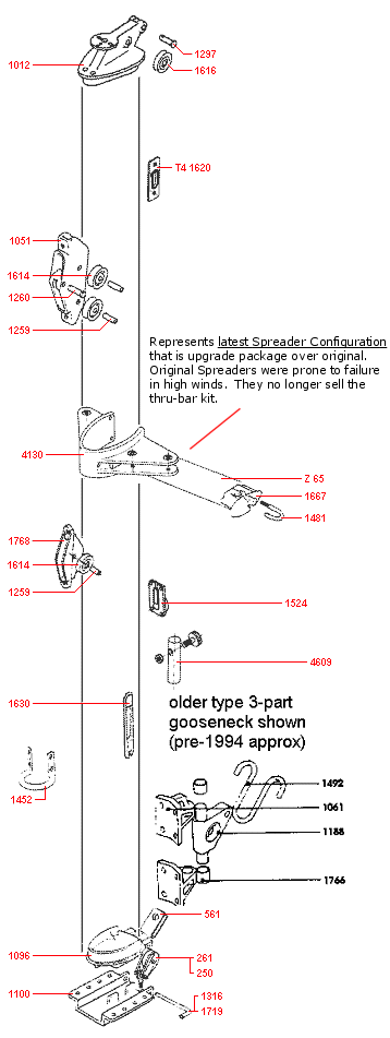

Say what???? You don't need to join anything to access what is there... and there's a lot. You could also call Beneteau... they still make this boat. Here's a very small sample of the info I found on this very, very excellent site. www.beneteau234.com from the "info index" drop down menu.
http://www.beneteau235.com/tech/Beneteau_First_235_Owners_Manual.pdf
http://beneteau235.com/beneteau_f235_standing_rigging.htm
http://beneteau235.com/f235_running_rigging.htm
http://www.beneteau235.com/line_drawings.htm
http://www.beneteau235.com/f235_deck_fittings.htm
http://www.beneteau235.com/f235_sail_plan.htm
http://www.beneteau235.com/f235_factory_parts.htm
Here's the mast......parts available from Beneteau factory.
