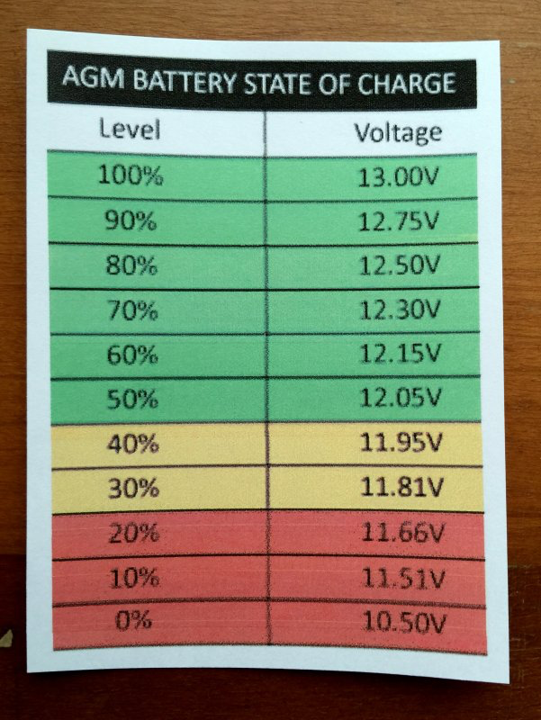

24,830
-House bank voltage steady at 12.3v and SOC at 96%
-12.2v read at the inverter lugs
The symptoms also suggest that the health of the battery bank may not be what you think.
Before opening my wallet for a new inverter (as fun as that may seem) I would look hard at the battery bank and do a 20 Amp Hour capacity test of the system.
Here is a link Under-Load Battery Voltage vs. SoC - Marine How To
and a chart image... Though the chart is more of an indicator that your batteries may be on borrowed time.
