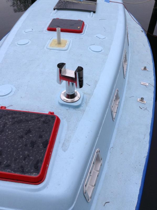

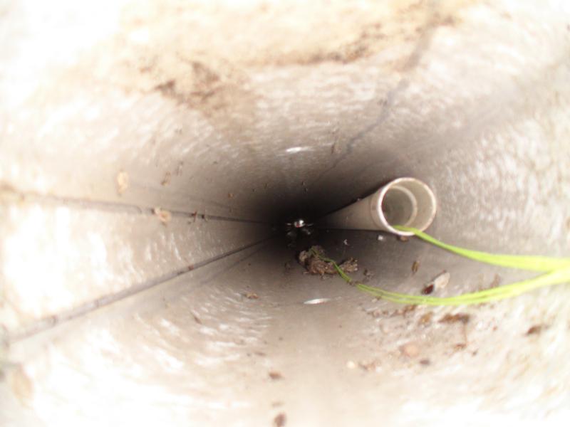

agreed that it is almost impossible to fish a wire all the way through, After removing the mast step i found that someone had been to lazy to get the appropriate bit and went crazy with a 1/4" bit creating a jagged star shaped hole that the wires barely fit through. If you do pull the stick i would recommend going the "full monty" and doing the job right. These pictures aren't the best angles (from other projects) but you can kinda see what i am talking about. The first shows the plywood core cut out under the mast step, the second shows that area filled with solid epoxy/mat layup. the center of that area was drilled out and a pvc pipe was epoxied into placed creating a real conduit for wire to pass through in the future. the pipe will be left about 4" 'proud' to prevent water intrusion. The mast step had to have the center hole widened slightly to allow the pipe to rest inside. I also cut an access hole about 1.5" x 6" in the starboard side of the mast and will make an access cover for it.
If you pull the stick, i would think it would be silly not to go the extra effort to remove the plywood core and strengthen the area. But I also know people who shop in the bath isle at home depot because "boat caulk cost to much" so i guess its the old adage 'to each their own....'
