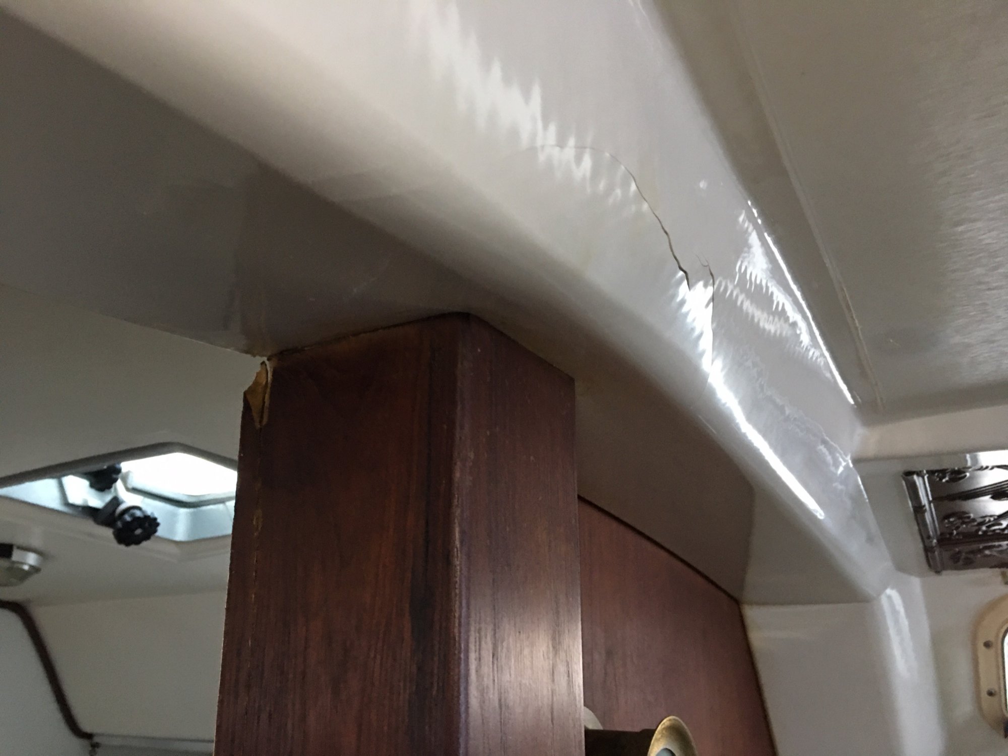

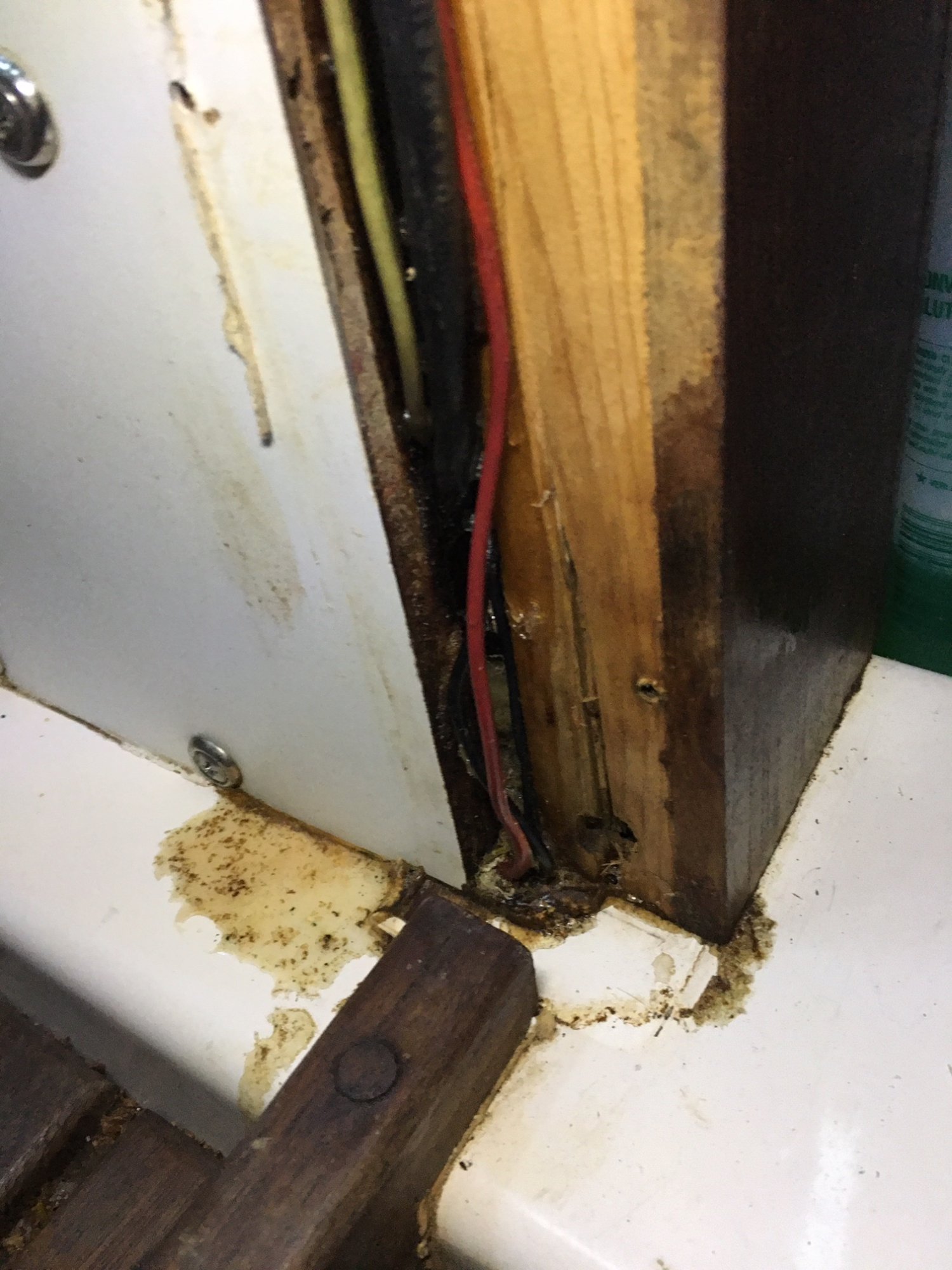

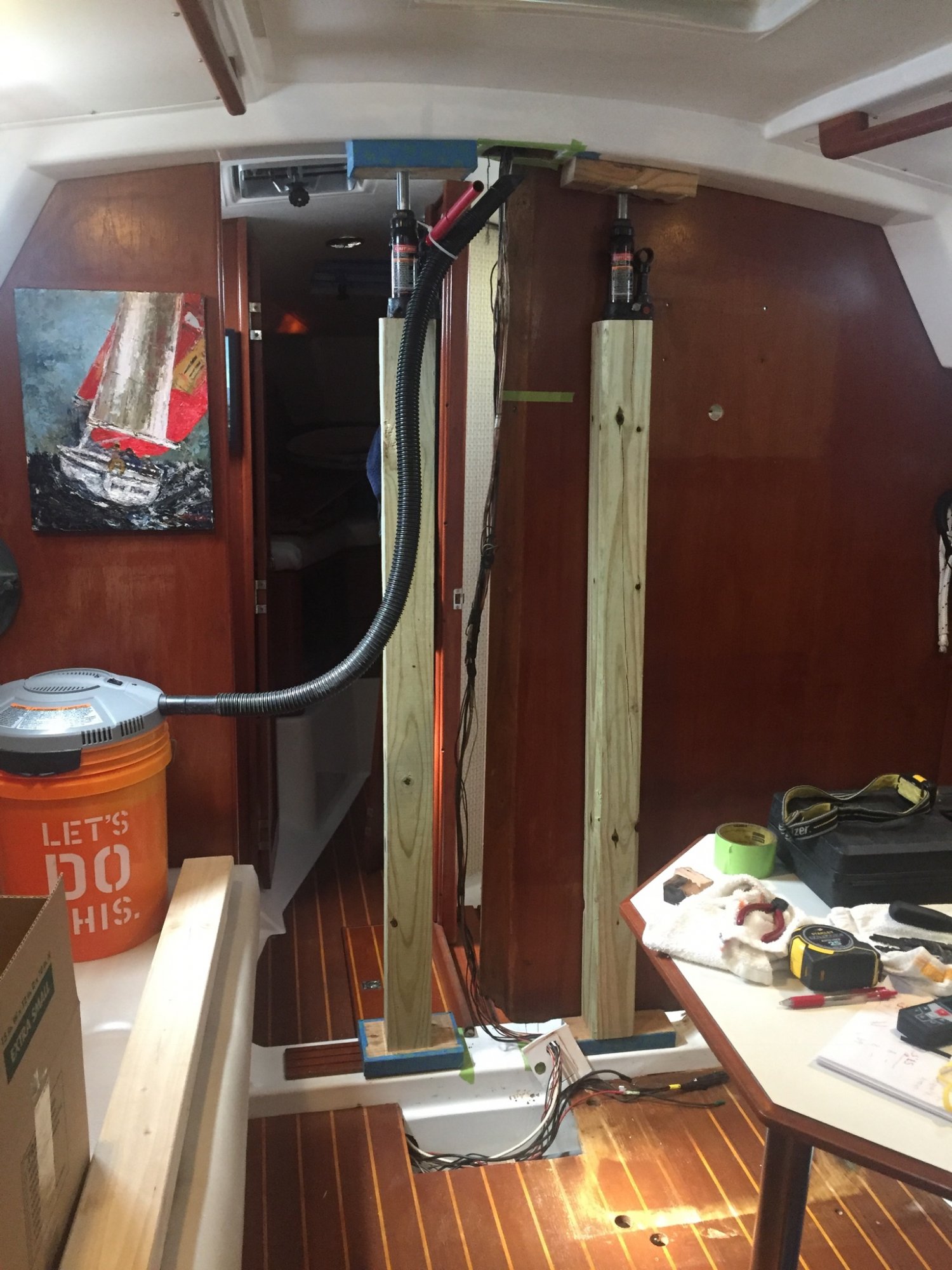

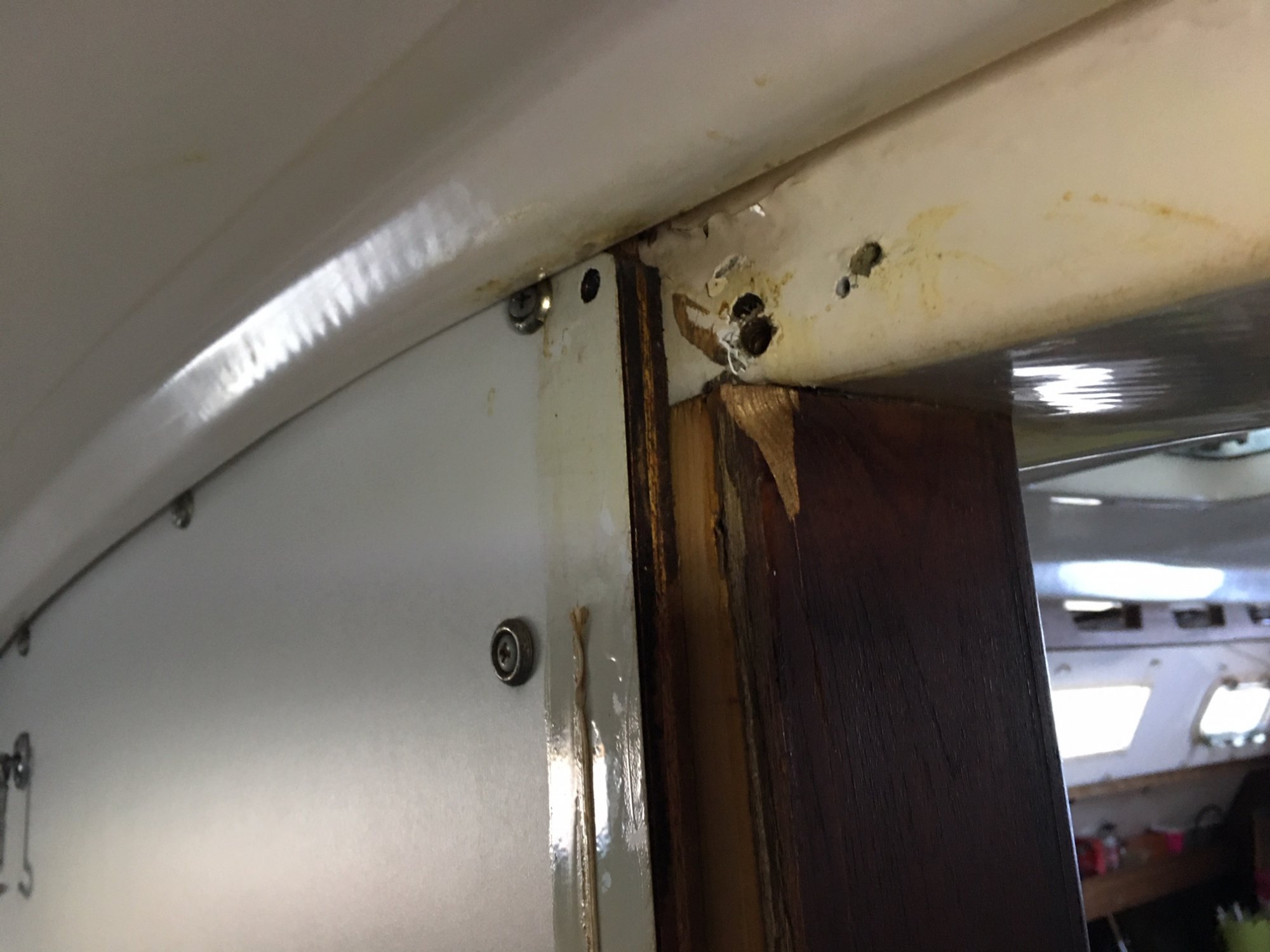

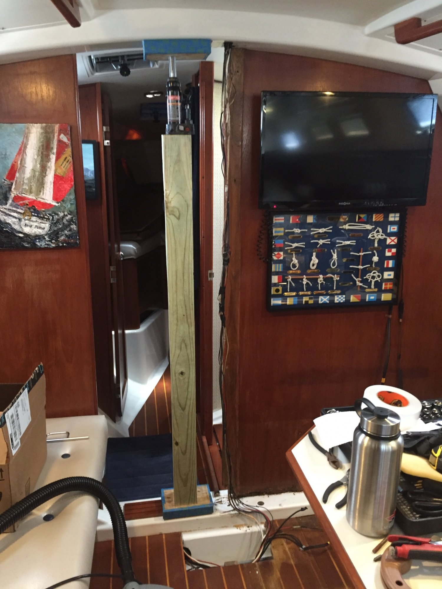

A few pics of the start of the compression post fix. Good news - no rot detected so far. Going to lift the roof this week and brace with lally columns while I figure out the repair.

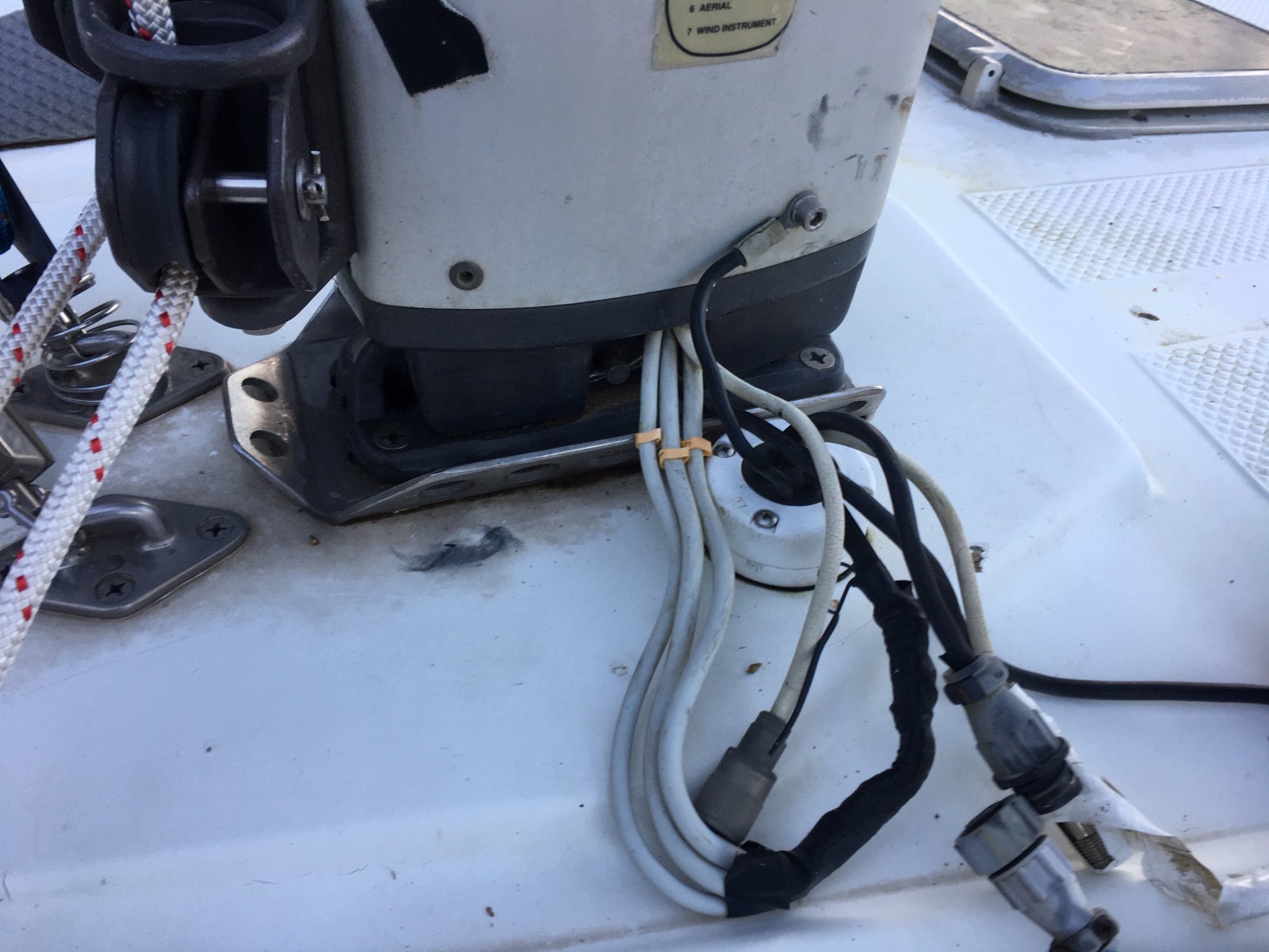

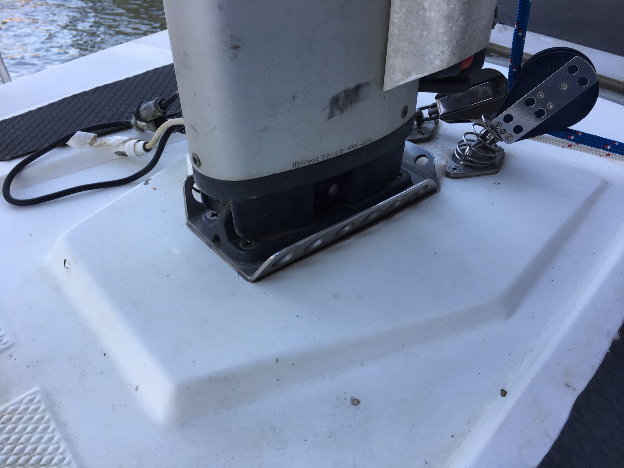

Another quick question - I'm thinking about going wire-free for the brace install, other than the grounding wire. Reason is I was looking at the Garmin GNX Wireless Sail Pack 43. Anybody have any thoughts on the wireless solution? Mast is 45ft high and published reception on the Garmin is 50ft. So, right on the edge.

I did the same fix on my H34. Removed the mast a reworked the sheaves and rigging attachments at top.
u could definitely keep the mast in place. Just be sure to loosen all 6 of the shrouds. I used 2 of these braces. Forgot to take picture with both...
I screwed the jack to the 4x4.
while jacking, always keep an eye on your shroud tension.
on wiring: u still need a VHF; Steaming; Deck and Anchor light... I rewired all of that with the mast off...

I used two bottle jacks and 2x4 cribbing and columns. Most challenging is dispersing the weight in the floor and getting as close to the bilge as possible. Remember to loosen the rig first

I have an ‘83 H31 with a 47’ mast. I tried the wireless Garmin wind product for about 9 months. Worked well for first few months, then started working intermittently. I spent about six months with Garmin support and literally replaced every component one part at a time trying to see where the problem was. Never got it fixed, I quit on it, returned the wireless unit and installed the wired unit. Never a problem with it since.
Mar 20, 2011
624
Hunter 31_83-87 New Orleans
Agree with HMT2 on wireless. I have the G Wind 2 wireless. my H31 is at the upper end of their stated range and I live with intermittent signal.
