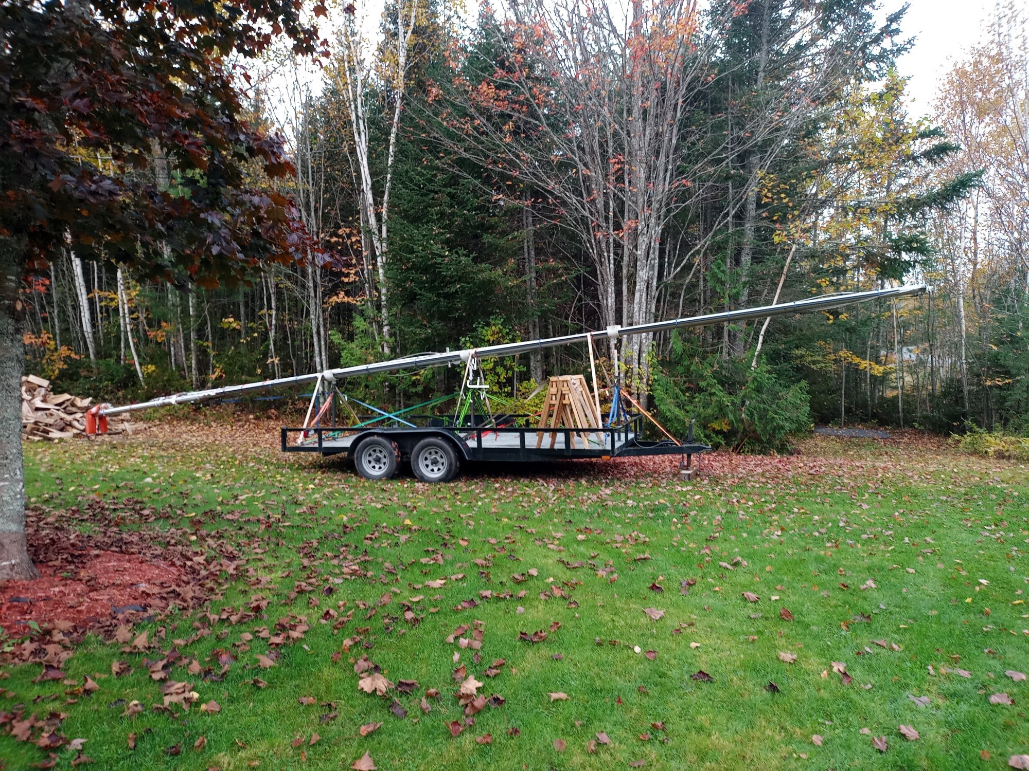

Hello, I currently remove my mast every Fall and install every Spring. I would like to make a proper mast trailer to be able to take the mast home for safe storage. For the time being I rigged some diy stands that are bolted onto my 16 foot utility trailer. This is definitely not idea and the osculation of the ends of the mast concern me. I was wondering if anyone has made a mast trailer that they could share some insight and photos, I would really appreciate it. Cheers

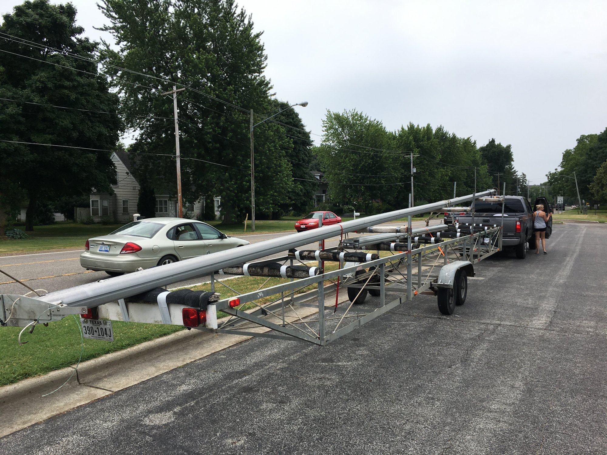

i sold a 52' mast and they brought it back to texas on a mast trailer, thought i had a picture. ill look

That is what I'm doing now, I use a 16 foot utility trailer with the mast positioned over the truck. I have attached a photo of my current setup.

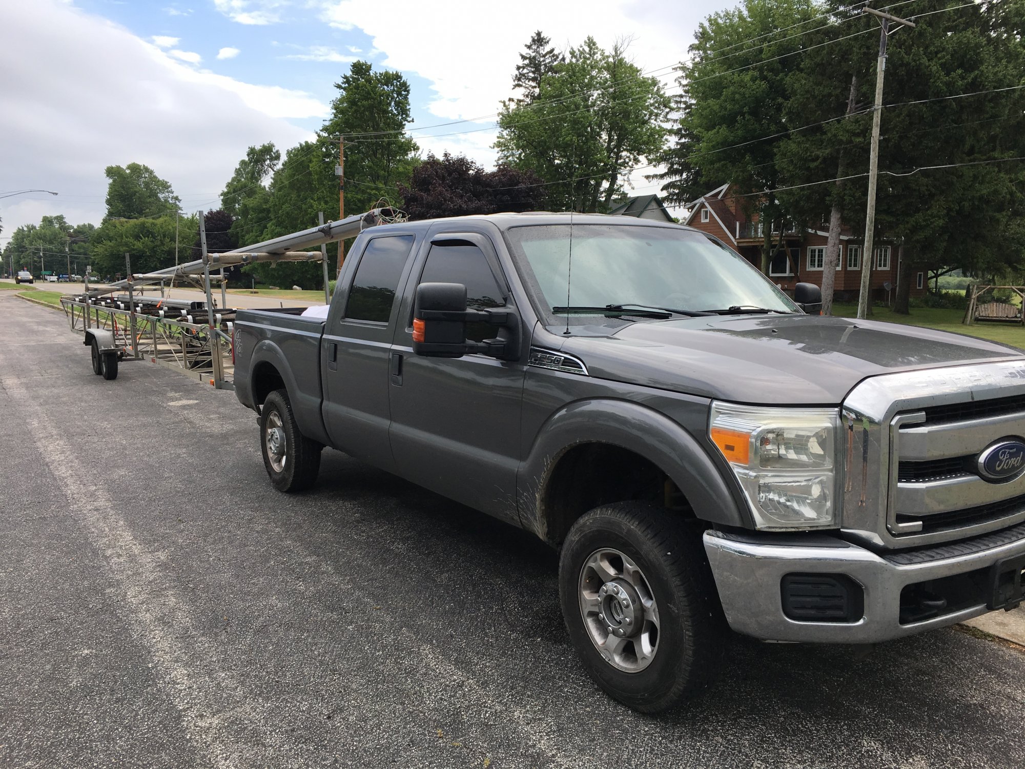

Most states have laws pertaining to overhang from the backend of a trailer with red flags and/ or lights attached. Otherwise you could be ticketed. The standard overhang is generally six feet
If the mast overhangs like on the short trailer pictured above, when turning, the overhang extends out striking other vehicles in their lane of travel. In fact, it is dangerous when the mast angled upward damaging masts, other vehicles, injuries and so on. I have seen this as a sailboat dealer and former investigator.
So if trailering a mast, be cautious. The mast being transported on the long trailer by @Project_Mayhemn is a good example of transporting properly.

thanks dave,
just to be clear, i dont recommend this from my pictures, not my area of expertise.
this is just what the guy who bough my mast used to pick it up in michigan and bring it to houston. he bought a hurricane boat with no mast.
