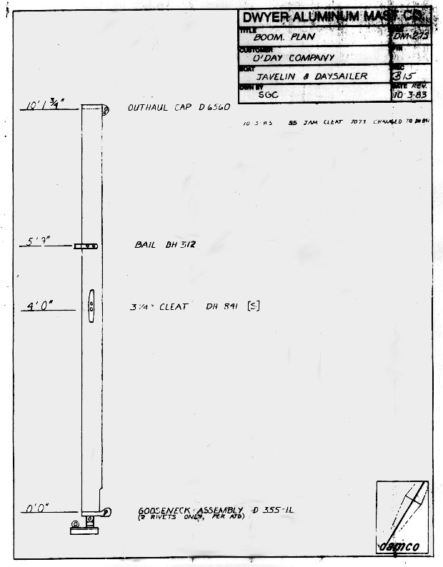

The mast measurement from the estimate:
DM 284 (2 7/8 x 2 1/8 ) 23’ section
17 x 23
The boom measurement from the estimate:
DM 275 Boom 11’ section
Here is the rest of the items in the estimate:
DH 1012 masthead
DH 70 tang (3)
DH 2112 HP step and hinge
Gate (milled out)
Dh 2510 spreader ½” x 24”
Spreader bracket
Halyard cleat (3)
Halyard block & Eye strap
¼” halyard main (46’ )
¼” halyard jib (30”)
Shrouds, upper (2) forestay (1)
DH 355-1L Gooseneck slide and end cap
DH 6560 End cap
Dh 312 bail (3)
Outhaul cleat
Misc fasteners, #10 MS, 3/16” rivets
