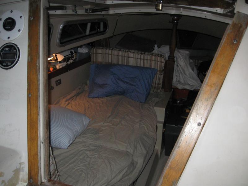

Gregg, durn if I wouldn't make one. If you knew one of these old time wood guys, with a wood turning lathe, I'd turn it out of oak. All this junk about hard woods not holding up, well........whatever. A weekend boat. On the interior? I could seal up cardboard with the right stuff. You pick the "stuff", there's many of them. And the structural integrity of hardwoods is unquestionable.
I've even looked at stair rail/banister posts with that thought on my mind. I don't know..

I was in Home Depot yesterday and saw solid oak banister posts for $41. It looked to me that you could simply cut off part of the top and bottom of that post and it would serve the same purpose. I thought of this also. Almost seems too simple!

Seriously though, I bet you could use one of those oak bannister posts with a dark varathane and no one could tell the difference. For $40 bucks it seems a no brainer, especially if your post is cracked and or damaged from rusted lag bolts.

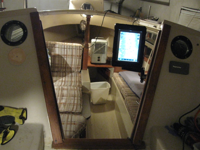

For what it's worth, when I end up using a lighter colored wood, like oak, I've found Minwax stain, #224, -Special Walnut-, to most closely resemble that dark teak look, and then 3 or 4 coats of Helmsman Spar Urethane over that. The stain is about 5 bucks for a small can, and as thin as it is, goes a long way. Debating wood treatments to me seem like the days when old men would sit around and argue motor oils. When my neighbor here on the hill used one of the coatings that I see much ballyhooed on this site and others, he put it on his Cheoy Lee last year, let it winter, and this year it looks like it's never been touched with anything, and he's having to do it all over again before he can splash. My boat that's done with Helmsmans looks like I just finished it. And he's putting the same crap back on his boat, while paying the hill bill working on it. Go figure.
The thing is, is other people have probably had different experiences with both, I just know what works for me.
Have you ever noticed, some bloke with a lady, you think she looks like a scarecrow, and can't help but wonder what he sees in her? He however thinks she's beautiful. "Nuff said on that.
IF......I had access to a tig rig, I'd probably rebuild the post out of 2" or 3" schedule 40, 317 grade stainless pipe. When archeologist discover it ten thousand years from now, they'll be trying to figure out what it was...

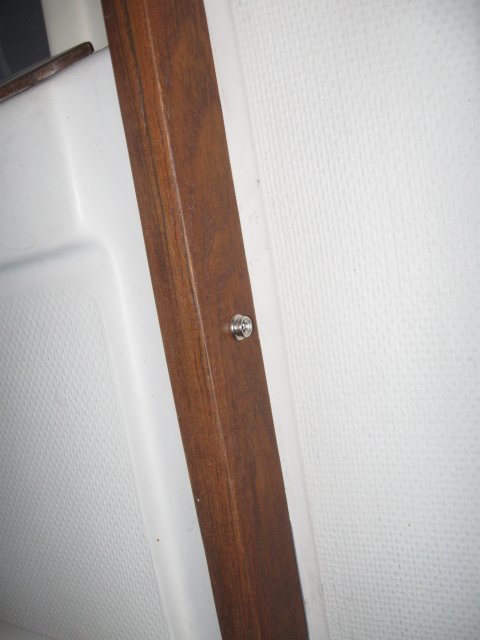

I'm trying a product called "Flood" that's made for decks and fences. It's got a 5yr UV warranty on fences and 3yrs on decks.. I used the cedar tone finish on some of my teak and it looks great. I did a crib board with it about half way thru last summer, and it still looked great when I sold the boat last month.
I'll report back after a season in the sun and rain. The piture on the right is the "before".
I'll report back after a season in the sun and rain. The picture on the right is the "before".
I like the look of your finished wood. I'm going to look up this product. 3 years would be great if I could get it.
