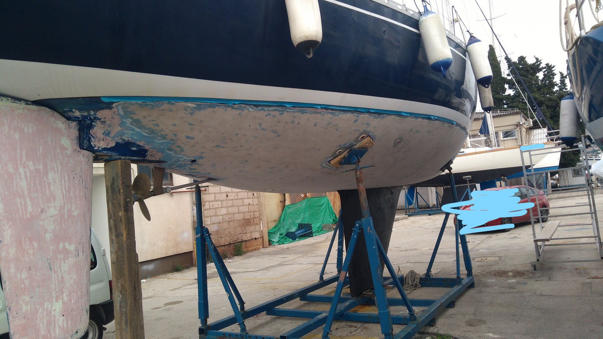

Do you have pictures of your boat on her stands? Something like this

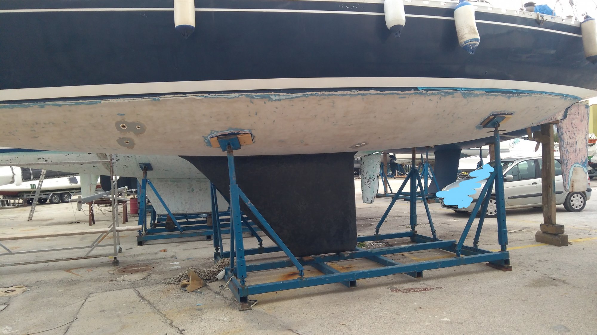

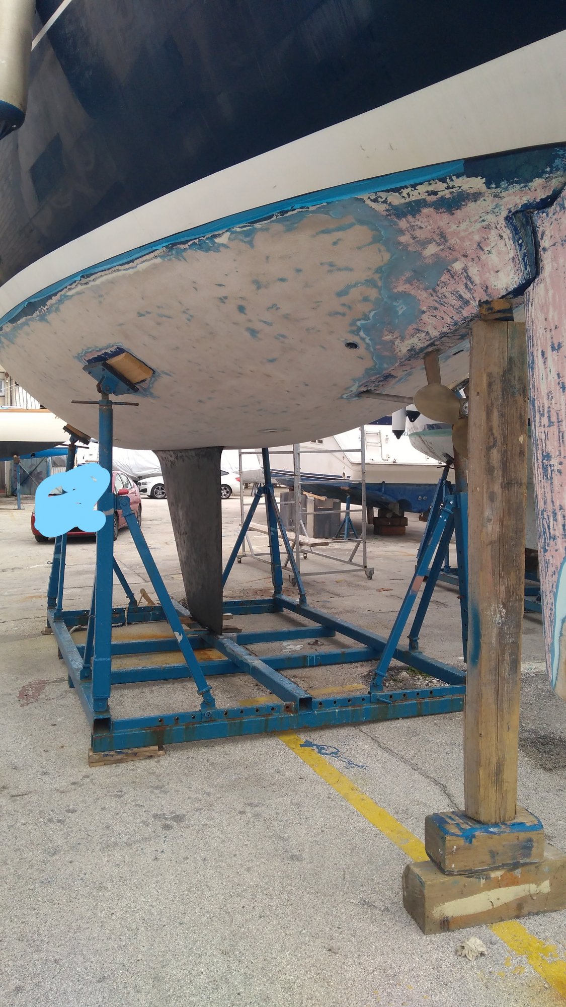

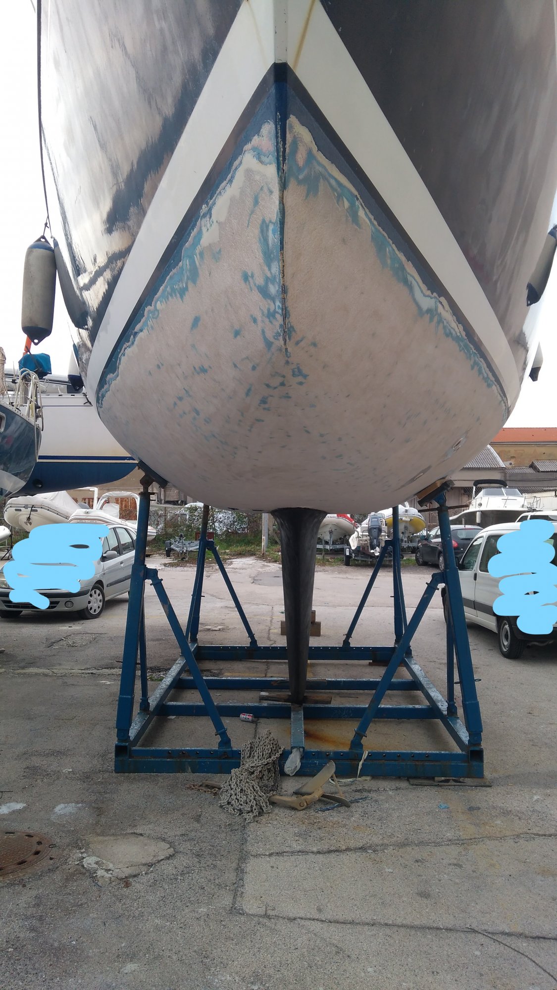

Thanks! I supposed that 4 stands (2 on each side) are not enough, but usually they put 4 stands plus 2 support bars (bow/stern). In my case the bow bar is missing. When the boat was lifted they put just 4 stands. After my request they added one bar (after one month).
Oct 19, 2017
8,160
Stands tied together in a welded frame like that are nice. I can't tell for sure, but the contact for the pads looks ok. There should be a support at the stem. The stern support went in too late. If they could tighten it (lift it) just a little after it's been in for a few days or a week, slowly get it back to where it might have been if they had put it in from the beginning, that would be good. Otherwise, she looks well supported.
-Will (Dragonfly)
14,189
The rule I cited earlier is for jack stands which are independent stands. You have what we call a cradle, which is a much better system than jack stands. Jack stands are less stable than cradles. I had a boat fall over once on jack stands.
The cradle pads should be underneath bulkheads, if at all possible, and the weight of the boat should be supported by the keel. Doing so should reduce some of the hull sagging around the keel. It looks to me, like the boat is a little far forward on the cradle. The center of gravity should be directly over the center of the cradle. This should distribute the weight more evenly and make it balance better in the cradle.
Support under the bow would be a good idea to keep the boat from tipping forward. If the boat was moved back in the cradle, the bow and stern supports might not be needed.
Any change in hull shape while out of the water will be small, or should be small, maybe a ¼" or less, but just enough to make some doors and drawers difficult to open or close. Once back in the water, everything should settle back into place.

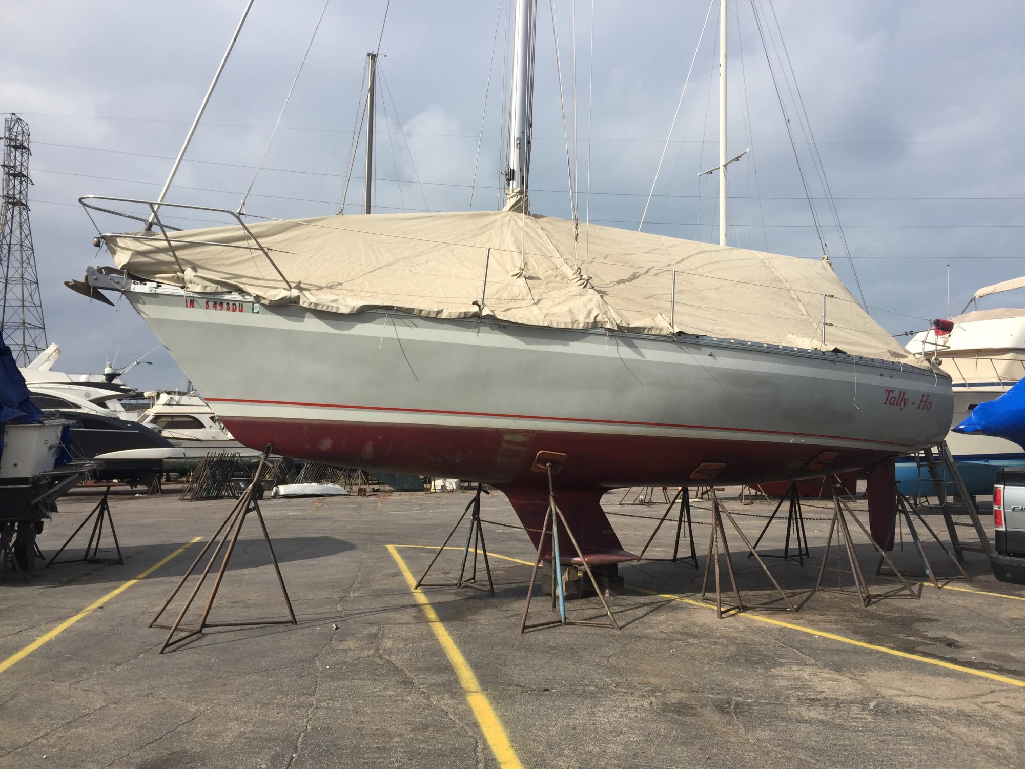

I use eight, plus one under the bow, on my 32-footer....4 on each side.
Greg
Likes: Tom J
14,189
4 stands for a 42-foot boat seems like way too few.
Greg
Greg's boat is blocked properly. Keel blocked at forward and aft end, a jack stand every 8 feet. If the forward 2 stands were moved forward, then the bow stand might not be necessary, as it is, it is probably safer with the 9th stand.
The OPs boat is on a cradle which is a more secure way of storing a boat on the hard. Additional side supports are necessary because the uprights are locked into place by the frame. In contrast, jack stands can move and when they do the boat is off balance and can fall over. Having more stands, reduces the load on any one stand, reducing the hazard if one stand should fail.
Stands can move for several reasons, the most obvious is something backing into the stand and knocking it down. Another is wind load. In a strong wind the boat can rock and the rocking can cause a stand to start walking and skidding away from the boat. Ice, soft ground, and heaving frozen ground can also move the stand.
Tally Ho is secure because the keel is blocked in 2 places so the boat can't rock fore and aft. The jack stands are chained together at the mid point, so they are less likely to walk and dance around. Some stand manufacturers secure the stands at the pads, this allows the stand to dance more and if it pulls away the stand can fall. Finally, there are enough stands so that if any one of them failed, the boat would remain upright.

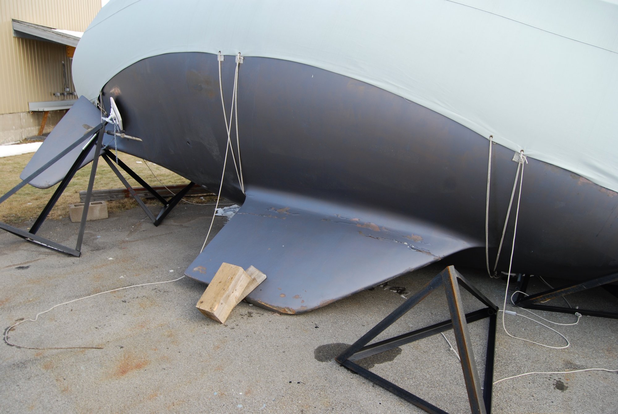

In the photo, this boat was not blocked properly. There was only 1 keel block, 5 jack stands, one under the bow and 2 on each side of 30 ft boat, and the stands were chained at the top. We believe that during a windstorm, the boat began to rock fore and aft because of the single keel block. That rocking caused the stands to begin moving, in particular the forward port stand, eventually, that stand fell, the chain pulled the pad off of the forward staboard stand and the boat fell over. The handle for the starboard pad embedded itself into the hull on the port side. I'll not use jack stands again for long term storage.

For our 37 foot boat our yard uses a cradle with 10 stands.
Not sure all 10 are really needed, but the OP’s with just 4 looks a little concerning. Like dlochner said one on the bow would help, given that the forward most stand on the cradle is so far back.
In any case my guess is it’ll come back to the right shape once back in the water. Just check that there are no cracks around any stands, keel, or bulkheads, and keep the pictures of how it’s cradled just in case.

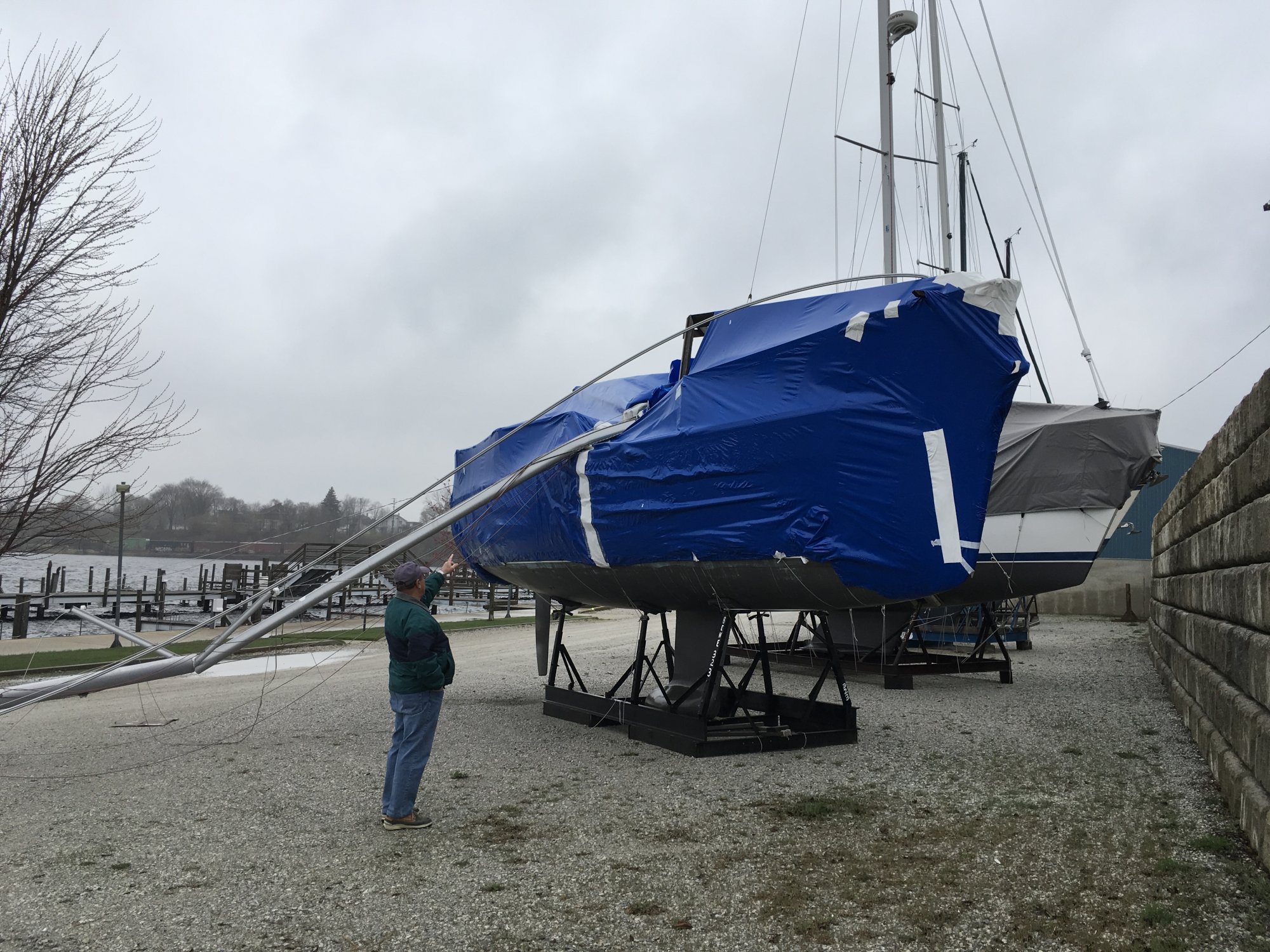

This is what can happen when the person who shrink wrapped the boat disconnected the lower shrouds for some unknown reason, and a spring windstorm comes through.
Likes: Tom J
Tom J
Sep 30, 2008
2,325
Catalina 310 Quincy, MA
This is what can happen when the person who shrink wrapped the boat disconnected the lower shrouds for some unknown reason, and a spring windstorm comes through.View attachment 173598
:yikes: Something like this happened when I had my boat on the hard in Florida years ago. A crane pulled up to the boat in front of me and two guys proceeded to disconnect all the standing rigging while the crane operator was positioning the crane. Suddenly, the mast started falling towards me, and I ducked down into the companionway. When the dust settled, the crumpled mast lay on the ground between my boat and the one next to me. Oops!

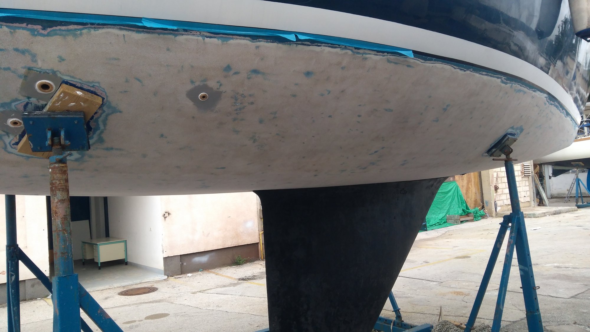

8,122
In the second pic showing the OP's boat from the bow, I think I see distortion in the hull right around the keel. This indicates to be that the weight of the boat is on the keel as it should be. The bottom of my Mark 25 would distort 4 " or more as the keel was set on the blocks. I commented on that and the yard worker said "... that's not as bad as many of the other boats." Cradles are nice but if you are using one that wasn't made for your boat the uprights may be in the wrong place. They should be where the bulkheads are. And again if the cradle isn't for your boat the width of the boat may have the cradle risers too far towards the topsides or too close to the keel. Either is a problem.
A few years ago, I noticed some serious "oil canning" of the hull at the aft most stands supporting my C310. After consulting the owner's manual, I realized the aft stands should have been placed 1' ahead of the stern cleats, where a bulkhead is located. The other two side stands are placed under "sling" markers, where other bulkheads are located. No more oil canning.
