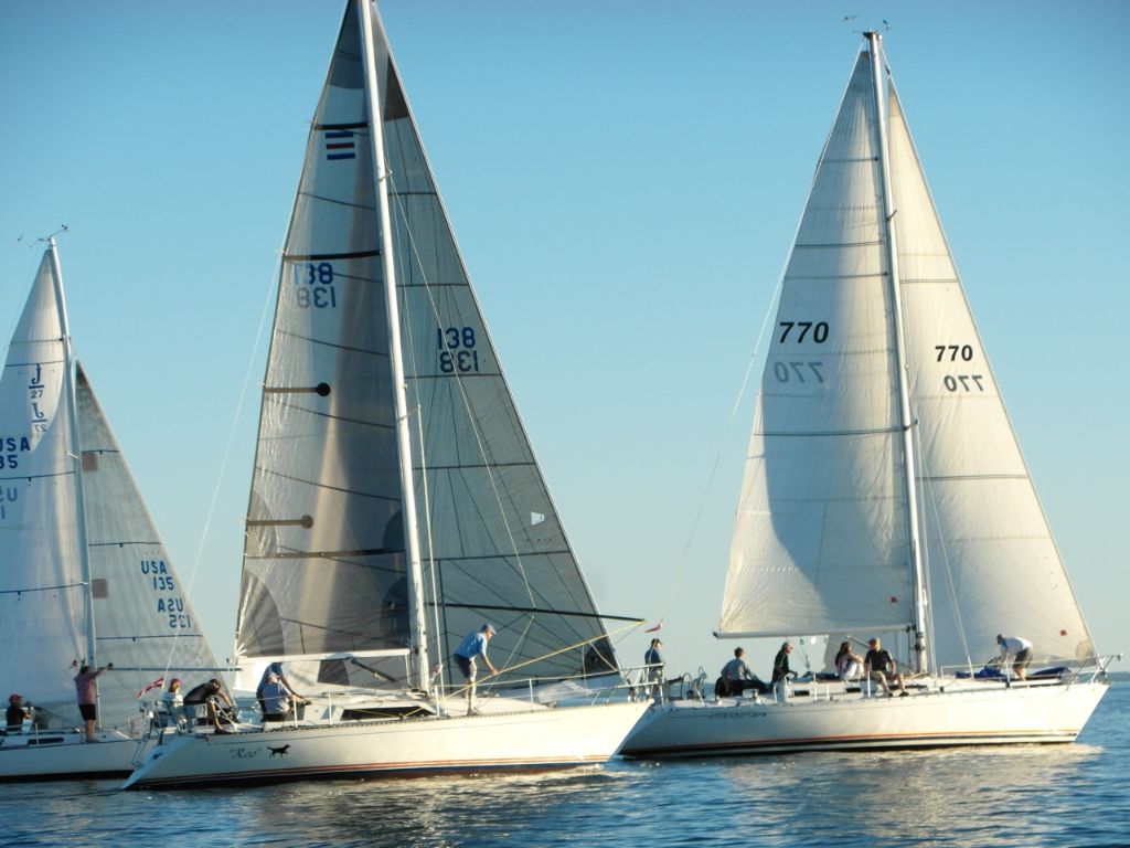

Thanks for your replies. My mast is not a furling mast I hoist the mainsail. My sails are newer racing sails with a great shape so I know its not the sails. At the dock the bow seems a little higher so probably not sitting on its lines perfectly. In the pic below Im # 770. Those are my old sails. Not much rake??

A First 375 with a deck-stepped mast? That's a new one on me. Mine is keel-stepped, and I thought they all were. I also notice your traveler seems to be mounted on the cabintop, and I thought they were all mounted on the bridgedeck...
Anyway, doing the weighted main halyard trick Jackdaw describes, I have around a foot of rake, maybe a little more. Pulling the halyard to the gooseneck, I see 2-3 inches of prebend, both with the backstay adjuster set for light air. We seem to do OK racing, if I don't screw up. Since that picture you posted was taken from off the quarter, not off the beam, it's hard to get a feel for how much rake you really have just by looking. If you do decide to lengthen the forestay, be aware that Harken furlers (can't tell if that's what you have) have an integral adjustment just like a turnbuckle.

Her is my 2 cents,
1. Get rid of the baby stay
2. You will need to check with local rigger regarding headstay extension it may require a new headstay. Can't tell what furler you have if it's a Furlex or Harken
3. Make sure the boom vang has the throw to allow the boom to come down
4. By the looks of the racing mainsail the boom is higher.
5. It looks like you could use at 7'' more headstay length.
