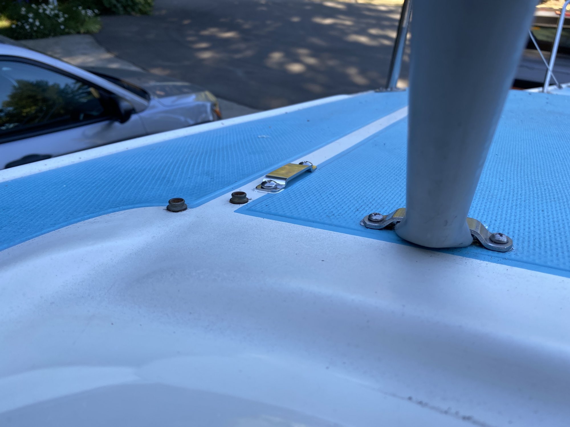

I found a couple of pics that show the additions to prevent the mast from moving side to side as it’s being lifted. They are not great or purposely made for the explanation but they do show the additional shrouds and the deck mount.
In these first 2 pics you can see the 3rd shroud. It doesn’t go all the way over to the chain plate, it just lives on the top of the deck.
This last pic is the hardware that is added to the deck to accept the new shroud.
I hope this helps you understand the system a bit better.
