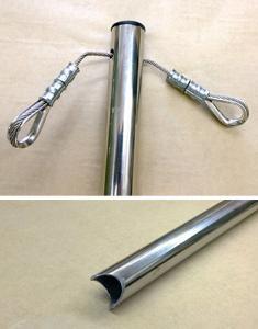

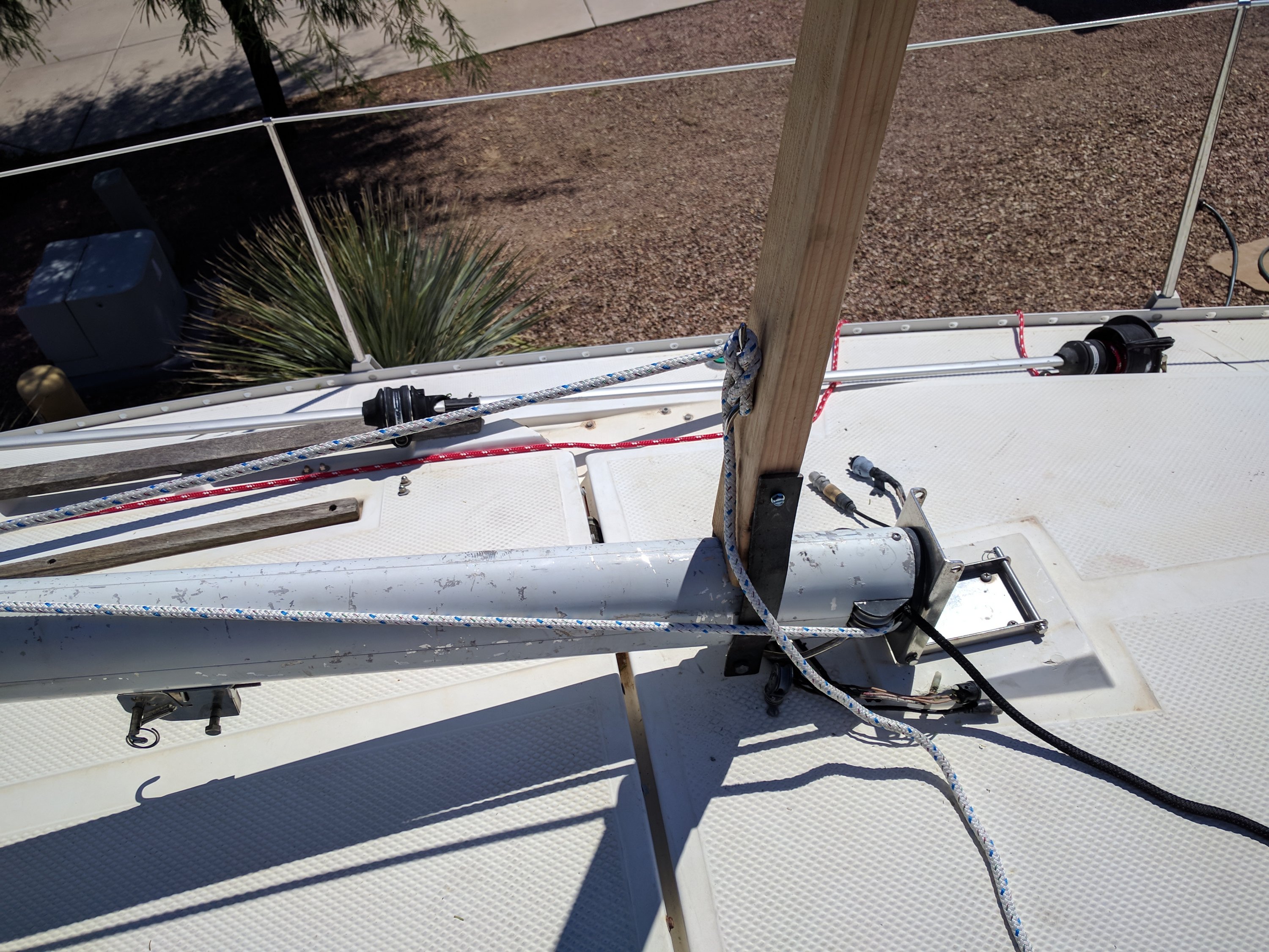

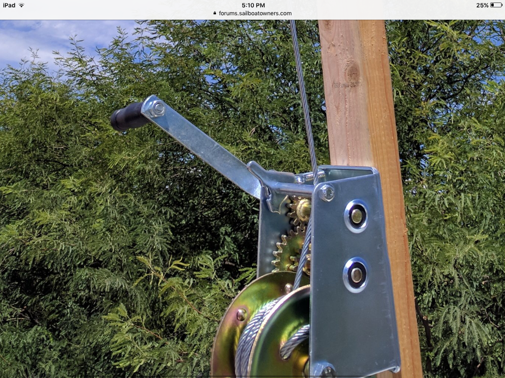

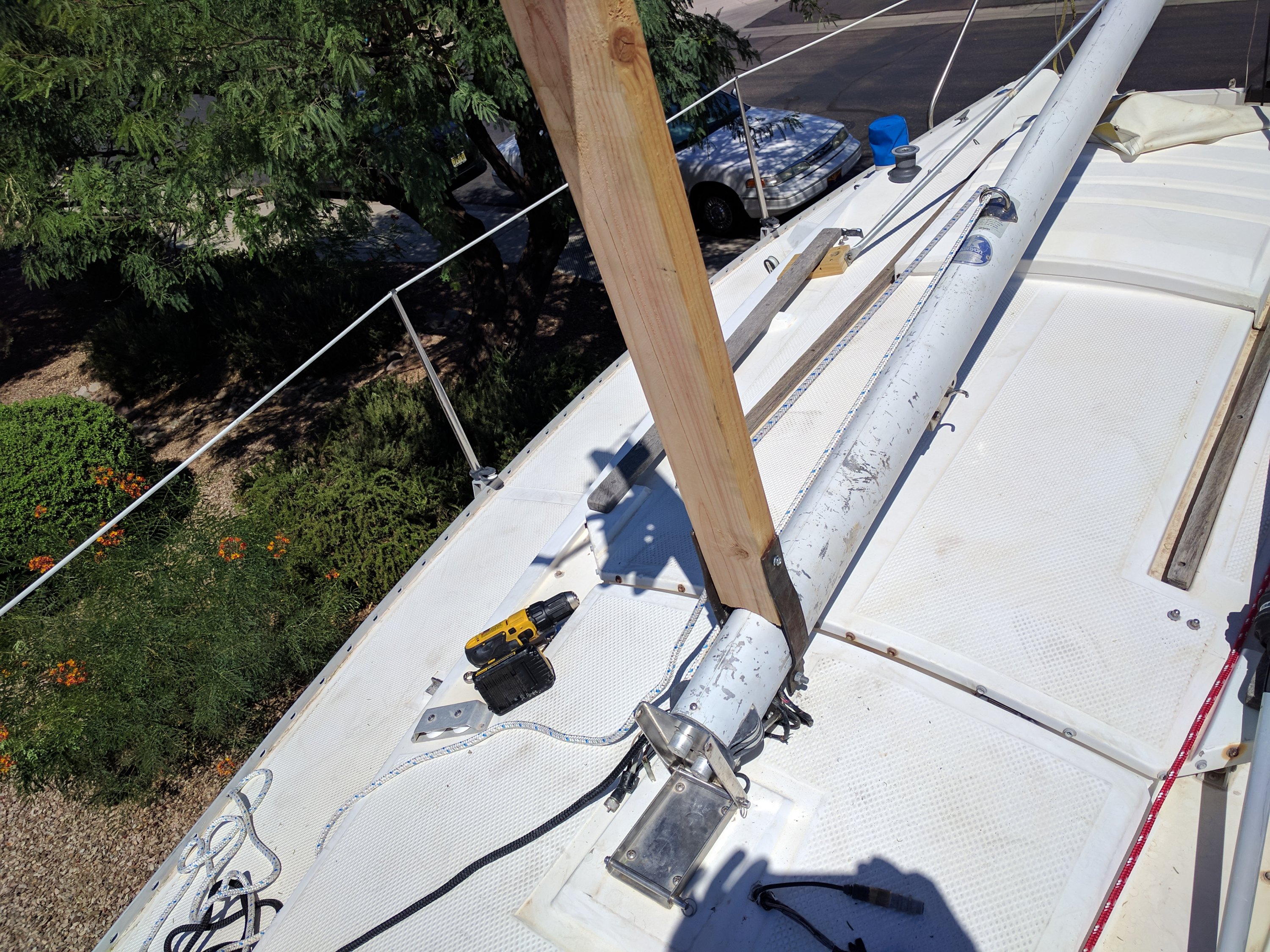

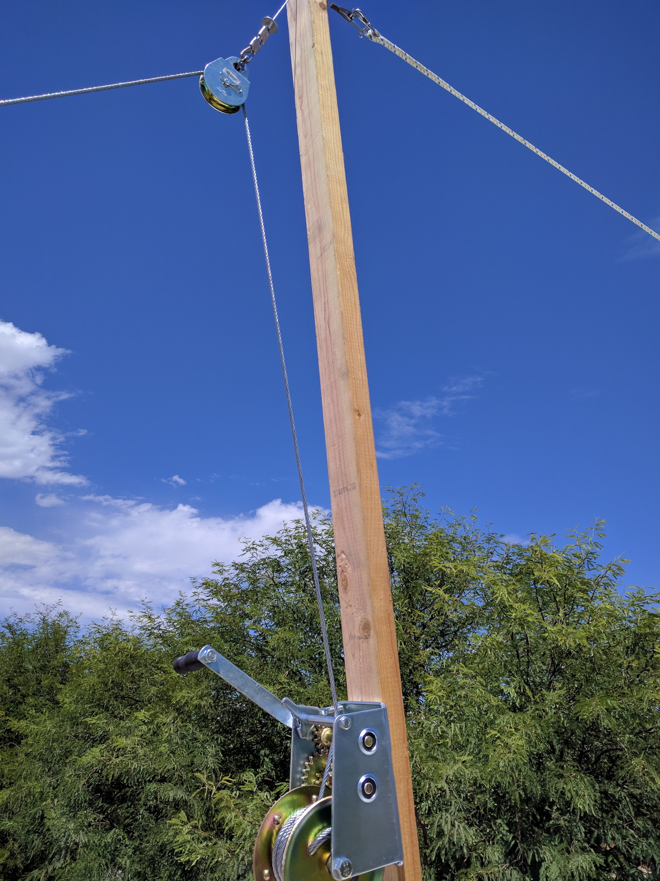

I have a H26. I believe the mast raising pole should be pretty much be the same on the 23.5, just shorter, 76 inches vs. 101 inches. The manual specifies 1" I.P.S SCH 40-6061 alloy. The mast end has a groove to fit inside the hole in the base of the mast. You just insert the pole into the hole. No need for a bolt or brackets that swivel up and down.
If I were you I would either order a mast raising system from the site store, $189.95, or make one to the OEM specs.
https://shop.hunterowners.com/hp/part.php?m=23.5&c=6&p=54701
