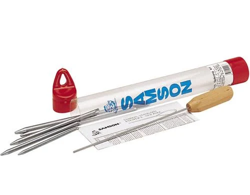

What do y-all think about splicing kits? Any recommendations?
Samson Splicing Kit for lines from 1/4" to 1/2"
$47.00
24,744
splicing kits
I like them. I have the one you post. It works OK. The issue I have with it is you are stuffing a line that does not like to stuff into the ends of the needles and then taping up in hopes it does not fall out.

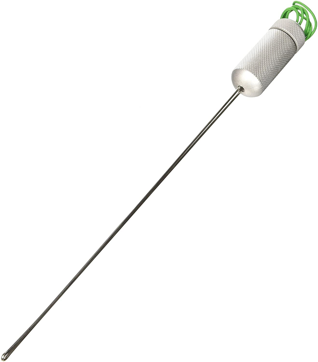

The D-Splice is terrific. I use it on Dyneema single braid line to make soft shackles. Best tool for the task.

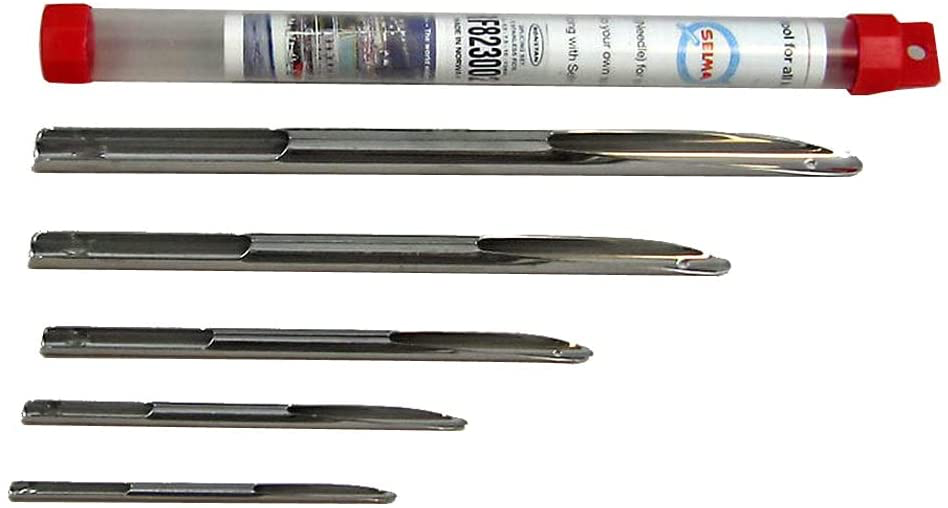

I like the SELMA Fid's better than the Sampson ones. They have a little hook to catch the line you are going to use tot make an eye splice. The tape and line holds better.

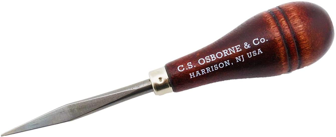

You will also find that a spike is helpful to open up or tighten knots.

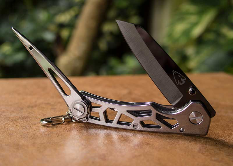

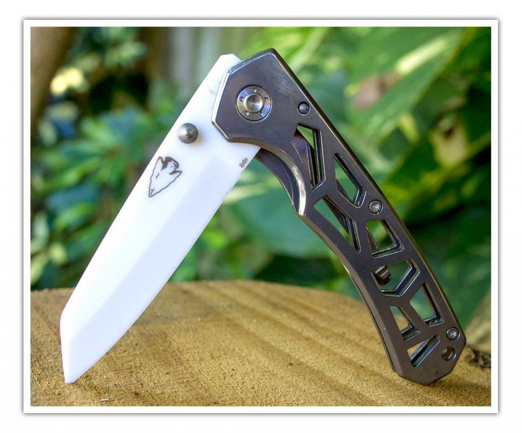

For cutting, specifically Dyneema or UHMwPE (Ultra High Molecular weight Polyethylene) or HMPE (High Modulus Polyethylene) fibre I prefer a knife with a ceramic blade.
The knife I like I bought from Marine – Ceramic Knife.org

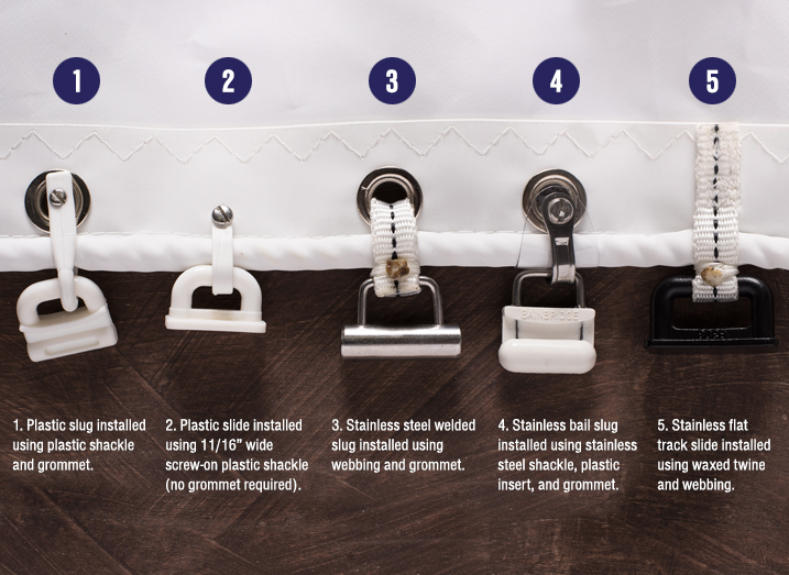

When you get new sails, give sailmaker an old slide to match up so there's no lost in translation about size & fit.
Good point. I had that problem even when the sailmaker came to look over things before building the sail. The joyful day of raising the new main was spoiled by the slugs not fitting the track.
I was surprised that it happened but it did. Hopefully very rare.
