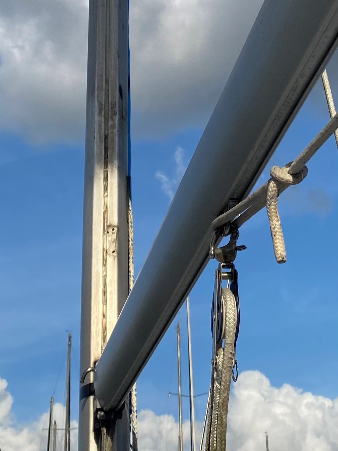

The running lines in your image do not look to bad. Looks like a halyard along the mast. A boom vang running from boom to mast base. Not sure what the line with the bowline is doing attached to the boom .
Mar 28, 2022
16
Hunter 28 New Orleans

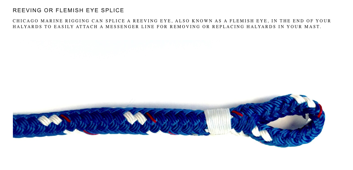

Structurally I think the lines are ok but they are very stiff from not being used. I would like to take down the halyard. I've heard soaking it in a light detergent will help. Do you have a trick to splice some smaller line to the halyard so I don't loose that path through the rigging?

The traditional way of attaching that smaller line - in this case called a messenger - to a halyard is to have a Flemish eye spliced into the end of the halyard, and then just tie the messenger to this.
This is typically an eye splice with no core in the eye. However, splicing old lines can be very difficult. In that case I would use an electrician's wire pulling basket, that once cinched up was taped to the halyard, and then the messenger tied and taped as well.
If you buy new halyards I recommend Flemish eyes on both ends.

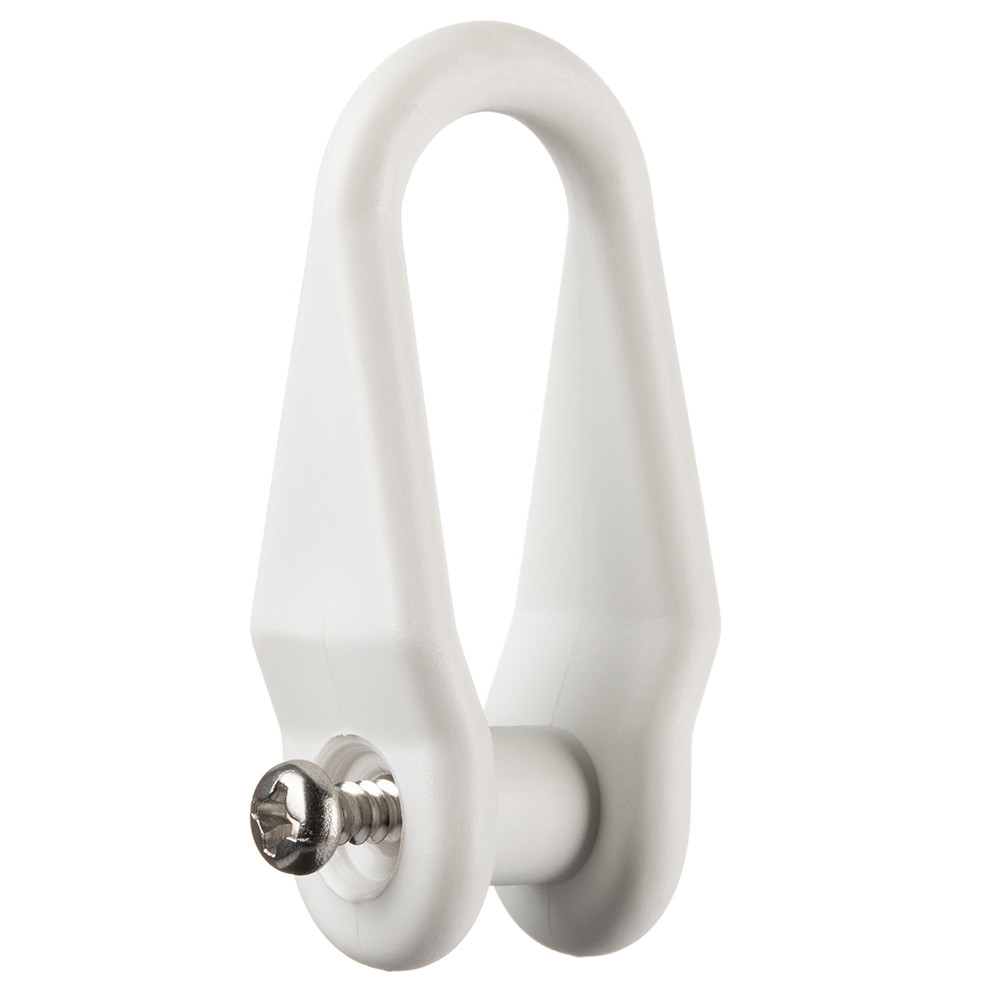

Great info on the "electrician's wire pulling basket". I'll have to look that up. The shackle I was referring to is the little plastic shackle attaching the sails grommet to the mast sliders. I'm still trying to learn all the lingo.

I know this is what the reeving eye is for, but I'm not a fan. First, the flemish eye has no strength and you can never attach a shackle to it once the halyard is in place, so it is useless once you are done. Second, I've never felt that it is possible to easily pass a spliced eye through the sheaves at the masthead. They are simply too thick. I don't know why it would be considered as simple and straight forward as attaching 2 butt ends with stitching and tape to get a line to pass easily through the sheaves. I could be missing something about it, though! ;)

Yea, those are not shackles. They are often called "hanks" on a headsail as in "hanking" your sail when you raise it. If you have a jib that isn't on roller furling and you have to attach it, that is done with hanks. Your mainsail simply has slides or slugs that are typically sewn onto the bolt rope. It sounds like you have grommets instead of a bolt rope, so the attachment may be some kind of connector that I don't know how to name! :what: Some old time mainsails don't even use slugs, the bolt rope is simply passed into the track.
Putting your sail on the mast initially is something different, though ... that's called "bending" your sail. We typically only do that once in the spring (for us northerners). :cool:
Back to shackles - this typically refers to a pretty beefy metal connector between sail and lines, such as halyards and sheets. Soft shackles are made from very strong line, though! :biggrin:

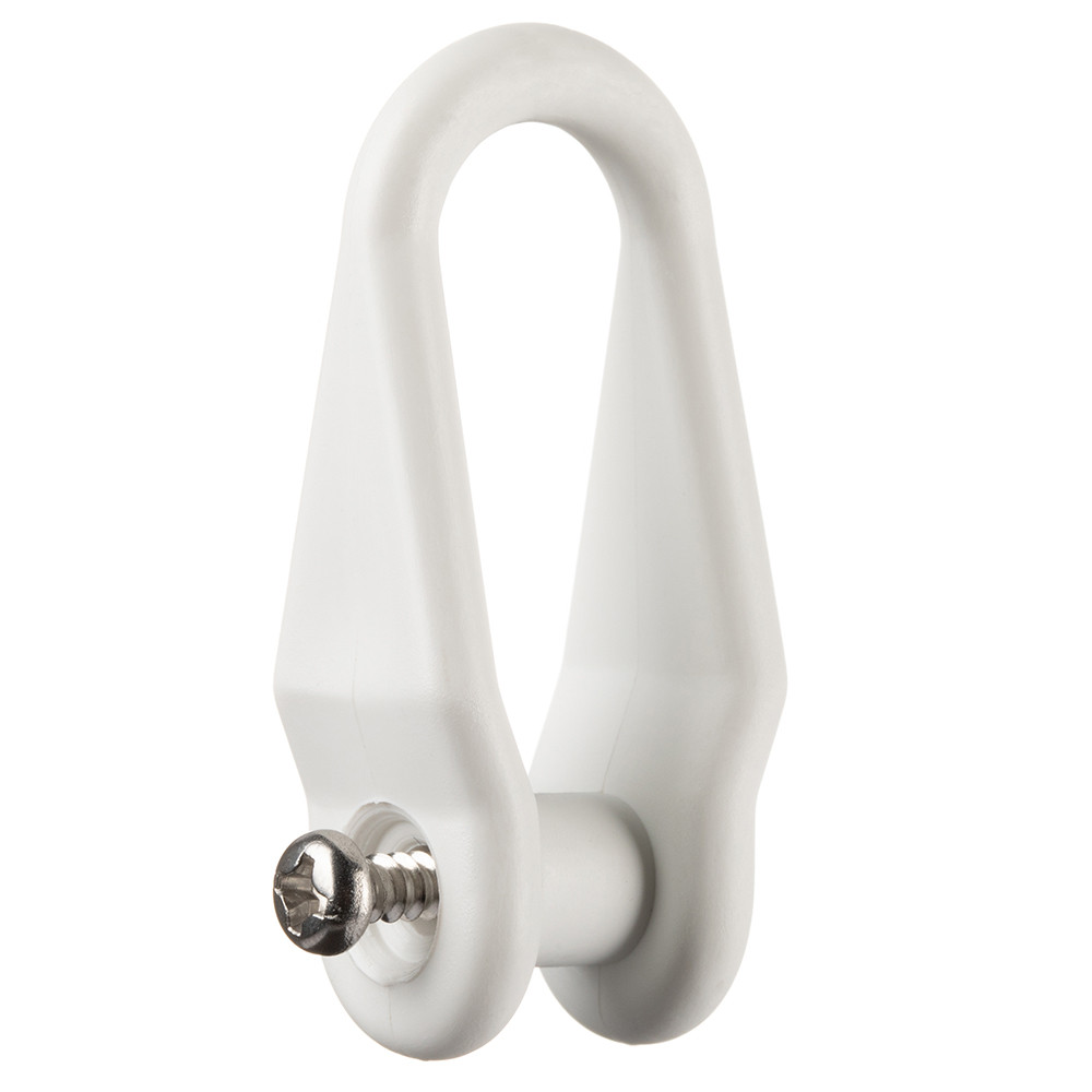

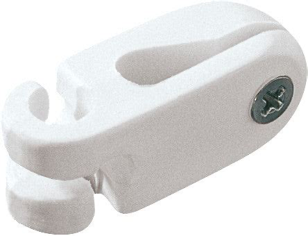

Sail hanks come in many flavors.
The one you show is one that appears to need the screw remove each time you want to put is on the forestay. This means you would have the sail on the forestay 24/7 exposed to the marine environment.
Not my first choice to keep the sail fresh and ready for action.
