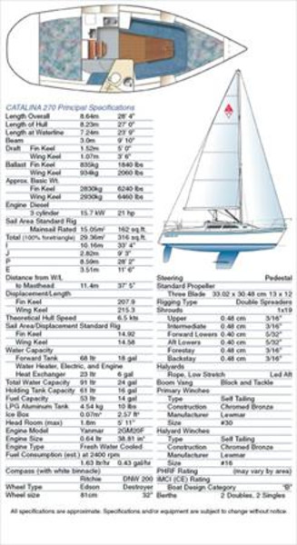

Can anyone tell me the height above waterline of a Catalina 270 with a standard mast?
I can find the I measurement, but need to know the height above water.

Under boat information specs for the Catalina 270 it shows 39 feet. Simple way to figure, run a measuring tape up the main halyard and then measure from the base of the mast to water line. This will give you a better idea. Anything on top of the mast like wind vane, antenna or what ever needs to be considered.
