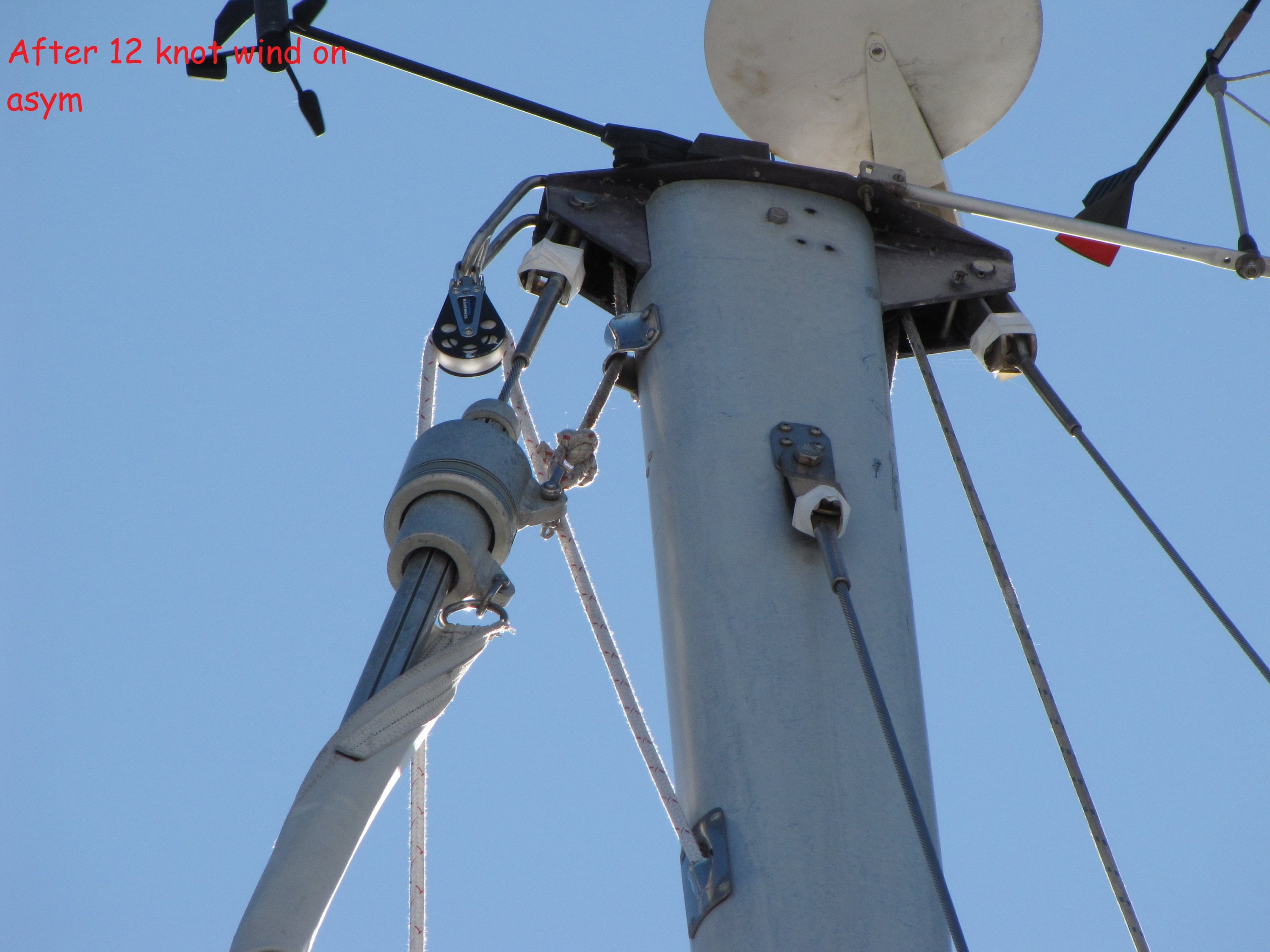

I would definitely want a fully articulating (swivelling) block up there.

Swivel block with shackle.

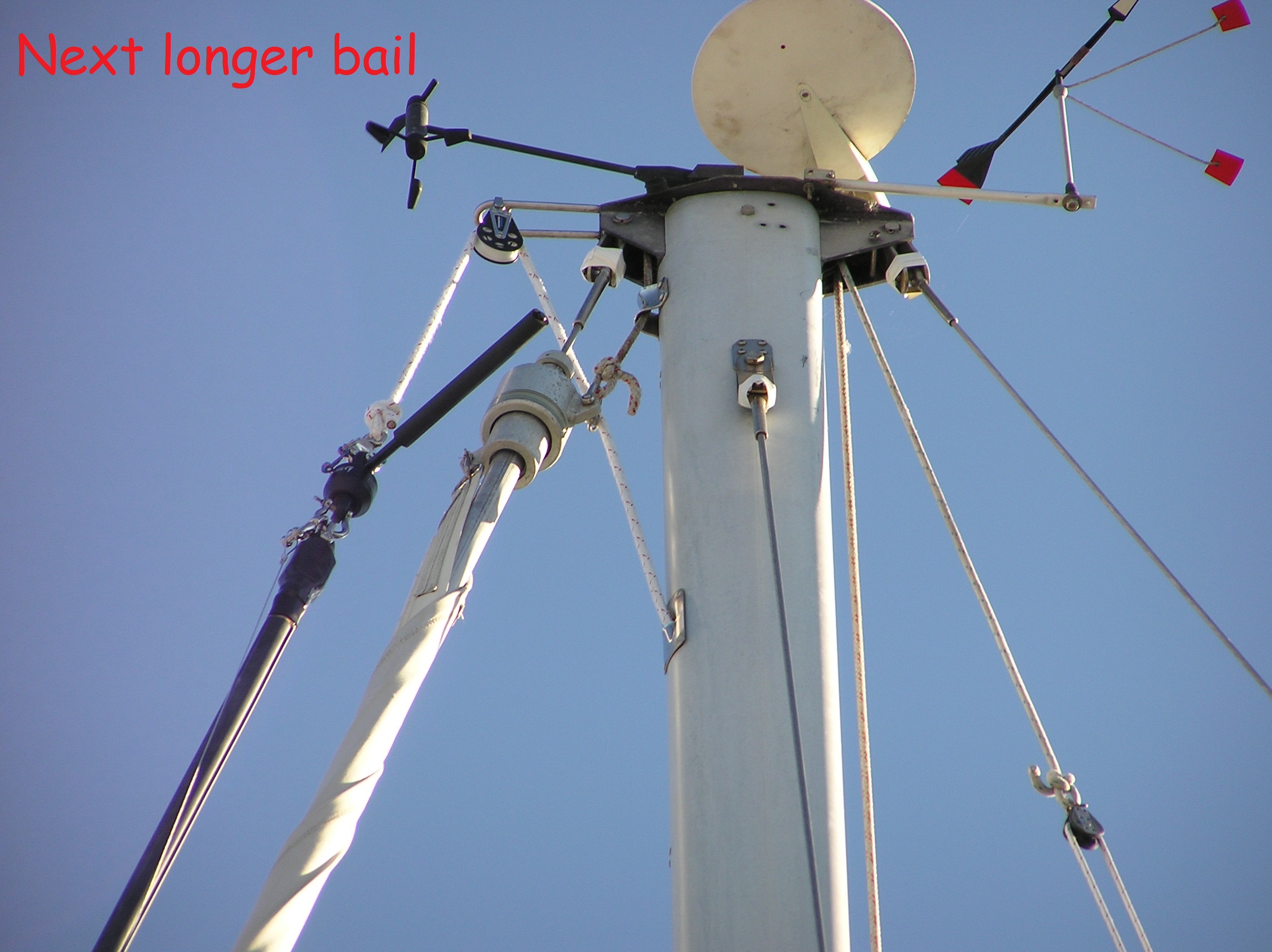

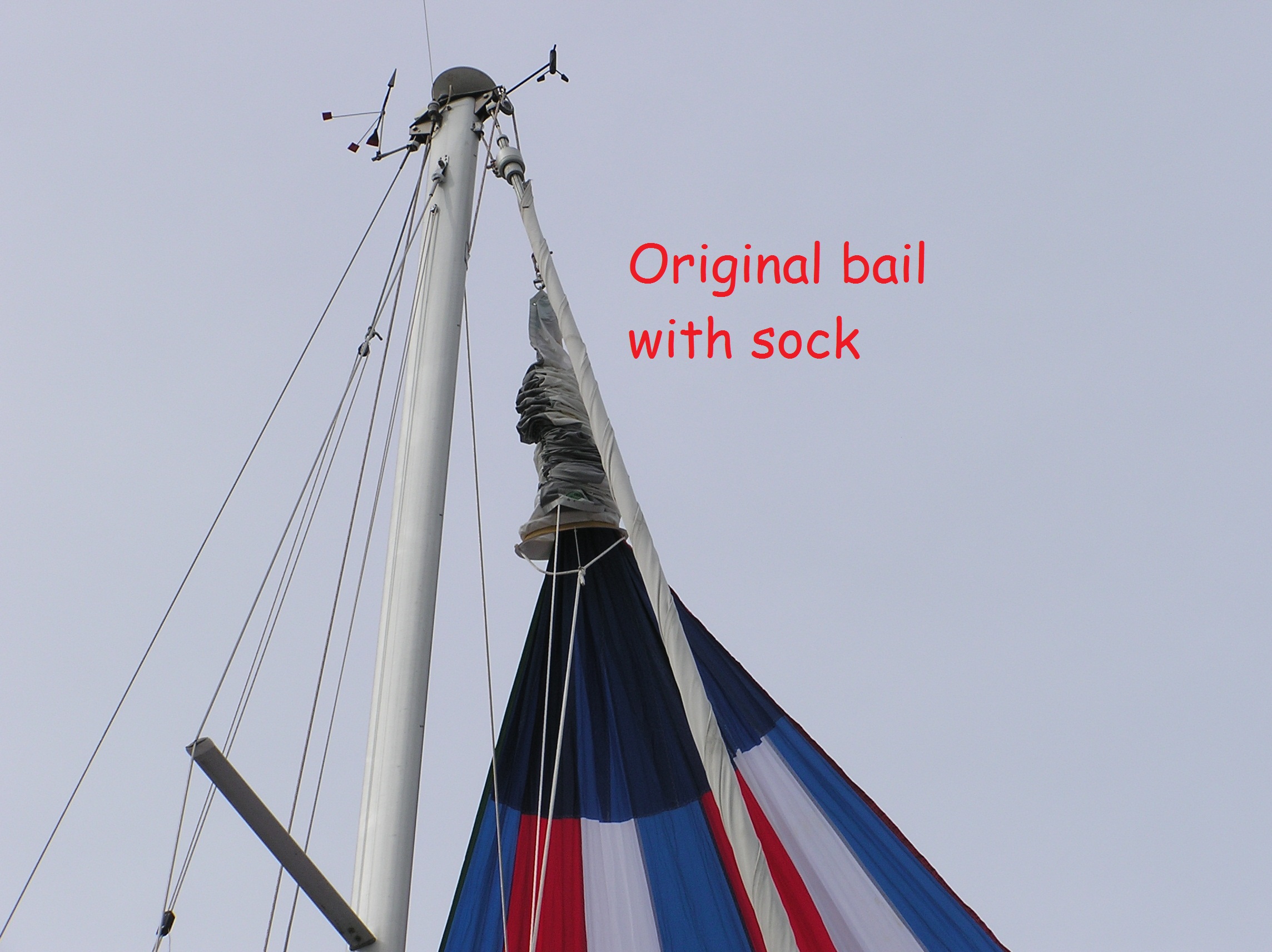

Also, it helps to have a spinnaker bail or crane attached to masthead fitting that gets the block farther out front of the headstay. If you have a "snuffer" for your asym, the sleeve gets bunched up at the top and can interfere with things sometimes.

I have the same crane as Valcour. I added a Garhauer block that swivels.

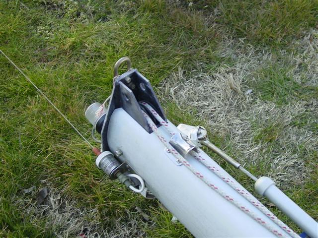

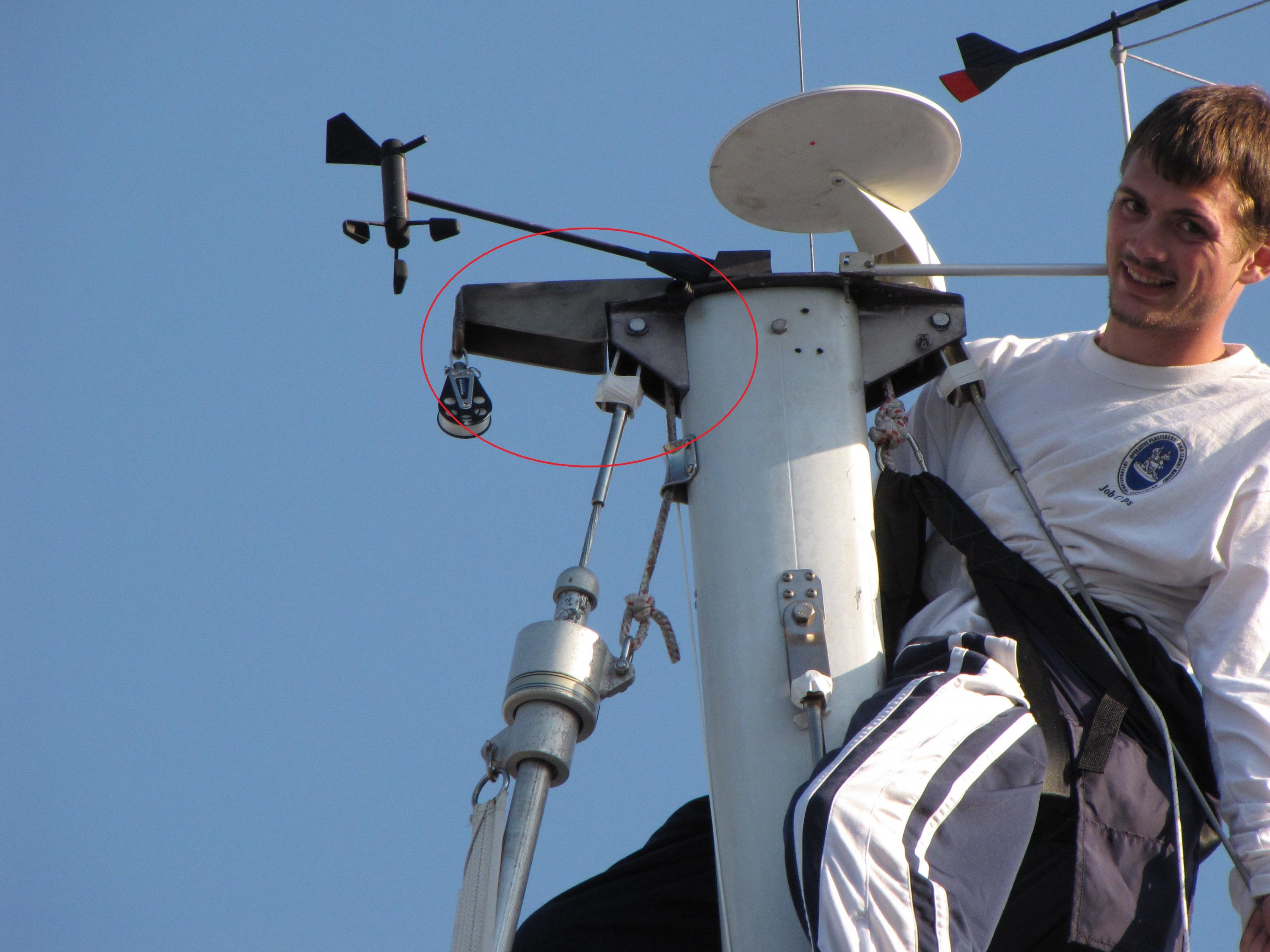

Paul, did you make that fixture? I need to move mine out about 6" to get clearance for the furler, and was thinking about crafting something like yours.
The first crane was made and installed by rigger.
I made the second crane and my grandson installed it.
