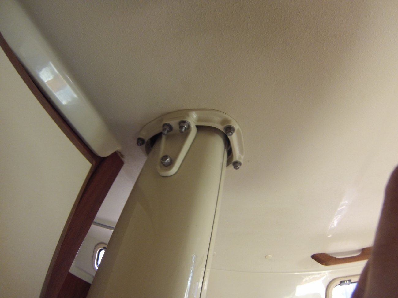

I have a 28 and find no reference to a pin through the mast on the outside. I have attached photos of the collar inside the cabin with a bolt through the mast and pages from my owners manual speaking about it. It states this is to keep the deck from flexing but if the plate the mast sits on deteriorates I think the deck would sink around the mast hole.
What year is your 28? Ours from '85 had nothing like that, just a horizontal pin that rested on the top of the deck plate. I also remember our manual having the "Installation of the pin is essential to prevent the deck from lifting" statement that eherlihy referenced.
Aug 28, 2015
190
Oday 28 St Joseph, MI
My boat is a 1981. My mast is a Kenyon. I don’t think one system is any better than the other, just that the engineers chose a different path to accomplish the same thing.
