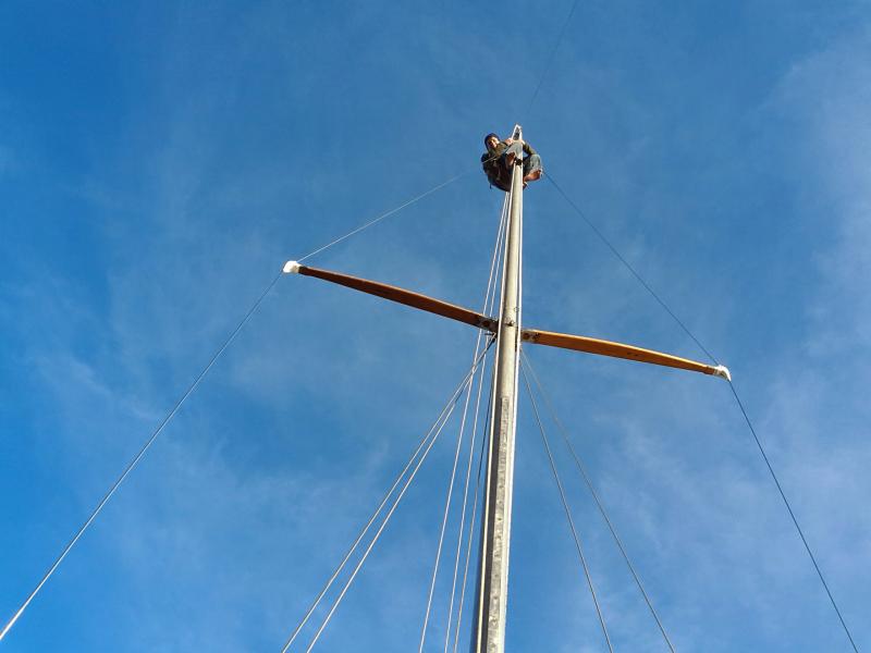

I just sent my 14 year old son up the mast a few days ago on my Alberg 35. He has been climbing trees since he could walk and loves to go up the mast. I cranked him up on the main halyard (wire) with my wife belaying on an aux. jib halyard also attached to chair. Once he got to the spreaders, he unclipped the jib halyard, moved it over the top of the spreaders and reclipped. Then we proceeded to the top. My son should have been wearing shoes, but he has an amazing talent for going places and 'forgetting' his shoes. This was one of those occasions.
The key ingredients for a successful hoist are
1. Redundancy - don't rely on one halyard, always use two just in case.
2. Competency - make sure the crew on deck knows what they are doing and have the strength and know how to belay.
3. Willing hoistee - don't send someone up who is not comfortable with heights, you don't need someone panicking once they are off the deck.
If your safe about it, there shouldn't be a problem. Unless your rig is a disaster, your boat will support you (or your wife) without issue.
