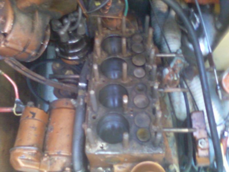

Saturday - 16 June - I went to the boat and took out the spark plugs. Putting finger on top of hole, I confirmed, front two cylinders had compression -- the back two did not. Descriptively writing, the front cylinders "popped" my finger off the spark plug holes, the back two only created a "whoosh-wish" sound with no sensation of pressure under my finger.

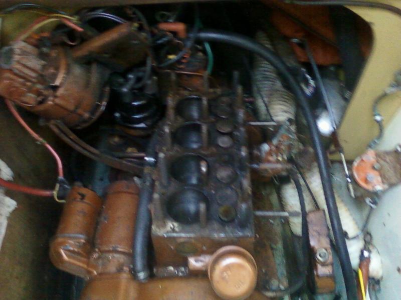

NEXT, I may have jumped the gun, but, knowing that my engine definitely a compression issue, I removed the head, and the side panel. Please see picture.
Cylinders look well polished with no major, or even minor, vertical scratched or gouges in walls. Cylinders hold WD-40, that is to say, it appears that the rings are "OK." At least they exist.
Back four valves appear to have bits of black crud under them that prevent a tight seal. I write "appear" because as it took hours to take off head, I was just about beat, beat, beat, when I took final pictures and said "enough for one day."
To the guys who offered I PB Blast the crap out of the valves, I probably should have or maybe would have, but I really wanted to see the issue. Yes, I am into this now to the tune of at least three or five gaskets (one of two head gaskets (had only one before). thermostat, intake/exhaust manifold, and side panel.)
OIL is clear, full bodied, looks like it does out of the can, with no metal and no water in it.
The tappets, where they are always exposed are blackened by oil and years of exposure, but where they fall down towards the cam are bright and polished to a mirror shine. All the tappets appear to rise and fall with no hesitation.
WHAT TO DO NOW? Remove valves and take to machine shop, buy new, clean in place, remove and clean?

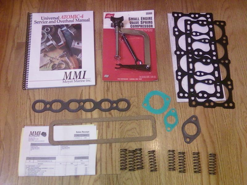

Arrival in Wednesday's mail -- PARTS, MANUAL, and TOOLS

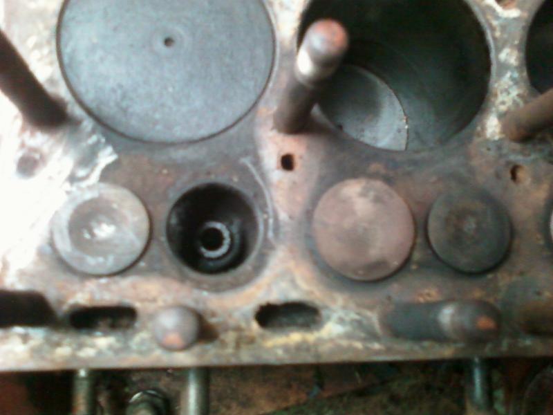

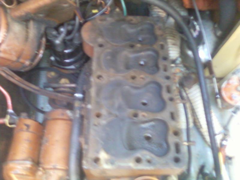

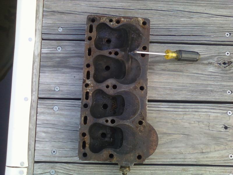

Can we say CARBON PLEASE? I wanted to do this a week ago but the heat was just too much. So, I moved a small home AC down to the boat and blowing cool air into the campanion way, I was able to tolerate the temperature.
Carbon and other goo was covering the valves and exhaust flow. On two of my INTAKE valves, the keepers were so corroded that they would not release with the valve tool. As I am replacing the springs already, I used the dremel tool to cut them apart and then osed a socet and hammer to tap the valve keepers free.
Today (did not go to work) I plan to begin re-assembly. Posted one new picture (took more but have only one available). The dark shadow is 3/8 of an inch of carbon.
Add to the problems, blown head gasket -- see shadow of carbon between three and four.

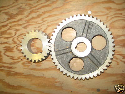

As mentioned before the symptoms are consisten with the camshaft not turning. Remove the timing gear cover and inspect the gears. Broken gear or sheared coupler keys are a possibility. Picture of new gears on E-Bay $175.
10,253
No suction at all.. as other posters have said, Timing chain? or whatever drives the cam besides the chain.. sprocket keys for instance..Just stripped a timing belt on a twin cam engine and one symptom was no suction..

I would say timing chain/gear problem. Can be instantaneous and if there is enough clearance between the valves and piston it can also be noise free.
Nov 23, 2011
2,023
MacGregor 26D London Ontario Canada
Just a note to add here. If there was noise and isn't anymore there might be new clearance between the valves and the pistons made by the pistons hitting and bending the valves.
What ever it is in the end it might be a good idea to change the oil and look for bits of metal in it.

I have had timing gears or chains break on three engines and it is always the same: a complete quiet shut down. When the cam stops turning everything quits.
