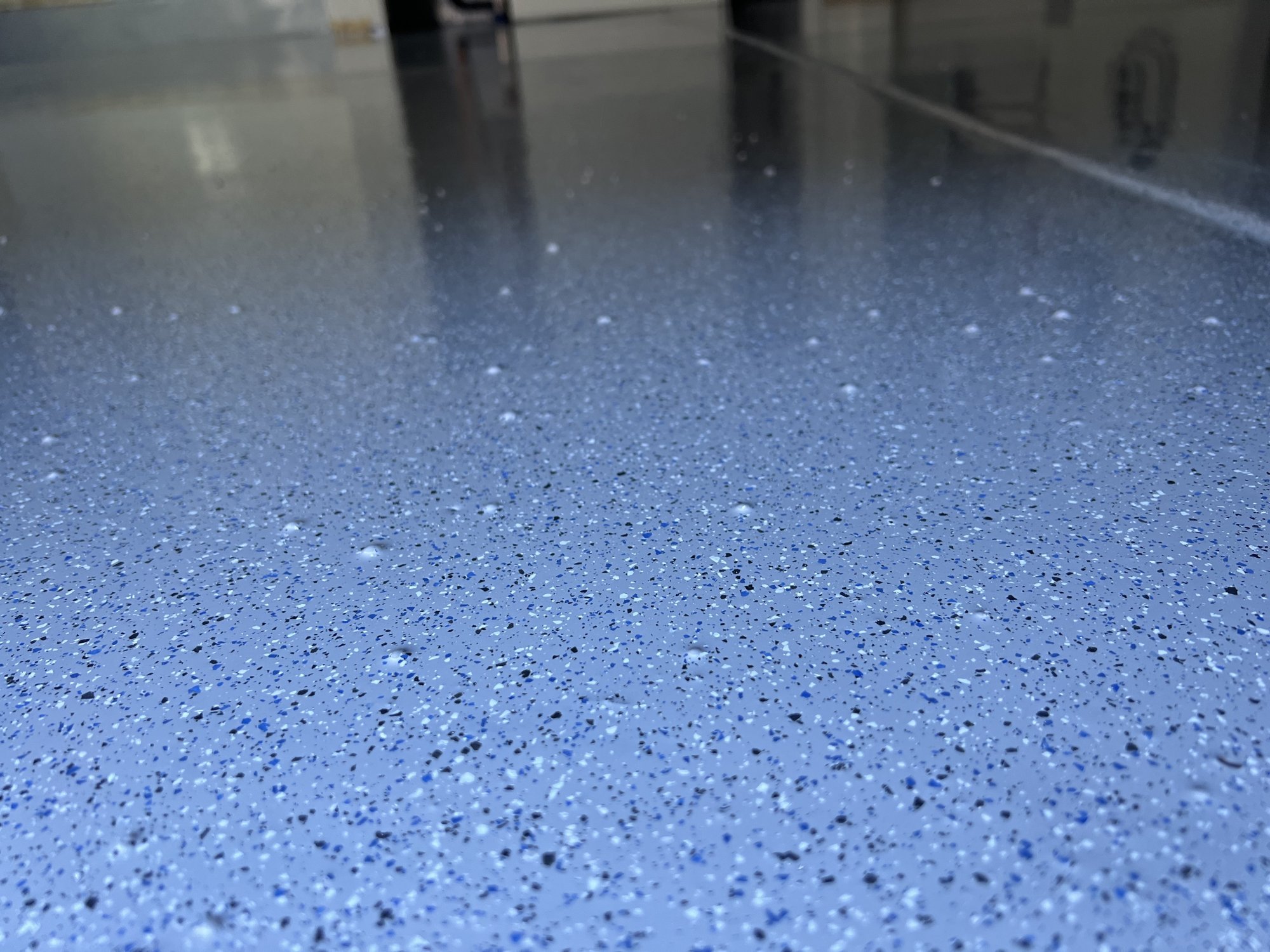

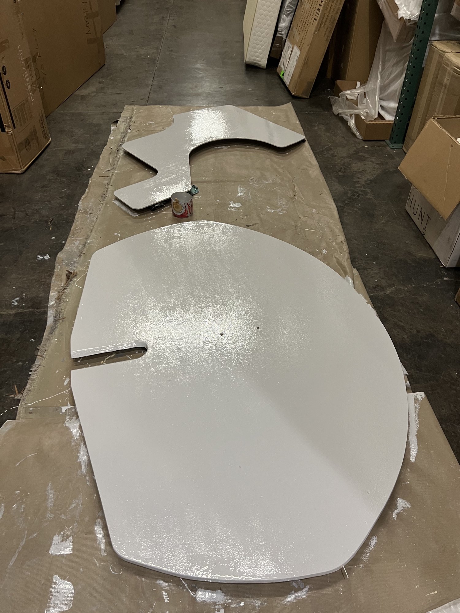

I just replaced the original floor in a Hunter 260. Luckily I managed to get it out in one piece so I could use it as a template. I decided to use 1/4 inch ply (smooth sanded finish on one side) and epoxy it front and back to avoid a repeat. The epoxy was the same grade as a garage floor and I added a polyurethane 2nd coat which I added anti slip silica sand. It has a feeling of sand paper under foot.
I don't have a close up photo of the finish on the actual floor but here is a garage I did recently along with a wide shot of the floor. Also, I ripped out the original table which we didn't use and made something more appropriate. You can purchase a small amount of epoxy that you can roll on from Performance Epoxy Epoxy-Coat. It will come with the flake and anti slip.

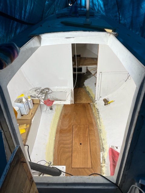

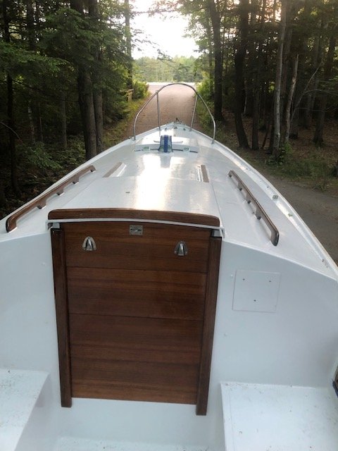

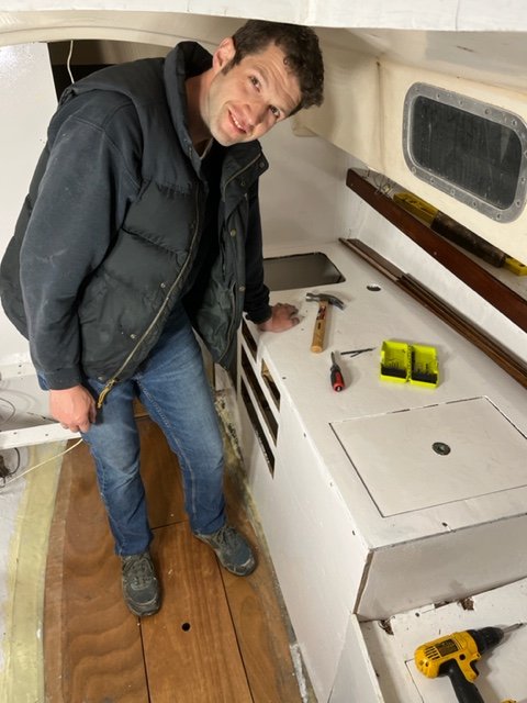

Sorry for the late follow-up. I completed all the renovation work last winter, including the floor (see photos), and had a fantastic sailing season until about the end of August. I used marine plywood in the main cabin and as I took everything out realized the small section of floor in the V-berth needed to be replaced as well. I didn't have enough marine left so I used high grade non-marine for the small v-berth floor. After 1 sailing summer, the non-marine plywood floor needs some repairs and the marine plywood floor looks like it did the day I installed it.
The only thing I didn't replace last summer were the bulkheads and I found out in late August that underneath the plastic veneer, they were totally rotten. In late August, the chainplates started ripping through the rot and pulling out upwards. I was lucky to notice it before the mast came down. So, now, this winter, I am ripping everything back out so I can replace the bulkheads and chainplates. I'll start anothter thread on that!
It was a magical summer of sailing the Bristol 24 in Maine. It's a fantastic and mighty little boat and I'll always keep her sailing. Once the bulkheads and chainplates are replaced, she'll be like new.
