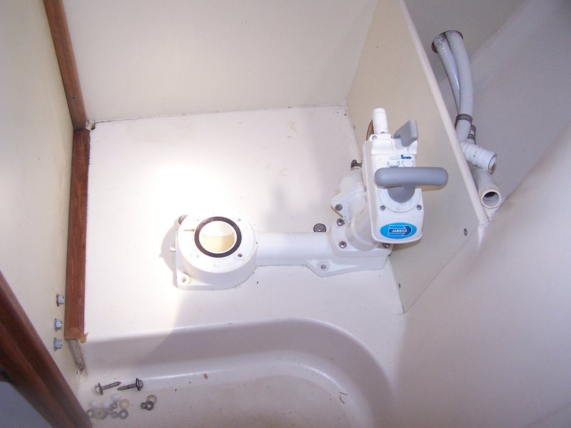

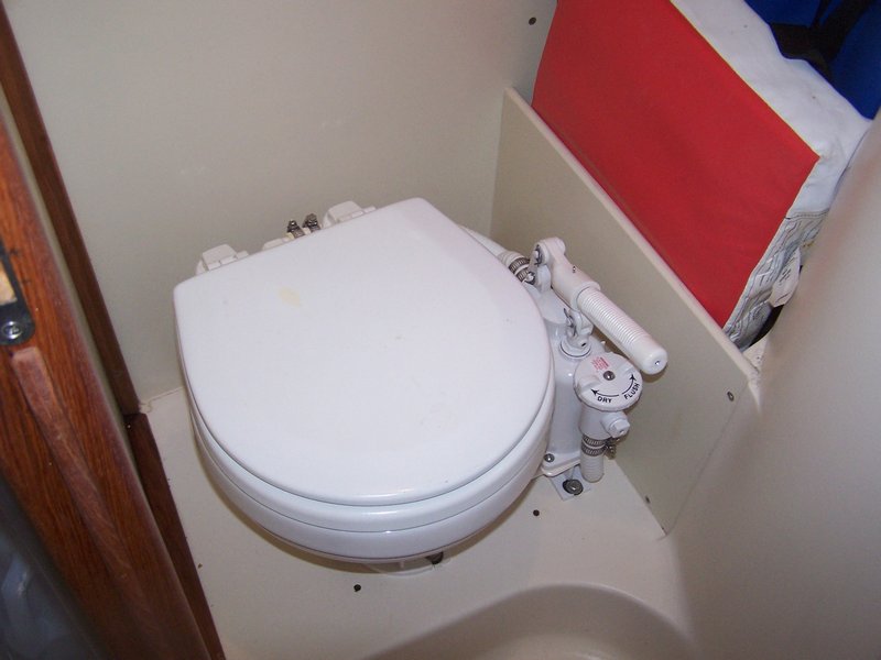

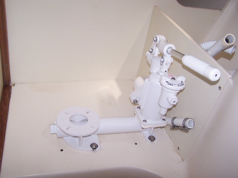

The pump on my JABSCO was sticky, so I disassembled it to lube the 'O' ring. On reassembly, I couldn't get the pump to stop leaking. I ended up over torquing one screw and the screw boss broke free!
Rather than repair a part with a poor serviceability reputation, I decided to replace it. The Raritan LBA is sold at this site without the bowl, so I went with that.
The only alteration I made was to the base mounting screw pattern. All the old hoses fit. This project took about 4 hours to complete, which included about 1 hour of cleaning.

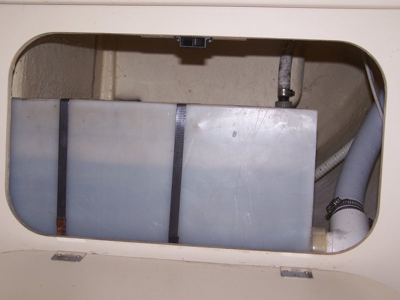

1. The holding tank is behind the stern bulkhead on the port side, opposite the battery.
2. The waist hose goes under the aft berth to the holding tank.

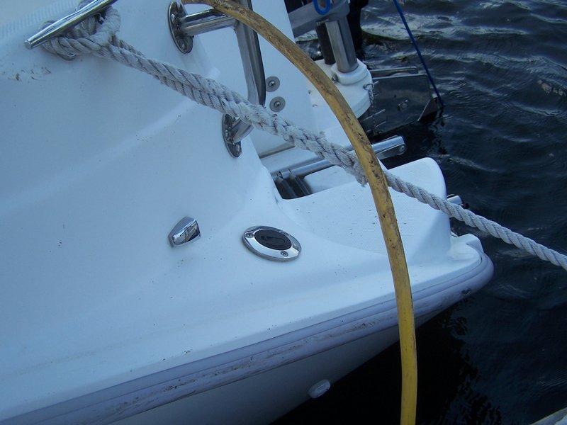

3. The pump-out plate is on the very stern, port side, next to the swim ladder. It is directly below the stern rail seat. The vent is just forward of that, under the rub rail.

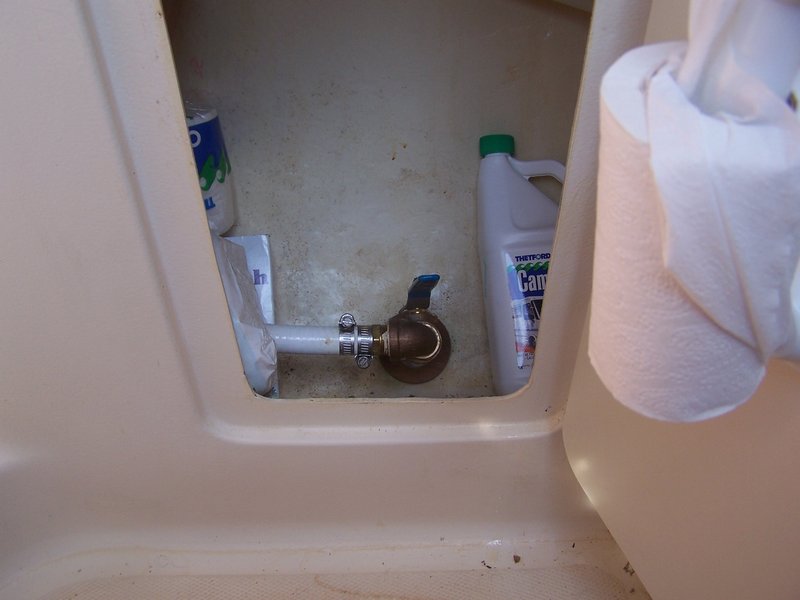

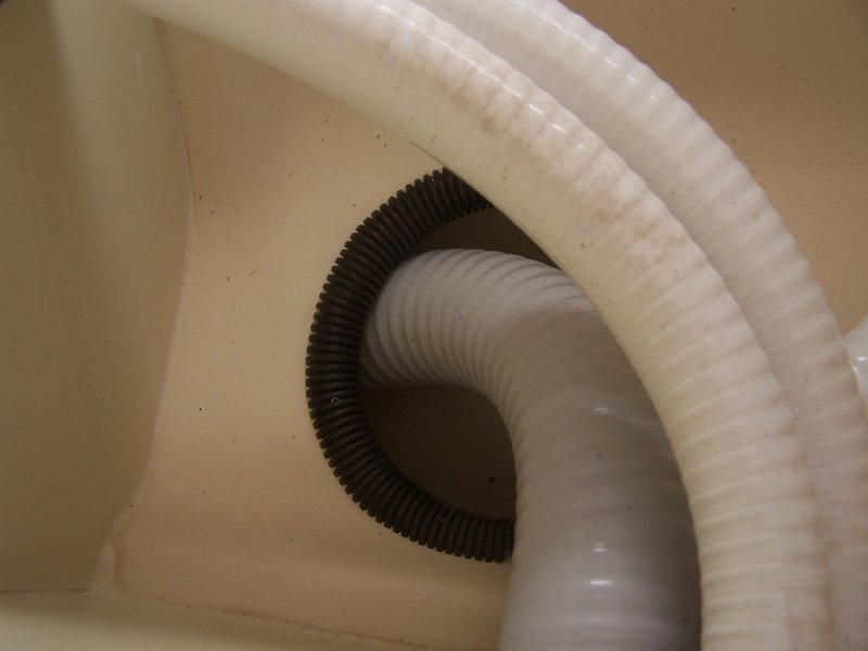

Here are the photos I promised:
#1 Shows all the hoses going port from the head

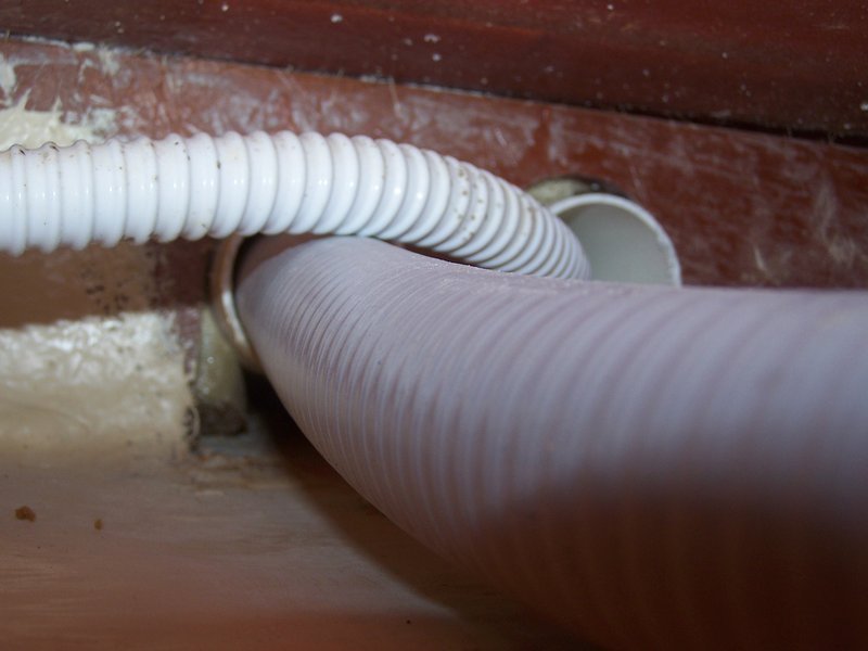

#2 The thru-hull for water in, under the sink

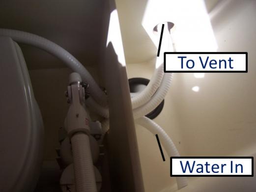

#3 The pump-to-bowl water in vent in the wet gear locker

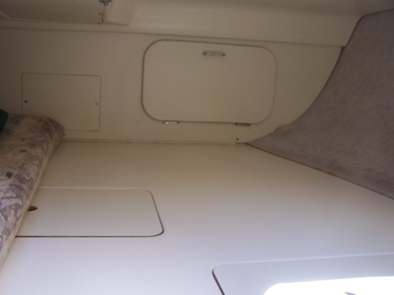

#4 Looking at the aft bulkhead. Waste hose runs under the deck.

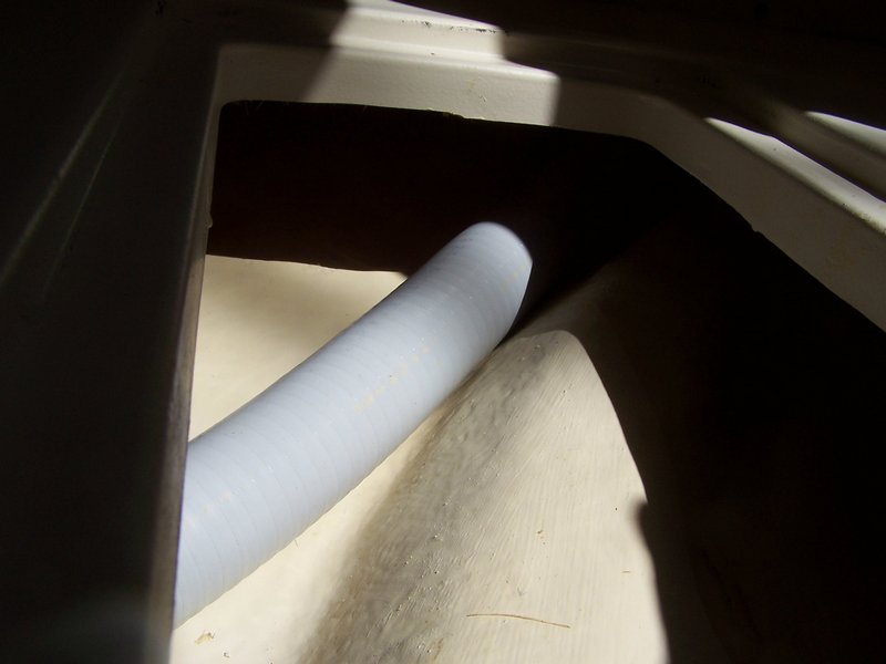

#5 The holding tank, behind the aft bulkhead
#6 Next to the head, the waste hose runs down
#7 Looking port, under the deck, near the head
#8 Looking aft, under the deck, the hose goes thru the aft bulkhead
#9 Vent and waste deck plate, directly above the holding tank, on the stern.
