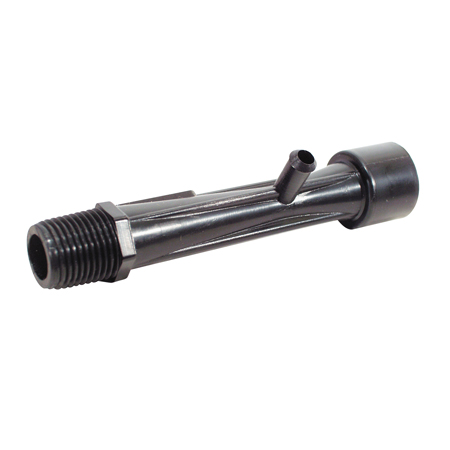

Robert, can you provide buying info of the venturi you use? Thanks.

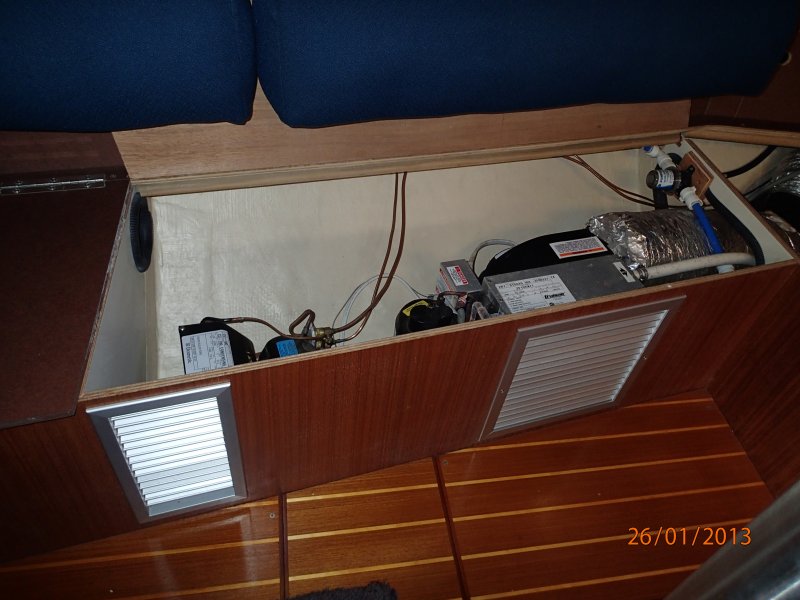

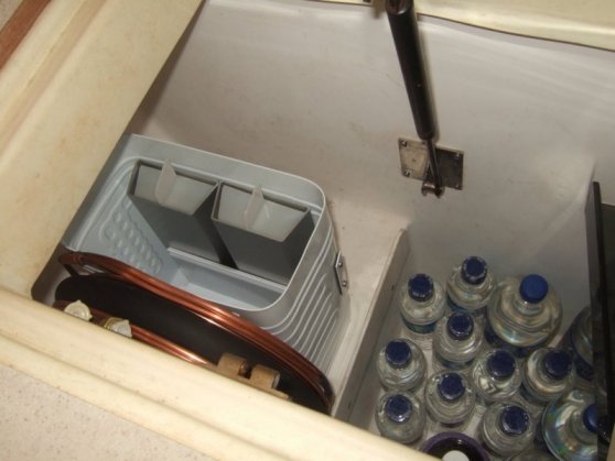

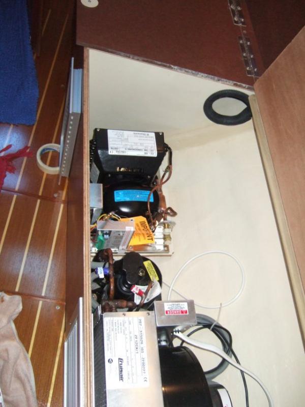

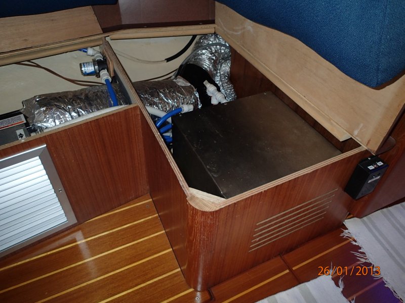

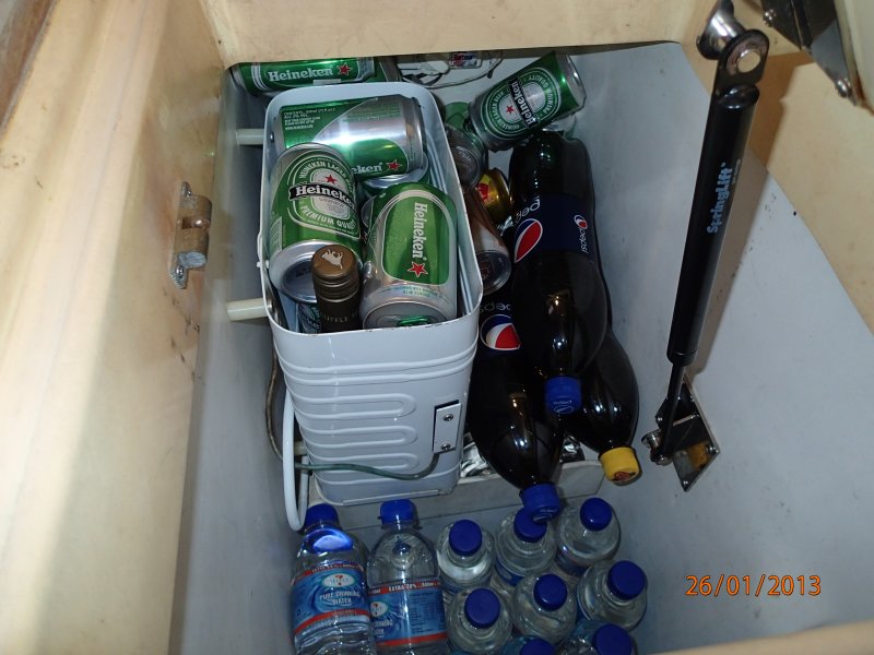

kjretlaw, photos for your reference. Photos of job not completed yet. Trying layout, that's the final position.
