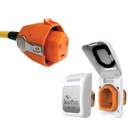

@odaydokay Perhaps this is the moment to upgrade your fitting and cord to a SmartPlug.
You can use the same wire, only change the boat fitting and swap out the female plug.
Once you go smart plug you'll never go back...
Second that recommendation!
One of the best upgrades that I have done. No more fiddling with aligning the female end of the plug and no more dealing with that plastic ring that always wants to cross thread or jam. Much superior conductance also. Highly recommended.!
