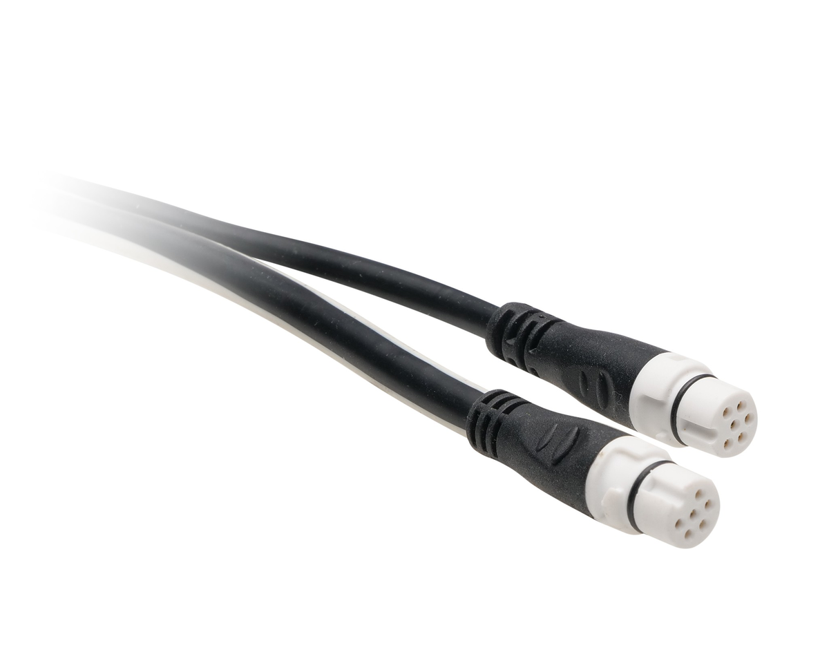

Unlikely that the connector itself will be available. Possibly an extension cable (Raymarine R42124) or old mic (A46051) would allow you to cut off the male end and splice to your handset. Otherwise a new handset will be in order.

Maybe you can call and discuss taking it off their hands at a price that you are comfortable with.
Here is a thread from an old, now closed down, Raymarine forum that talks about your issue. It may get you started.
. . . A46051 remote handset connector
