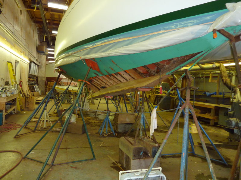

Feb 6, 1998
11,772
A well designed, well built, well maintained wooden boat will have very little problem with rot.
By well built and designed and maintained does a Concordia count?
Other than some rotted frames and back bone this boat had been exceptionally well maintained by even the most critical wood boat standards..
This repair exceeded the cost of this boat when she was new, by a long shot.. Course if you can afford to own a Concordia...... A repair like this is probably like you or I buying a can of varnish..
