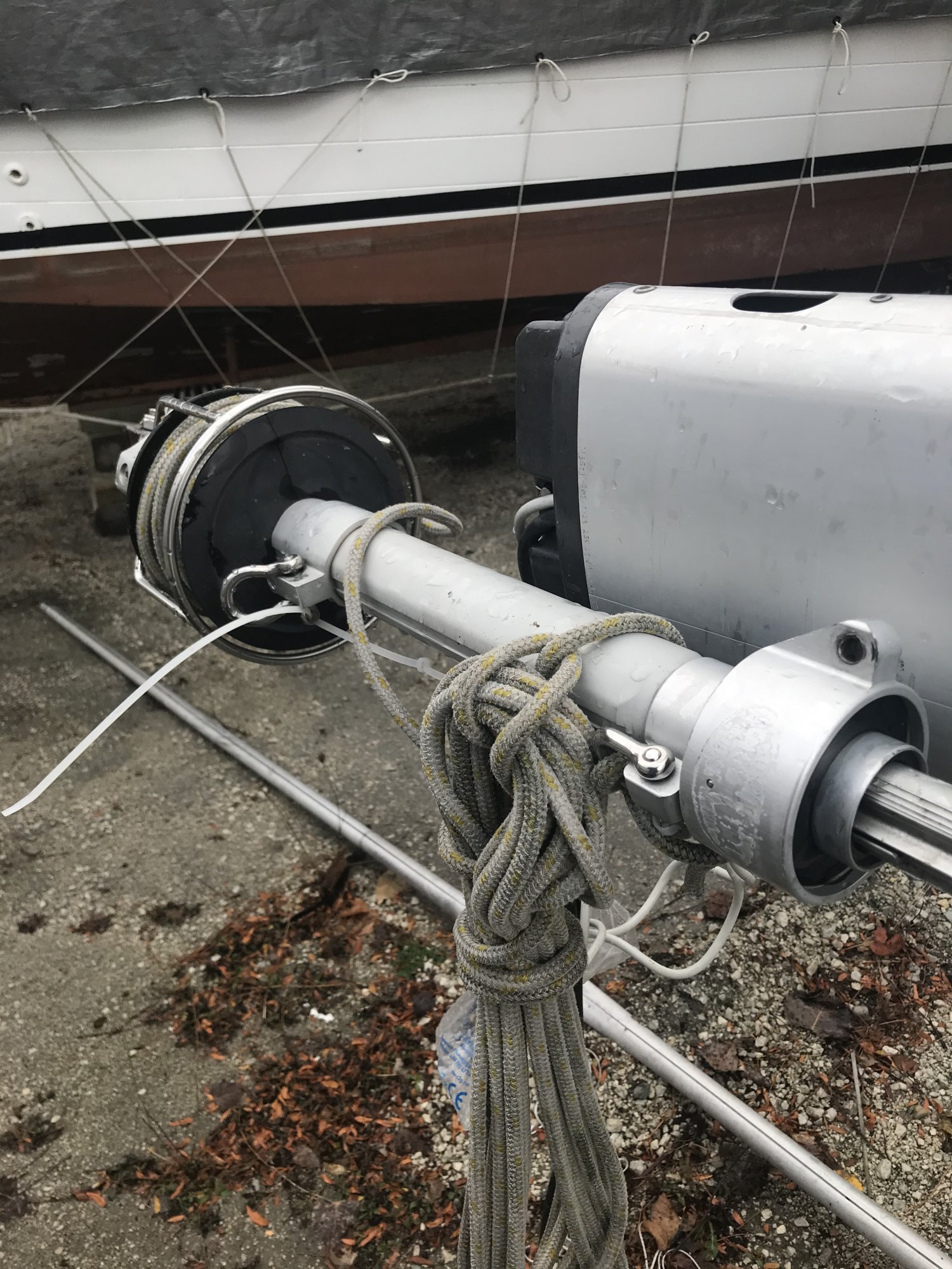

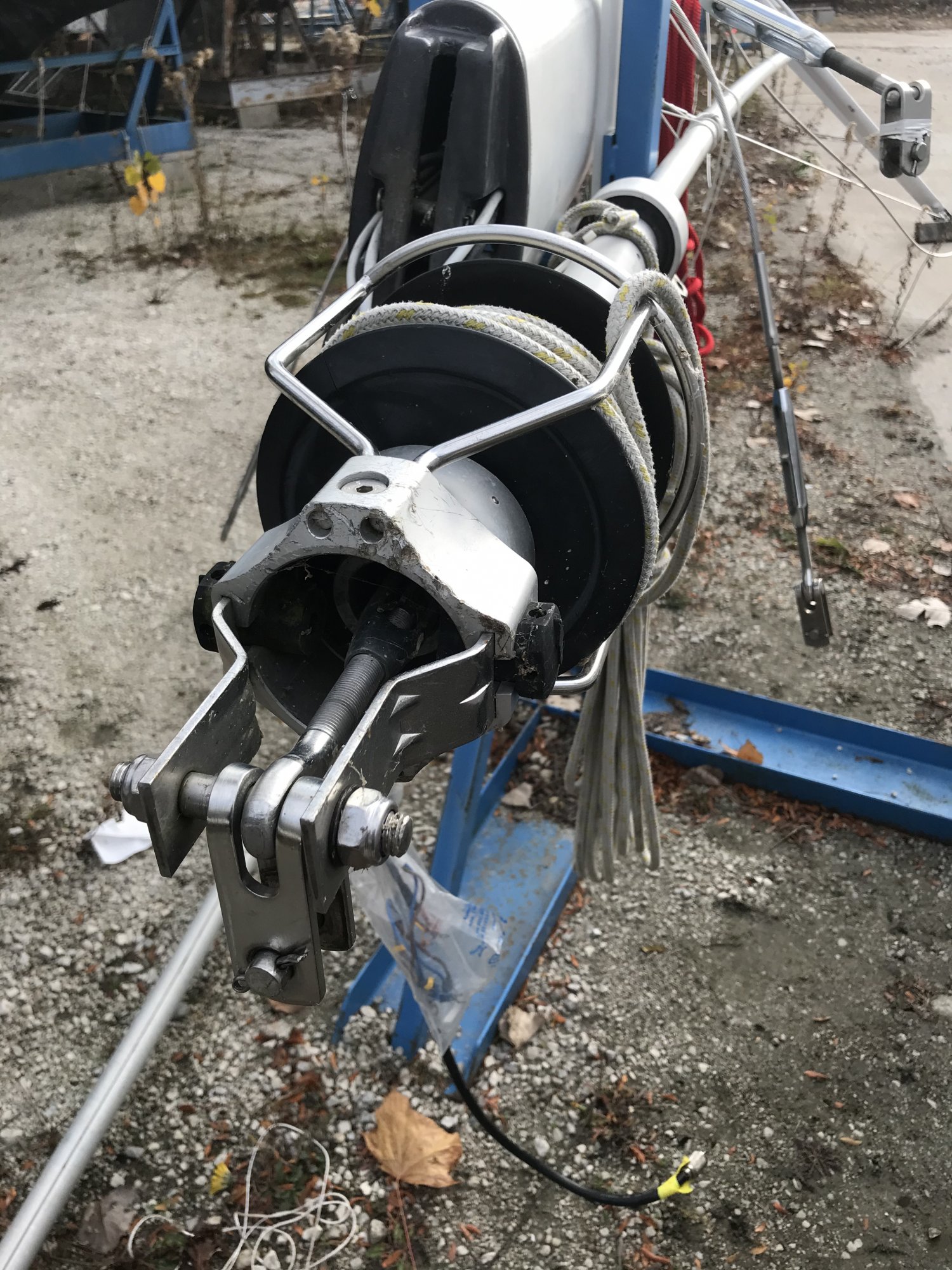

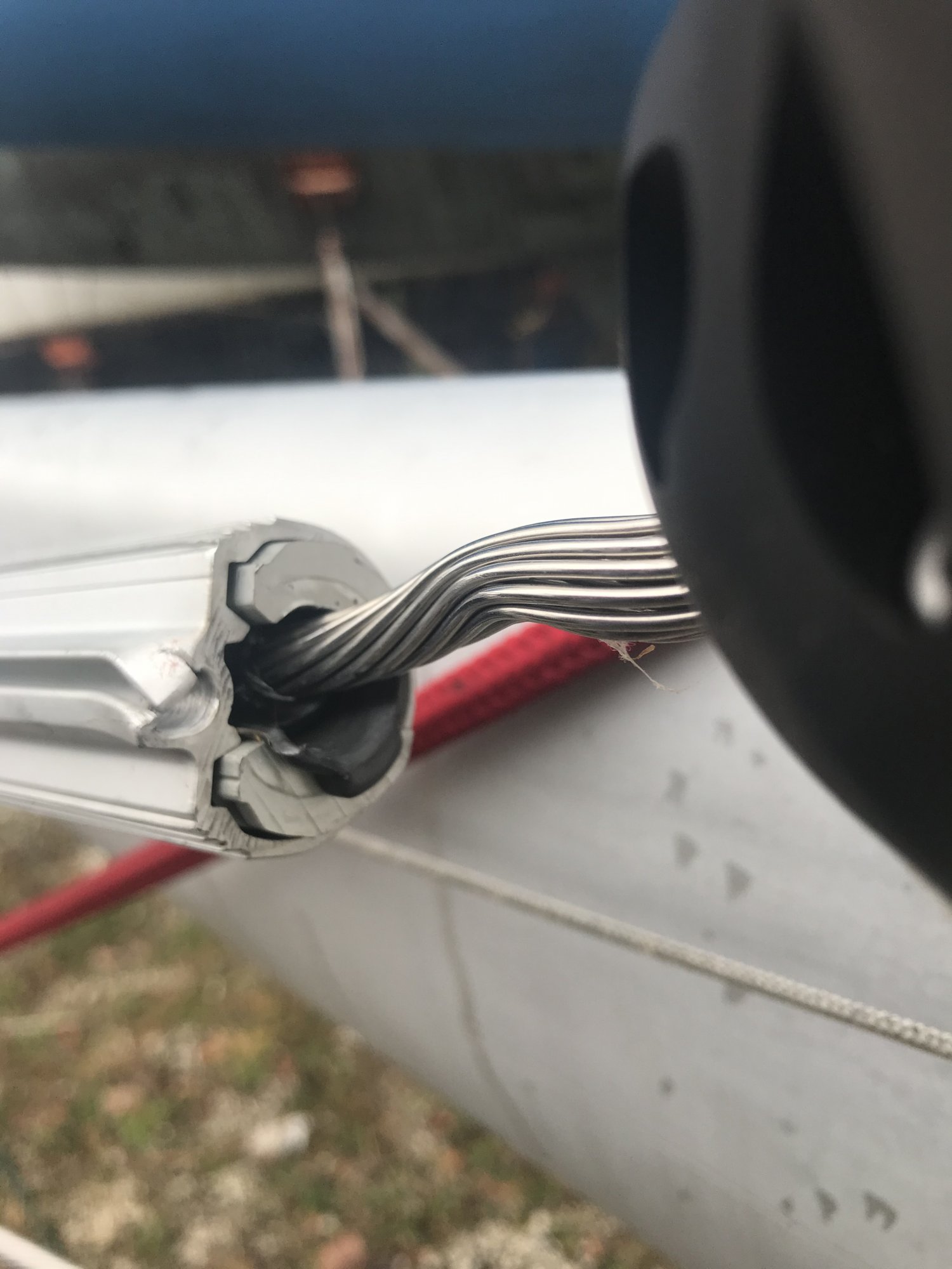

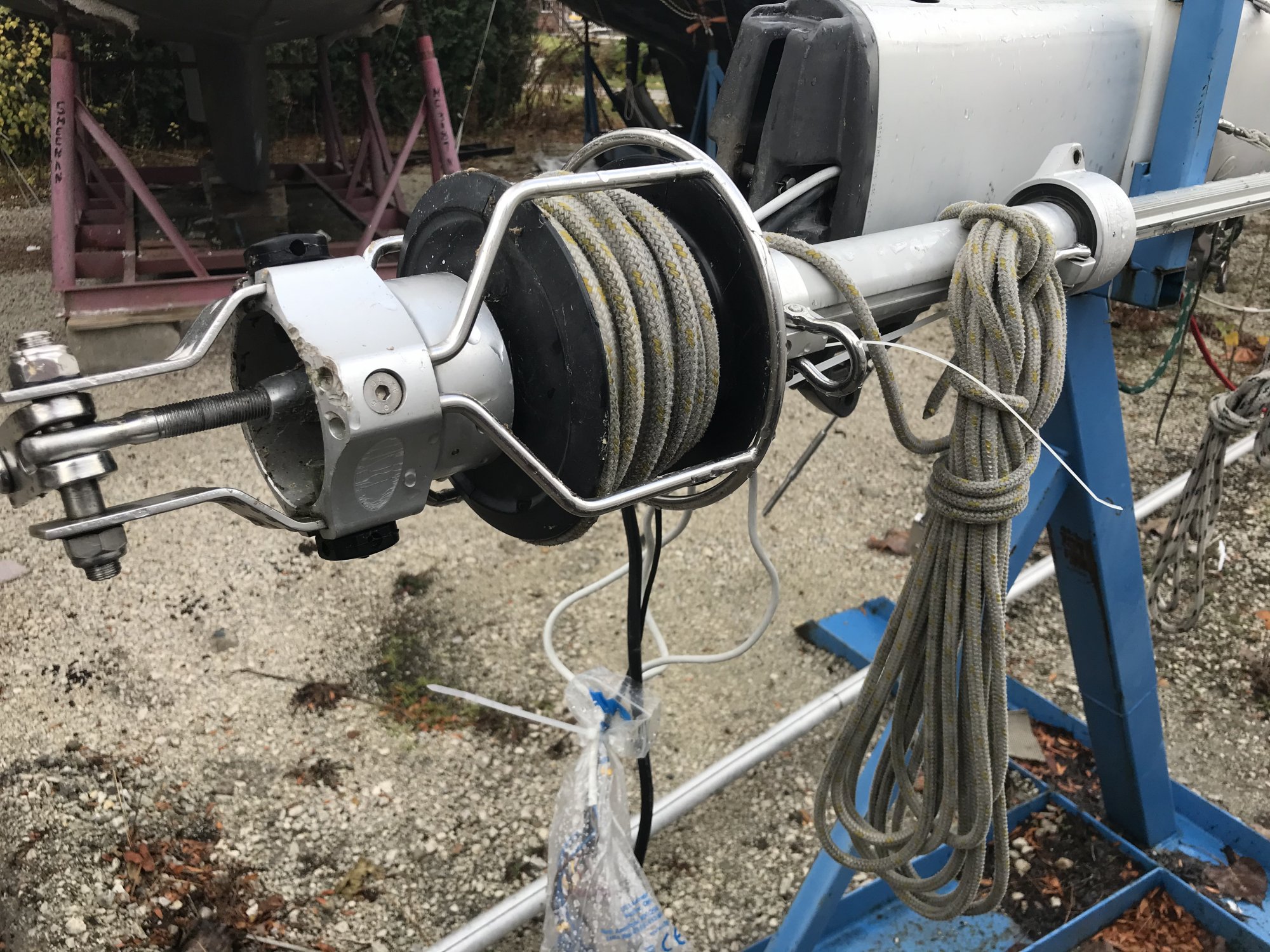

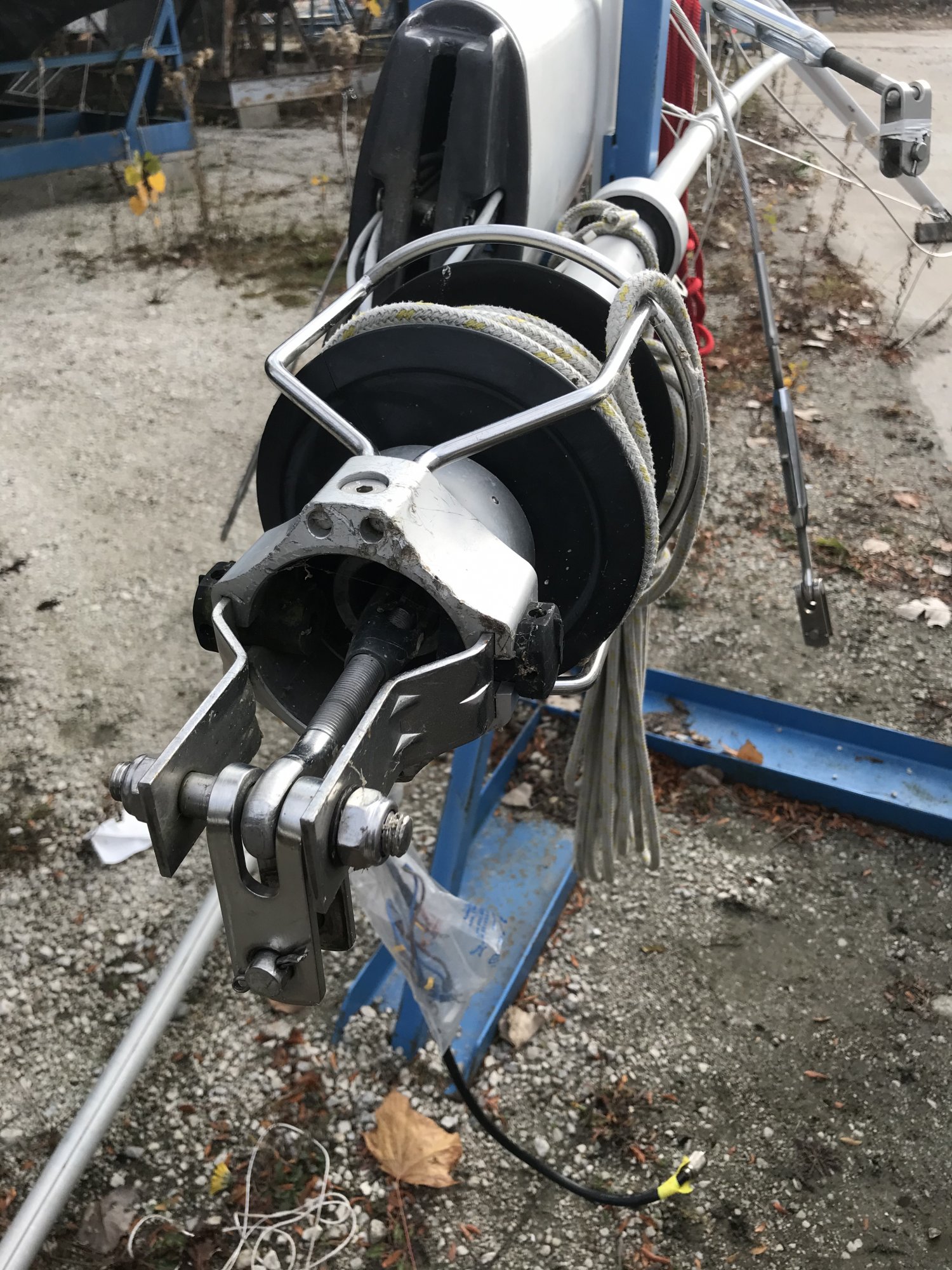

Guys, looking for some tech information on our furler. Looks like there was halyard wrap when we purchased the boat. We have the mast stepped right now, as we had to fix some issues on Selden system. I've had one guy say it may be a facnor. If anyone knows the type and model, it would greatly be appreciated. Then maybe I can pick up a maintenance manual.
6,594

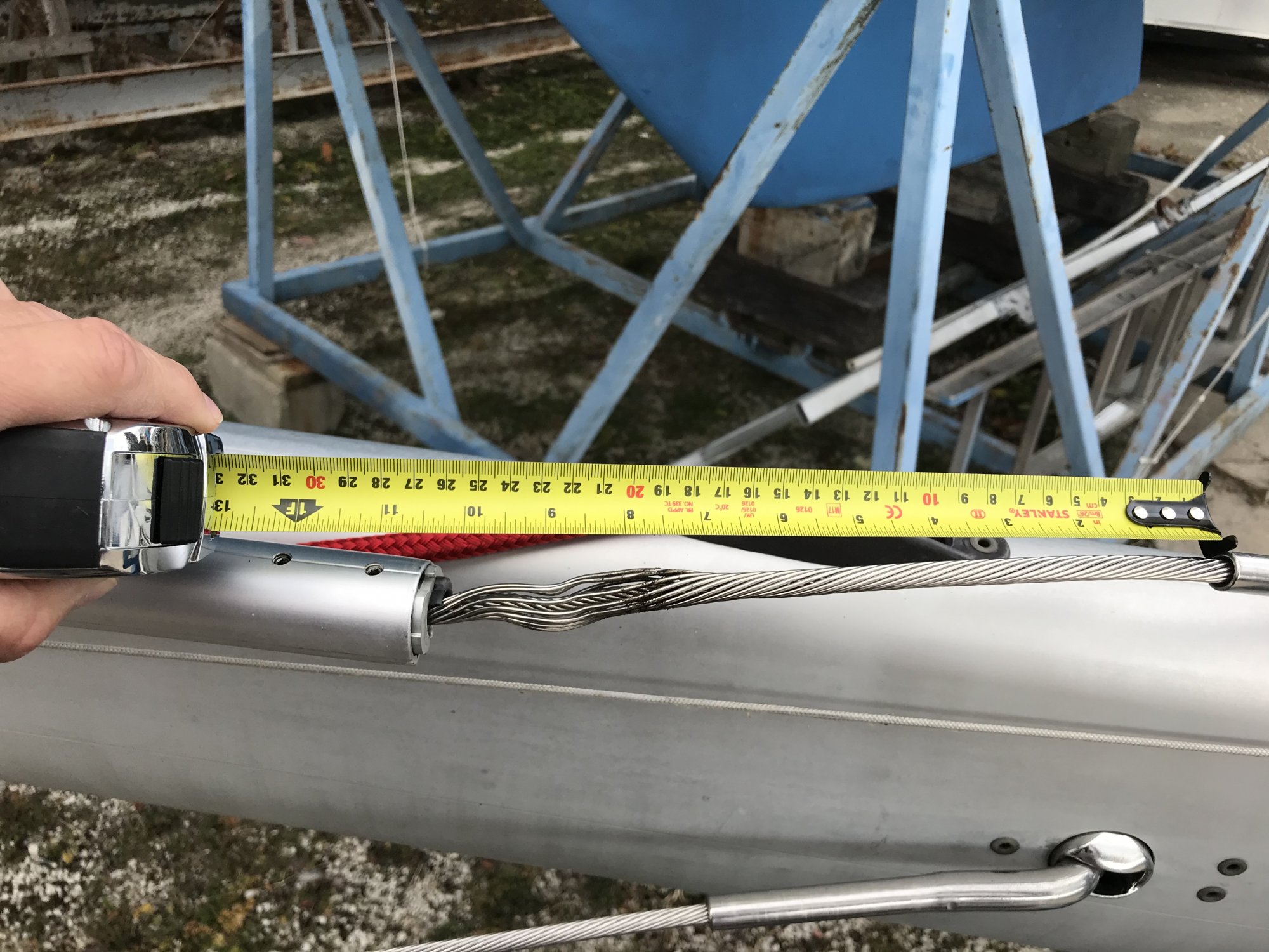

Based on the wire drum cage and the remains of the label it looks like an old Profurl unit. The twist in the forestay looks like ugly. Time for a new forestay and maybe a new furler.

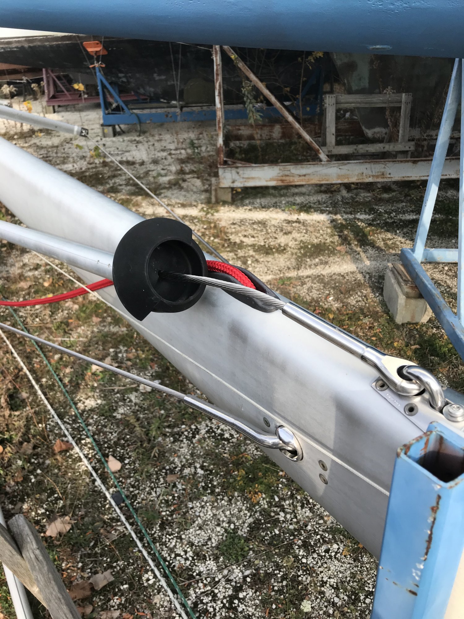

Looks like your top bearing failed aaaand twisted your Headstay 19 strand

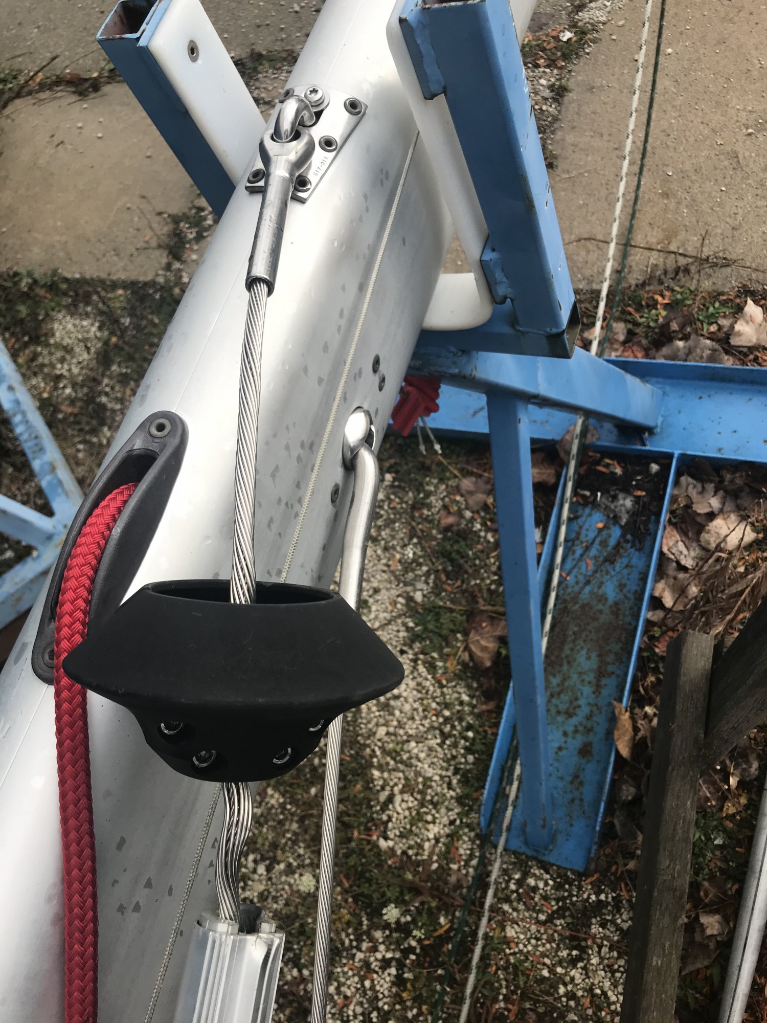

I found some Profurl Basic 35 parts from my Sailboat Broker. Whew. Need some advice. Before removing the foils ( extrusions ) to replace the headstay cable, I need to take a measurement to extend the foil up to the top near the eyelet. I need to leave some room for the Wrapstop ( Hockey puck ). Do I take the extrusion up as close to the Eyelet as possible, or leave it an inch or two below? To remove the Eyelet, looks like there's only one screw. I assume I remove the screw and I will be able to maneuver the eyelet around so I can remove the mainstay cable? Do I have to worry about any nuts or washers on the inside of the Selden mast? Thanks,

The damage to the head stay looks like damage from halyard wrap, caused by the wrap-stop donut being mounted too far down and the extrusion being too short.

That is definitely a Profurl Basic model. You can find technical information here. https://www.profurl.com/images/info_pages/basic-43.pdf.
As that does look like halyard wrap there are a couple of other potential issues. The top connector is either the wrong one or part of it has blown off the top due to over-hoisting the halyard. The top connector should have a slot for a stop washer which you will find referenced on page 9 of that document. With the extrusions as short as they are on your stay there is potential for the swivel to be hoisted higher than the extrusion which would have the swivel on the stay.
On the other end of the spectrum, if your jib hoist is well below (feet) the halyard sheave you will want a pennant between the head of the sail and swivel which will reduce the chance of halyard wrap. Getting the swivel closer up to the sheave will often change the halyard angle to the stay, will actually allow the wrap-stop to engage and do its job and will give the halyard less exposed length, limiting its ability to make it around your extrusions or stay. If you happen to have a picture of the top of the stay with the sail up that will help. Sometimes you can tell where the swivel lives based on wear on the extrusions.
Despite the Profurl systems having a wrap-stop some configurations will do well to have a halyard deflector installed on the mast face so the halyard approaches the swivel at a wider angle to the stay. This is often the end all, be all solution to halyard wrap issues.

Hello Mark and thanks for responding, I appreciate it. I have a couple extra extrusions, so I'll be able to extend the length. Have also located the Stop washer and screw. That should arrive in the next week. Looks like the guy before me did a lot of cheats. 2 screws in 2 different foils are stripped. Great. So, I'm going to cut my mainstay cable so I can remove, take to our drill press and drill out the screws. I'll have to replace with slightly larger set screws, but it should work. I'm running up against winter now. Working outside in 32 or below isn't fun. I'll probably get it all removed this weekend and put it back together in the spring. As usual, thanks all!
