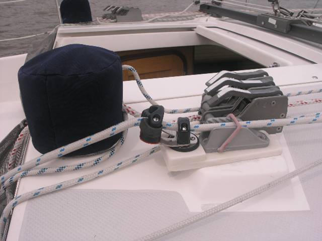

No need to even replace it. Just add a foot plate sandwiched underneath (I used Corian because I had some, marine board would work too) mount a new swivel behind.
Original screws are long enough and if it ever fails you have the original one there as a backup.

Us an open cam cleat
Unscrew you jam cleat, get a piece of starboard and longer screws and re-mount your jam cleat on it and then add the cam cleat aft of that. That way you have the holding power of the jame cleat with the convenience of the cam cleat.

Unscrew you jam cleat, get a piece of starboard and longer screws and re-mount your jam cleat on it and then add the cam cleat aft of that. That way you have the holding power of the jam cleat with the convenience of the cam cleat.
Here is a picture.
