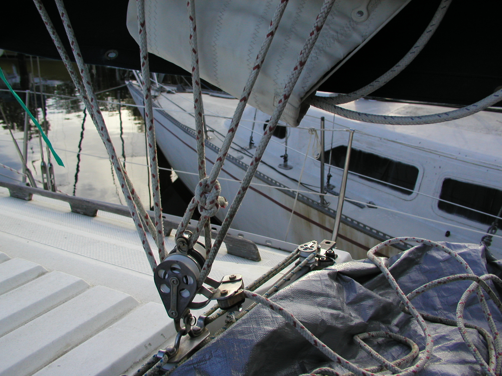

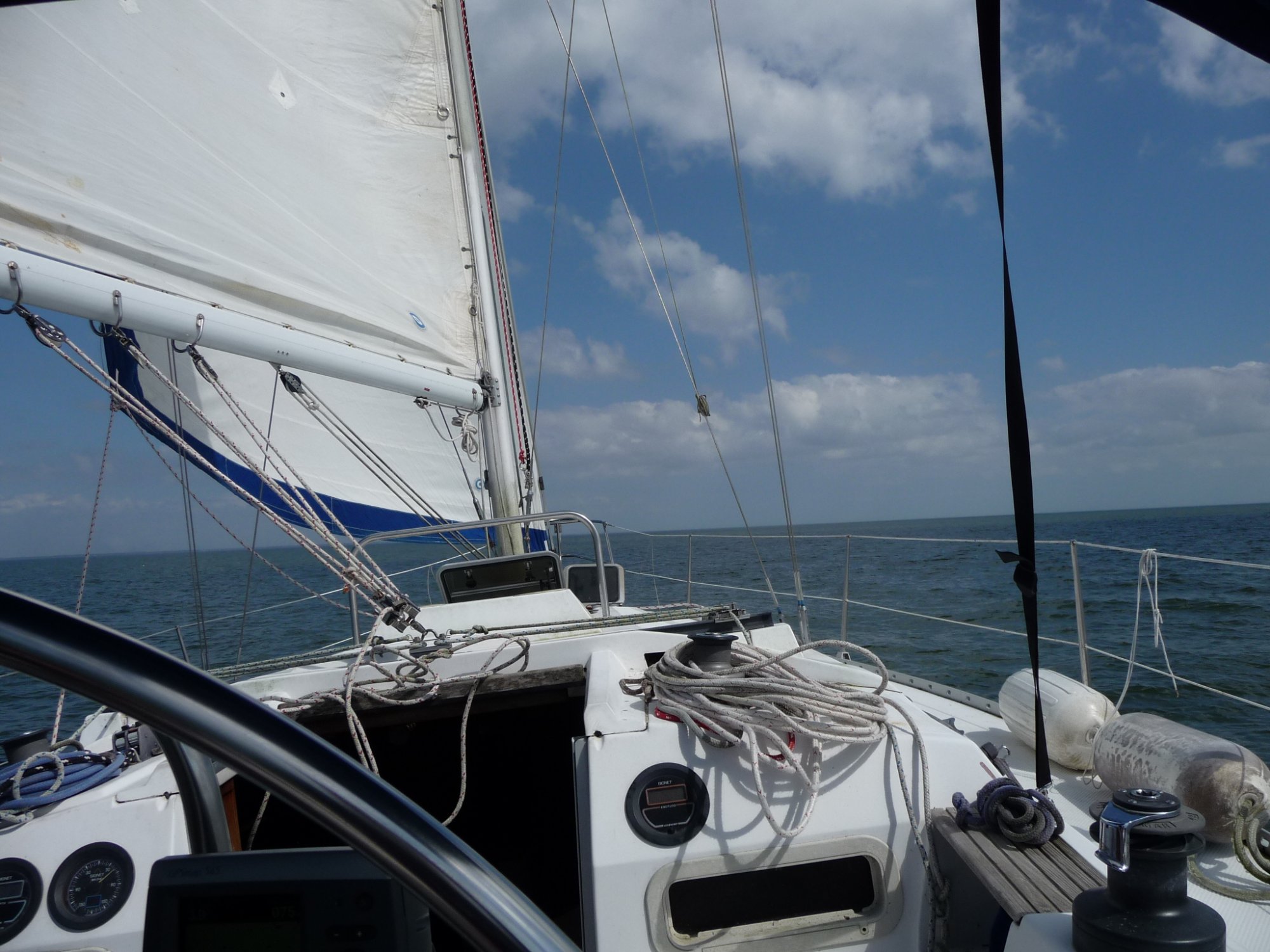

6:1 here as in picture with a cam .. works fine but kind of a reach if singlehanding.

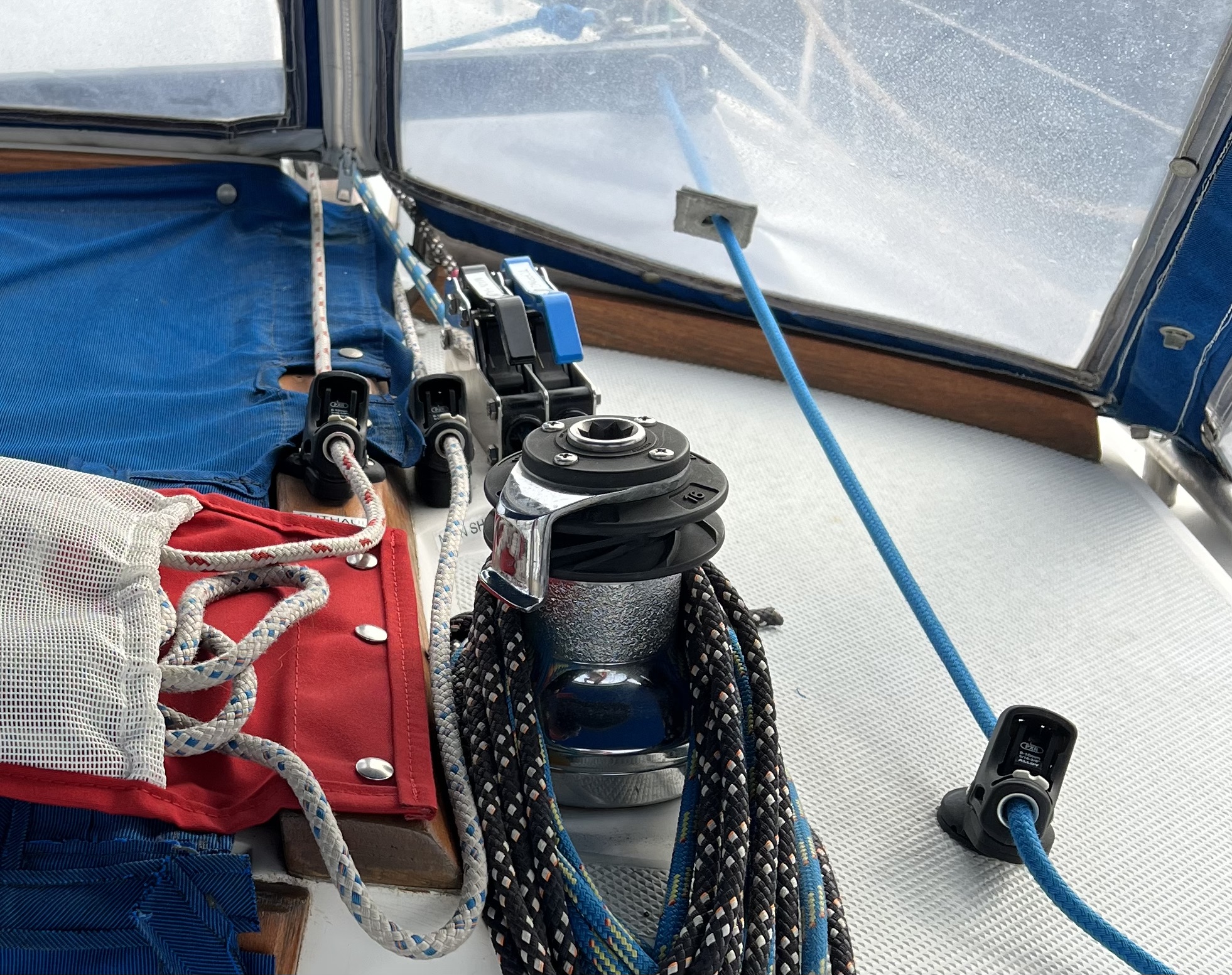

I replaced my cam lock cleats to Spinlock PXR cleats for the main sheet and traveler control lines. Much easier to release under tension.
Found a pic. Left to Right: Outhaul, Main Sheet, Main Halyard, Topping Lift, Traveler
