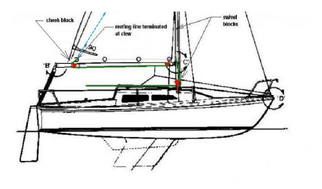

Sailingdog- Is your primary argument one of which angle the reefing line is pulling on the sail from? Forgive me; I should have explained more... This Catalina came with a reefing-specific cheek block pre-installed on the boom. It is in the proper location for the clew cringle on the stock sail. I totally agree that if I were trying to tension the clew cringle from the very aft end of the boom there would be problems. I had to use my outhaul once in a pinch for reefing, and no it did not work well.
I still owe you all pictures, and promise to do so soon. I think it will make much more sense, and it will dispell some of the confusion on this.
I will add, one more time, I am glad I did not waste my time on the system shown in the original post... Thanks to all for the responses.
Oct 22, 2008
3,502
- Telstar 28 Buzzards Bay
Heinzir—
When the sail is in the position of being reefed, the line will be nearly parallel to the boom... and most of the force on the line will be aft, with very little in terms of a downward component, as seen here, unless his drawing does not accurately represent the location of the block in question.
The CYAN line represents the forces on the reefing clew cringle, and there is very little to oppose the upward component on that without the line going down and around the boom. This is basic physics... the loads on the reefing cringle will be multiplied by the fact that there is no downward line, and the sail will likely tear at or near the cringle without it in heavier winds.
If the block is further forward, it may in fact be located in such a position that the reefing line can be terminated at the reefing clew cringle without an issue, but from what I see on the drawings, as opposed to what was just posted by Phil, the reefing line would need to come down to the boom to work properly.
I'd also point out that bringing the line down and around the boom would allow the sail to be pulled down more centrally to the boom and not induce a torquing moment on the boom as would occur with the side-mounted cheek block alone.

Ahh...
Okay, dog, we are really on the same page, I think. As I look to what you have done with the drawing, indeed the cheek block is in a position on the boom that draws the clew cringle exactly to it. I apologize for the discrepancy in the location of the cheek block in my sketch.
My intent for this thread was to look at the options for the line and the path of the line, not the details of block position, else I would have spoken to it. My asssumption was that we all have a basic understanding of reefing and that the standing blocks would be positioned in a location appropriate for the task.
I appreciate your insight, and am glad that we are now to the root of the misunderstanding; rest assured the purchase angle at the clew cringle is appropriate.
So I guess your only real gripe with the enntire thread is that I used my MS paint to illustrate on top of a stock Catalina drawing, rather than firing up my SolidWorks to create a 3D solid assembly complete with accurate materials strength data and FEA stress and loading analysis? Sorry, had I done that I probably would have figured out that I drew the block in the wrong place... my bad..
Here is a modified pic, (still in MS Paint) showing the approximate location of the block.

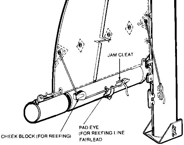

Dec 11, 2008
1,338
catalina C27 stillwater
Here are two pics from the '87 C-22 owner's manual. Apparently even the guys who built the boat make drawing mistakes.
The illustration for the section on reefing shows the fist image. No that block location will not work well, huh? :doh:
The second image detailing the boom pigtail and the vang show the reefing cheek block in an appropriate position with respect to the clew cringle. :dance:
A point to make is that the factory padeye (to tie the reefing line to) on the port side of the boom is in exactly the same location forward/backward as the cheek block.

Thanks SD,
I see that Phil has corrected the drawing to show that the cheek block is directly in line with the CYAN line in your rendition. This is the way I have both reefs rigged on my boat. If I am reading the posts correctly, The difference in Phil's rig, compared to most, is that the reefing line does not pass thru the cringle (or block) and go back down to the boom; it terminates at the cringle. He did this to reduce friction and it seems to work for him.
There would be no torque on the boom if the line went through the cringle and terminated on the other side of the boom. There must be some torque on his one-sided set up but I believe that it is negligible. Remember, we're talking about small boats with no winches involved in the reefing system. His boat is basically the same size as mine and the boom diameter (I'm guessing) is only about two inches. I have had my reef lines pass thru the clew cringles for years but recently added light blocks (attached with shackles and rings as per your suggestions in previous posts) to both tack and clew reefing cringles. Both parts of the line from the aft block come down to the boom on the same side, one end to an eyestrap, the other thru the cheek block. Torque on the boom is definitely not a problem.
Oct 22, 2008
3,502
LOL... that's what you get for using MS Paint...Chaos and confusion. :)
Just didn't want you out there with a reefing setup that might result in a torn mainsail, which is what would probably happen if the block were where it was located in your previous drawing. :) Given what you've said and the revised drawings... I don't see any issue with not leading the line through and down... since you should have sufficient downward force on the cringle.
