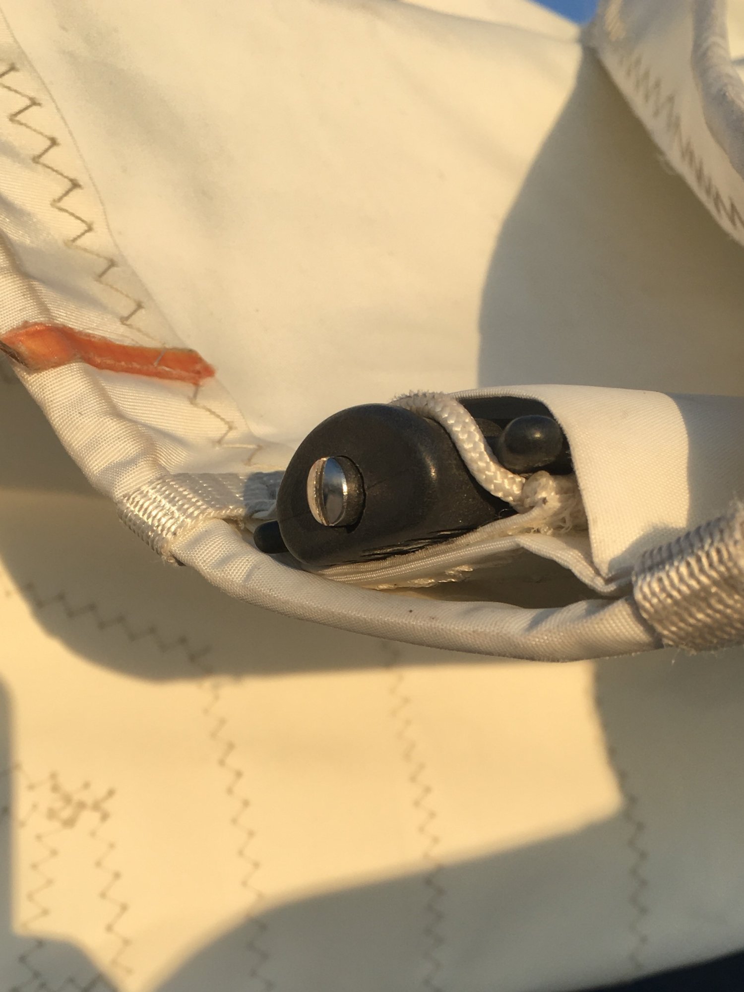

How do you adjust batten tension? Mine are all full and seem shoved all the way in the slot with velcro on the leech.

They are partial battens..... their purpose is to support the leech and will have little effect on sail shape. However, if they don't fit the pockets correctly they might not support the leech completely.... and the only way to correct that is to change them out.... You can buy or fabricate battens to a specific size... but your best bet is to have a sailmaker look at the sail.
btw, If you had full length battens then increasing tension would force an increased draft.. for light air situations. Multi hulls are often set up with all full length battens that can be somewhat easy to adjust... My Nacra 5.2 beach cat, for instance, has 10 full length battens with end cap adjusters that protrude from the leech.... making them easy to access and adjust.

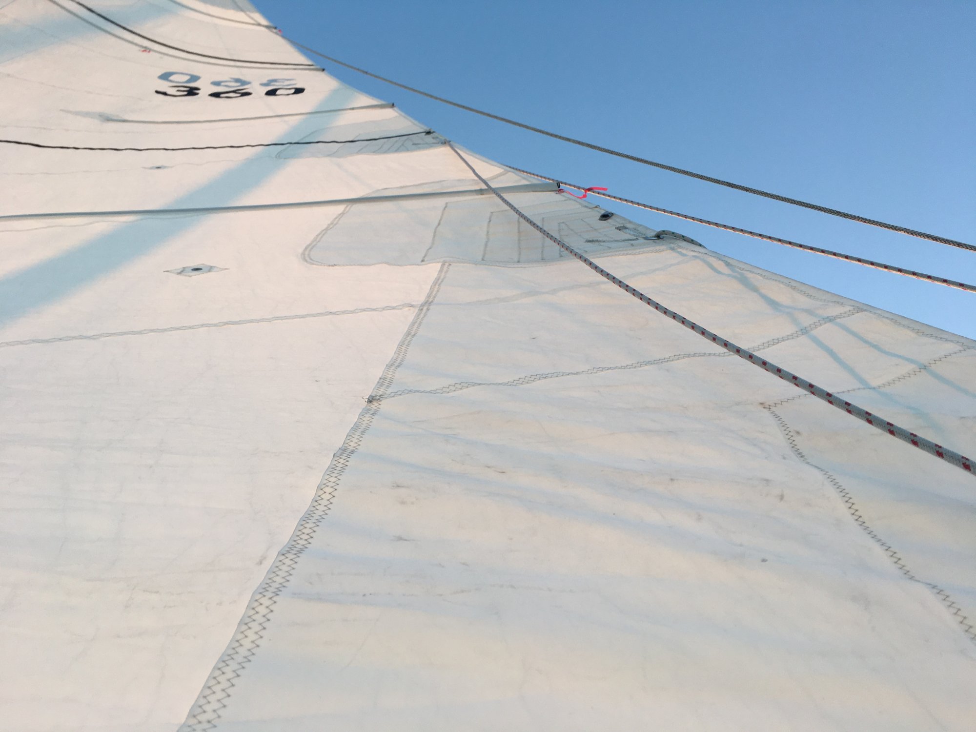

If there is no backstay then I am seeing the topping lift in the 1st photo and it is taught. It shouldn't be. That means the vang is not pulling the sail tight. That does not explain the inflection in the sail as shown in the lower draft stripe. That is usually a result of a blown out sail.
I know it looks like the topping lift is tight in the cropped photo, but it's loose. Here's the whole photo that shows the sag in the line. The vang was eased a little, we had some twist in along with a reef, winds we're close to 20 knots. The two photos that I started the thread with were taken on different days.

Compare the leech in this top photo to the first one in the thread. I adjusted the length of the bottom two partial battens and the leech looks pretty good now. I went all the way in on the adjustment screw, so it's a little too much, needs fine tuning. So, after all the tacks and jibes the screws had worked their way loose and the battens were too short. But, only by a quarter or three eighths of an inch or so, wouldn't think that much would make such a difference. So, the problem wasn't the vang or the leech line or the topping lift or a blown out sail.
