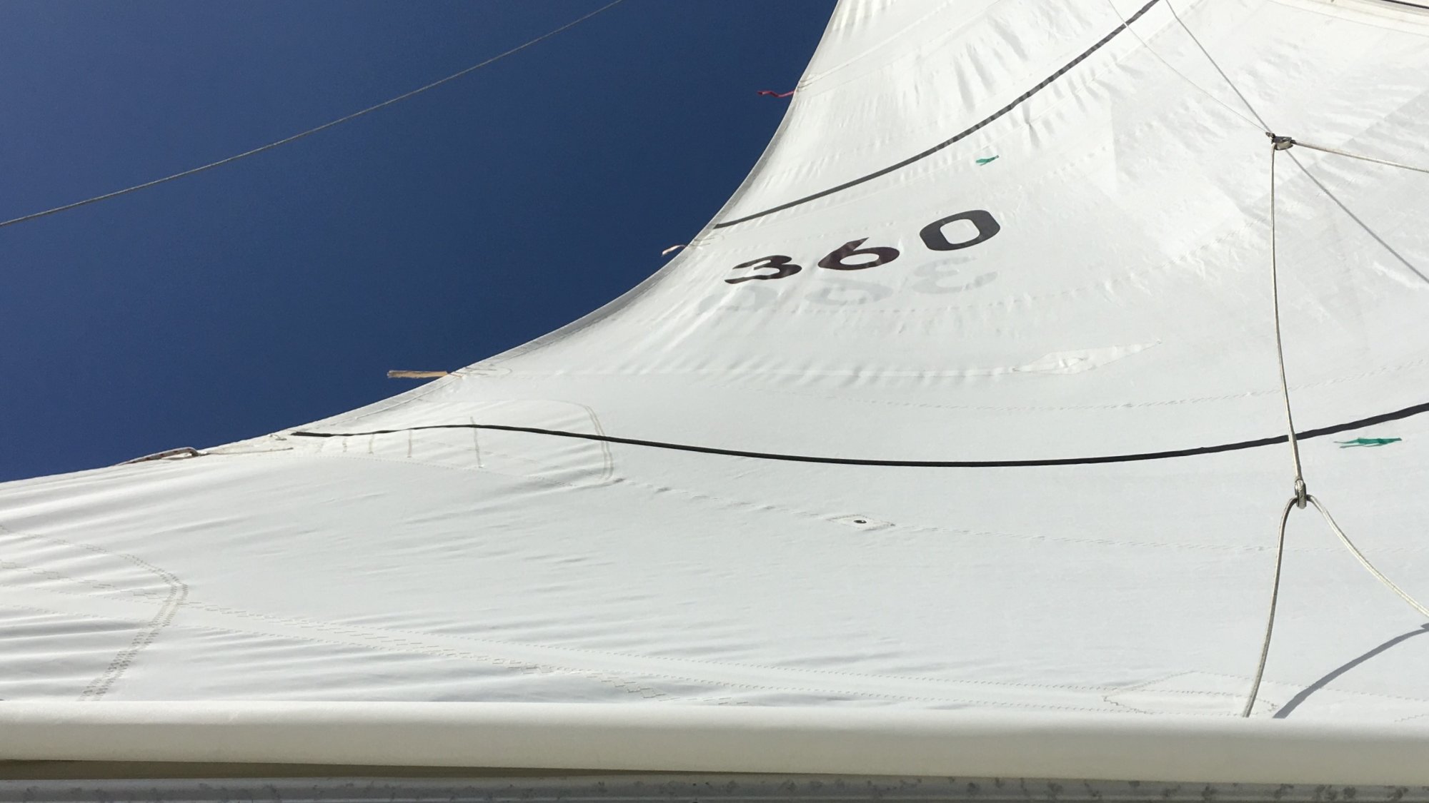

Part of my mainsail leech twists off to leeward. It's very noticeable since it's right at a draft stripe and reef reinforcement. Sail is 3 or 4 years old. Leech line is tight and battens seem okay. What do I look at next? Are there other trim adjustments or is a repair needed?

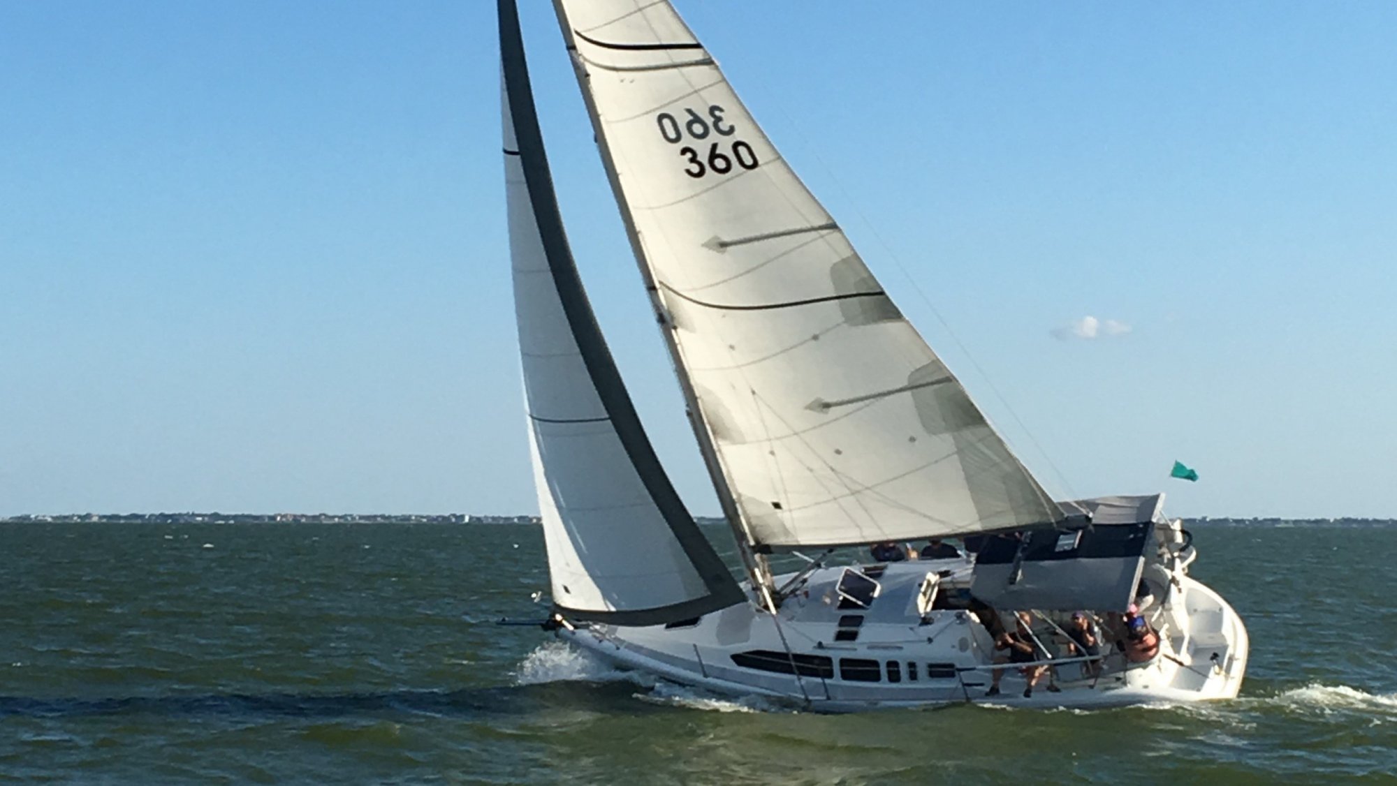

Hard to totally tell, but your mainsail draft is further aft than your headsail. Tightening the mainsail halyard (or cunningham, if you have one) will bring the draft forward, which might help. Obviously you are sailing in a stiff breeze given the way you are heeled over.

Seems like you might have extra or stretched fabric along the leech which may require re-cut by the sail maker.
Picture looks like a lot more than the 15 degree heel recommended by the designer...although I really like your race videos.

Have you ever used that third reef point, or do you know if a previous owner may have? It looks to me like the cloth is stretched right there allowing the extra to fall off.

Good point, it’s the second reef and I have never used that reef and I bought the sail new in 2016. To me, it seems like something is stretched or distorted, but it’s right at the reef reinforcement that should not stretch or distort.
Top photo is from last Saturday, with the first reef in. Bottom photo is a couple weeks ago in a race when we got caught with too much sail up when the wind increased.

The leech line looks a little tight, that will cause the leech to curl to weather.
In the second photo the topping lift looks like it is still attached to the boom and is tight. This is lifting the end of boom up, reducing tension on the leech. With less tension, it will slack off to leeward. Take the topping lift off or loosen it enough so that it flops around.

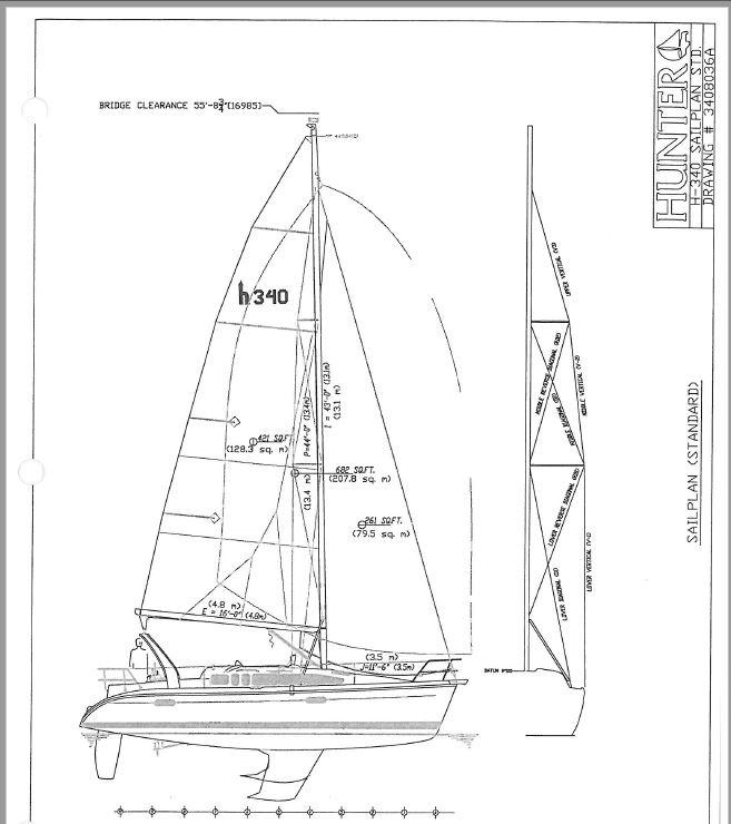

This Hunter sail plan shows how the boom should angle up to give the arch plenty of clearance.
