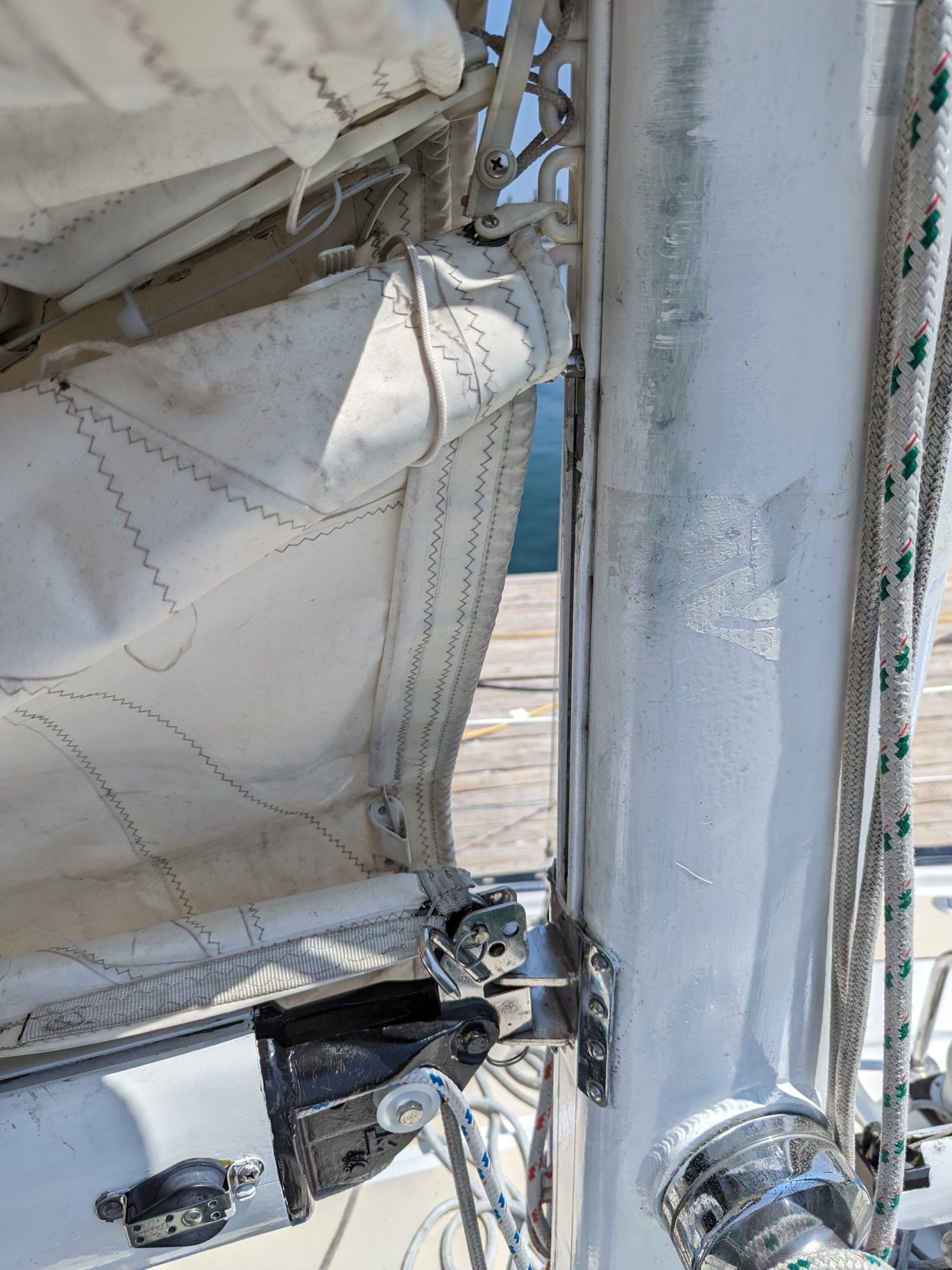

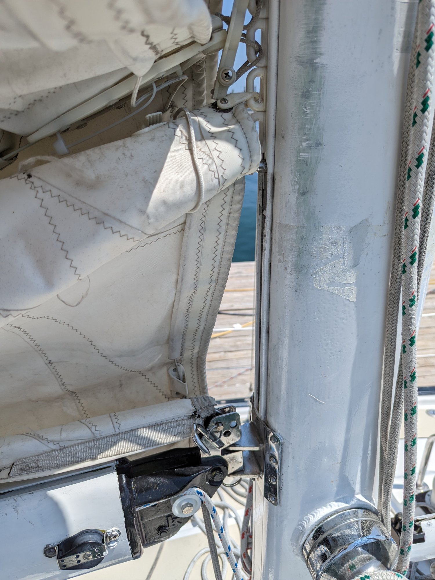

On my 37C, 10" above the boom, the track is open on one side to insert the sail cars. The stop sits just above this which means when the sail cover is on, it sits 10" higher than it could be. If I move the stop down, I risk having the cars fall out of the track. This seems wrong. Am I missing a piece that closes the feed gap or something?

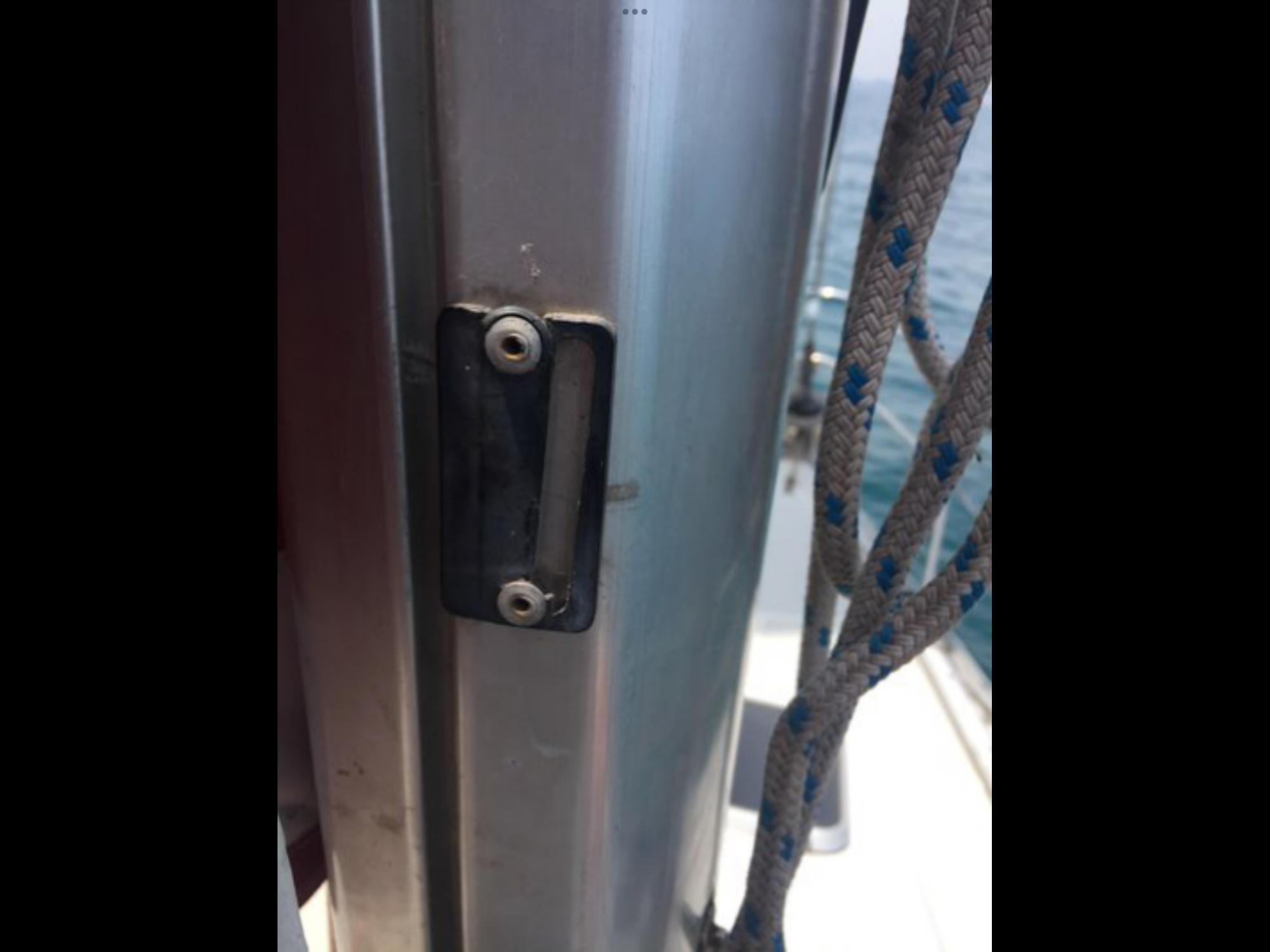

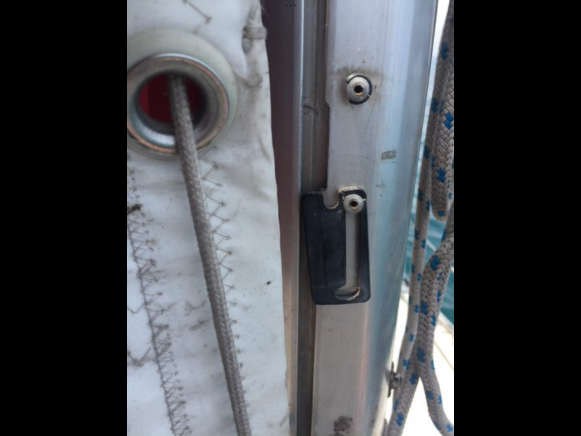

On my O’Day 322, with a Z spar, my mast gate had a plastic plate that would close off the opening. It was riveted to the mast, but had a long hole in it, so it could move up and down the mast to open or close the gate.
Here is a photo with it open and closed.
I have since added a Tides Marine Strong Track, so I removed the gate.
Hopefully this gives you some ideas.

Any chance you could post a photo?
This seems to be the answer whether I make when or buy one. I'm surprised it didn't come with something there for this.
Thanks!
