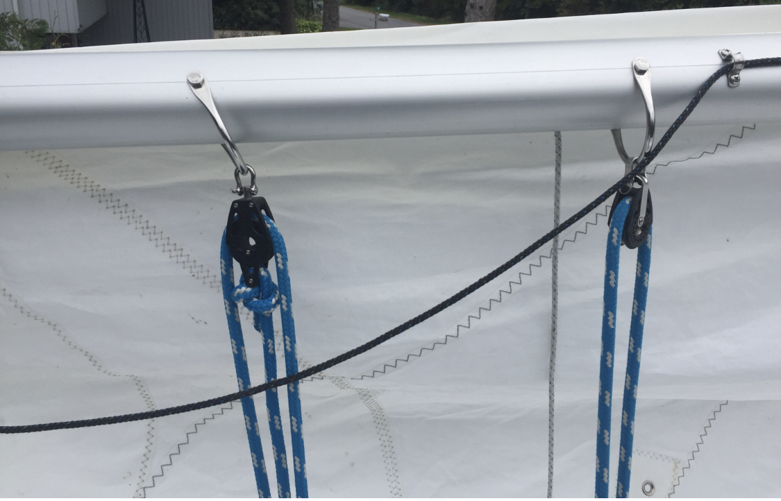

Photo for reference
I’m not sure why Henderson designed the boom connection this way, perhaps to not overload on a single point on the boom???
Curious about why make the change though?

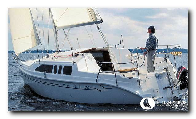

My H26 has the single block on the boom that you are suggesting.
Here is a stock photo of the H 260 with a similar setup

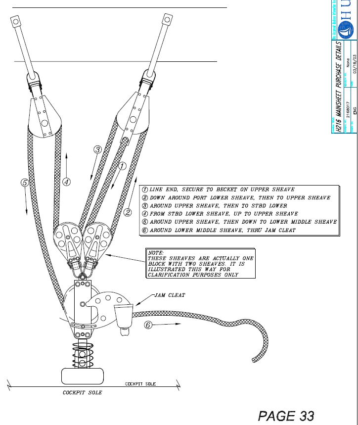

Thanks for this. I started drawing this out and am stuck trying to understand the part I quoted above.
I have mine rigged as per the manual and the mainsheet starts at the becket of the block on the boom, not on the deck?? Also not clear about the return path from the turning block on the ring?
