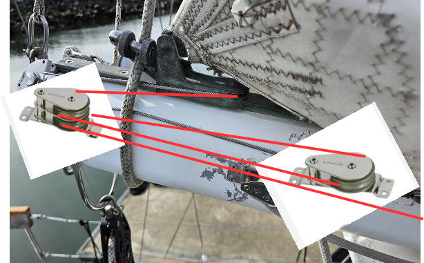

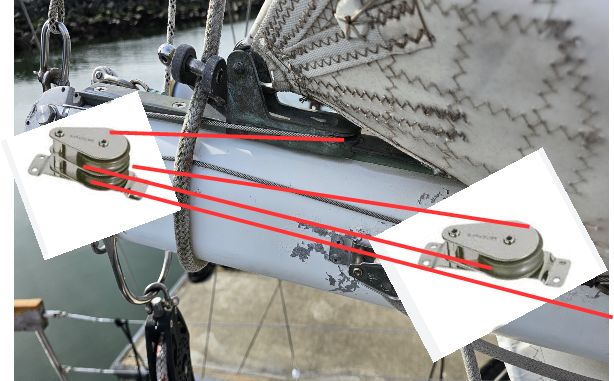

I will tackle the outhaul first.
There is no way that what you have will give you tension.
I would make start by replacing the sheave in the clew car. Is there actually a sheave in there?
Fit a double cheek block at the boom end and a single cheek block in a suitable position.
This will increase your purchase , which is essential for outhaul tension.
Make up a 6mm dyneema line(red line in illustration) to 8 mm double braid and move the horn cleat closer to the mast as you plan.
The dyneema should be as long as possible to avoid stretch.
The red line indicates the dyneema . It will have an eyeslice on the boomend end and be spliced to 8mm braid at a suitable length.

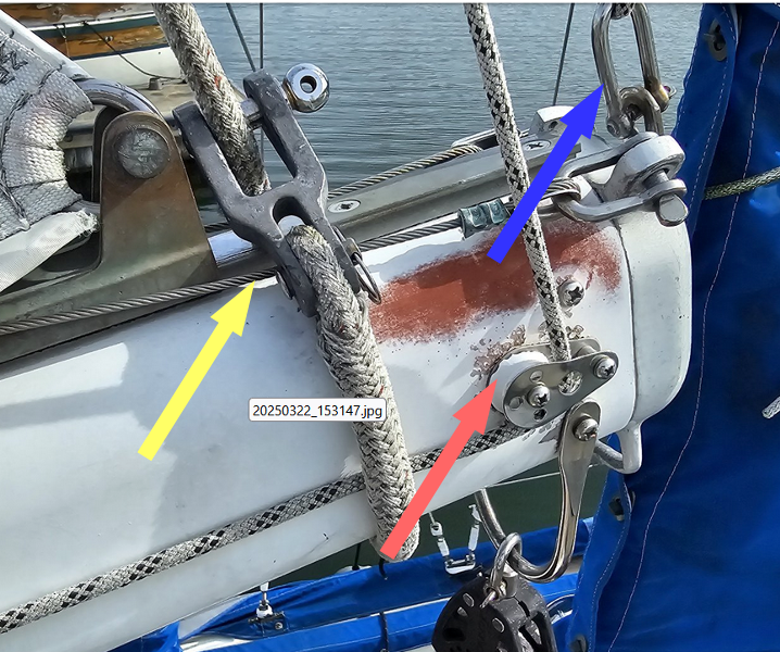

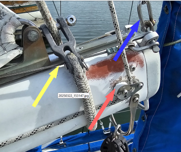

Topping lift
It looks like you have a spare halyard wrapped around the boom acting as a topping lift (Yellow arrow) and a standard topping lift fitted to the boomend (blue arrow)
What is the function of the red arrow line?
No, that yellow arrow just points to the main halyard. When parked, this is how we keep the halyard to prevent it from banging on the mast. The red arrow points to the "V" bridle portion of the topping lift. It runs to the left to a cleat, and it runs up from that cheek block to the block at the top of that "V".
Thanks for the great advice. What you recommend is pretty much what I was thinking. To answer your question ... I don't think so. I just assumed not, but I guess there could be one in there. If there is, my hunch is that it was last serviced in 1975.

Good morning Foswick.
RE;No, that yellow arrow just points to the main halyard. When parked, this is how we keep the halyard to prevent it from banging on the mast. The red arrow points to the "V" bridle portion of the topping lift. It runs to the left to a cleat, and it runs up from that cheek block to the block at the top of that "V".
I see.
FastOlsen has recommended a spring vang. That will do the job (expensively ).
But as a tight a#se I would go a new cheek block. (easy fix).
I have my topping lift coming back to the cockpit. (blue line in illustration).
The reason for going for a topping lift is that I can haul my boom up high to give me headroom.

If you fit two cheek blocks as indicated to the boom, it will not make a purchase. for a purchase system, one line must be fixed and the other must be moving. I increased the 3:1 purchase on my Catalina 30 to 12:1 by adding in a couple of single blocks to make two cascades. Here is the diagram of the modifications.
Apr 25, 2024
828
In the diagram that Gary provided, the end would be attached where the wire rope currently anchors (The shackle barely visible on the port side.) He just couldn't really show that clearly on the photo I provided.
But, yes, it is still only a 2:1 purchase, just like the original setup, but with more moving parts. It looks like it would increase the advantage, but since there is still only one movable pulley (the sliding car), the actual advantage is still 2:1.
Your suggestion certainly increases the purchase. The key is the fact that you multiply mechanical advantage by chaining systems of movable pulleys. I think I will ultimately go with a simpler version of this, but still one that chains systems.

For the outhaul, I think I might end up just attaching that wire rope to a low-profile fiddle block. That will give me 8:1 purchase with pretty minimal modification. Then, if I decide to completely overhaul this fall, I haven't really done anything permanent that I would have to undo. I probably have all of the parts for this laying around, and it would be a quick-win improvement.
Likes: Hayden Watson
24,926
Do you need an 8:1 purchase on the outhaul for a sail that is about 190 sqft?
There is nothing troublesome about adding such power. I wonder if the power is needed.
Apr 25, 2024
828
No, I definitely don't need that kind of purchase, especially since I don't really fuss with outhaul adjustments much. I just happen to have a suitable fiddle block on-hand.
