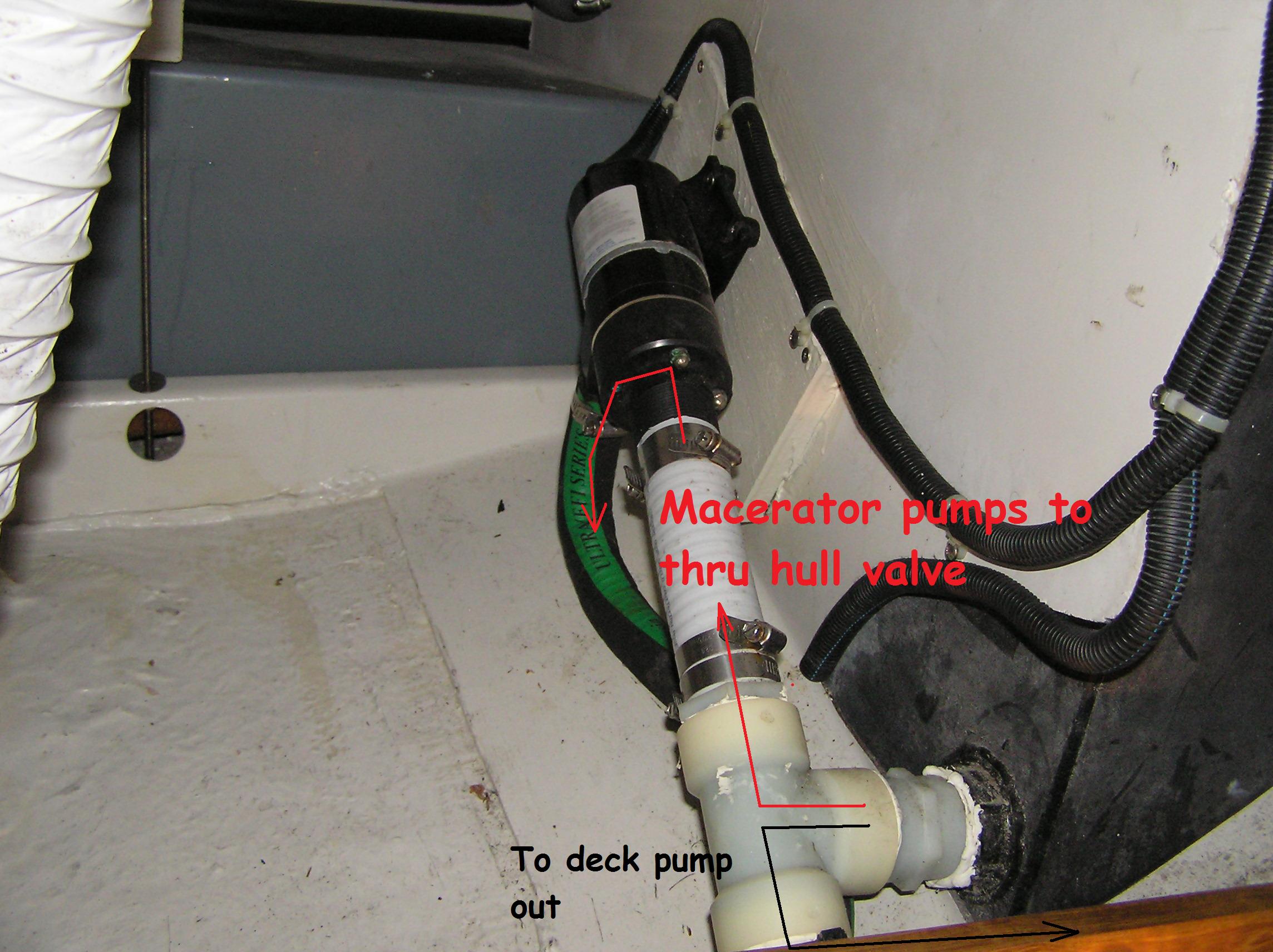

Looks to me like there's plenty of room for the SeaLand pump. It wouldn't be a "plug and play" replacement, though...you would have to replace the plumbing to it and from it to the thru-hull. A bit of a PITA, but WELL worth it IMO. Check Fisheries and Marine Sanitation (that's a company name http://www.marinesan.com/) in Seattle.

Well, yes, it could be fit in. But then one couldn't fit in that space to gain access to:
- The fuel tank
- The steering cables
- The hot water heater
- The battery charger
It is real cozy in there

When I get to hauling out the new to us boat I will replace the 1 inch thru hull on the macerator so I can add a diaphragm type pump with a much larger opening. Pumping out takes so long the macerator motor actually gets hot to the touch. I am really disappointed that Catalina didn't see fit to put a large enough thru hull to allow a quicker pump out. The pump doesn't take up any more room than a macerator. My electric toilet provides the macerator function so its a duplication as far as I am concerned.
The thru-hull is 1" because 1" is the size of the discharge port on the macerator pump, which means the discharge hose has to be 1" and so does the thru-hull. That's not the reason for slow pump out....if it were, everyone who has a macerator pump would have the same complaint. Low voltage to the pump is the most common reason for sluggish discharge from macerating toilets and pumps.
A worn out impeller is another reason. Every time an impeller pump starts, it runs dry for the couple of seconds it takes to prime...that wears a minuscule amount off the edges of the impeller vanes each time. And the "looser" the impeller is against the inside of the housing, the less efficient it becomes. So first check the voltage to the macerator pump...if it's getting a full 12v, replace the impeller.

Forgot to include a reminder that any time you check voltage to any electric pump (ANY electric device), always put the volt meter on the pump while it's running.
Re the impeller: it's also possible that there's a cracked or broken vane. Waste is sticky...so unless a macerator pump is rinsed out after each use, the impeller sticks to the inside of its housing. Resulting in a "hard" start or even may require using a screwdriver to free the impeller. That puts stress on the impeller vanes that can crack one or more or even break one...which is why it's a good idea to replace the impeller every year as part of spring recommissioning...'cuz no one EVER finds out that the macerator pump is no longer pulling anything out of the tank when the tank is empty,

I replaced the macerator with a new one when we took possession of the boat a month ago. Although it pumps fine and did a great job emptying the waste tank, it is still slower than my old whale gulper pump I had on my previous boat. I wish to replace the macerator with a diaphragm pump when I finally haul out and with that comes the requirement for a larger thru hull and at the same time I'll put a shut off valve between the tank and the pump to allow for pump maintenance without the need to pump out first. It's all part of making the boat what I want in terms of convenience and maintainability with me. I'll be pulling the sensor out of the tank as soon as the hot weather breaks here. (it's not something I will do in hot weather). I am assuming that the sensor is coated based on the history of the boat and I'm not sure that doing the ice cube trick will have much of an effect. I have done worse having been an aircraft technician for so many years. There is nothing fun about blue juice problems. LOL*

I still think you should check the voltage to the macerator...according to the specs, it should move 12 GPM. with 0 head...10 gpm with 3'. Jabsco Macerator Pump owner manual I don't THINK your old manual Whale even came close to that.
