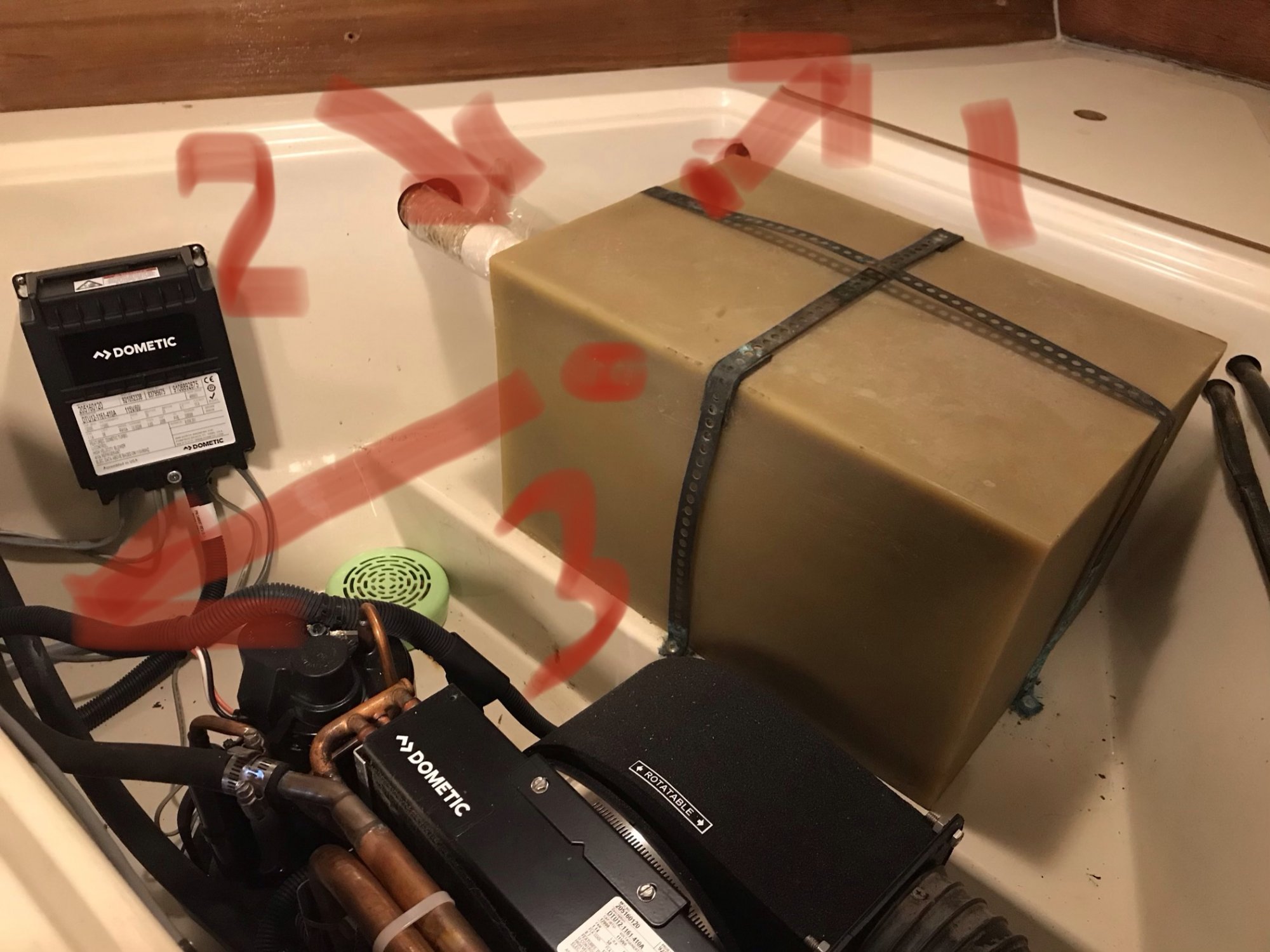

The tank is centerline under fwd V berth with only 1” clearance on top of tank with current setup and 14 gal tank.

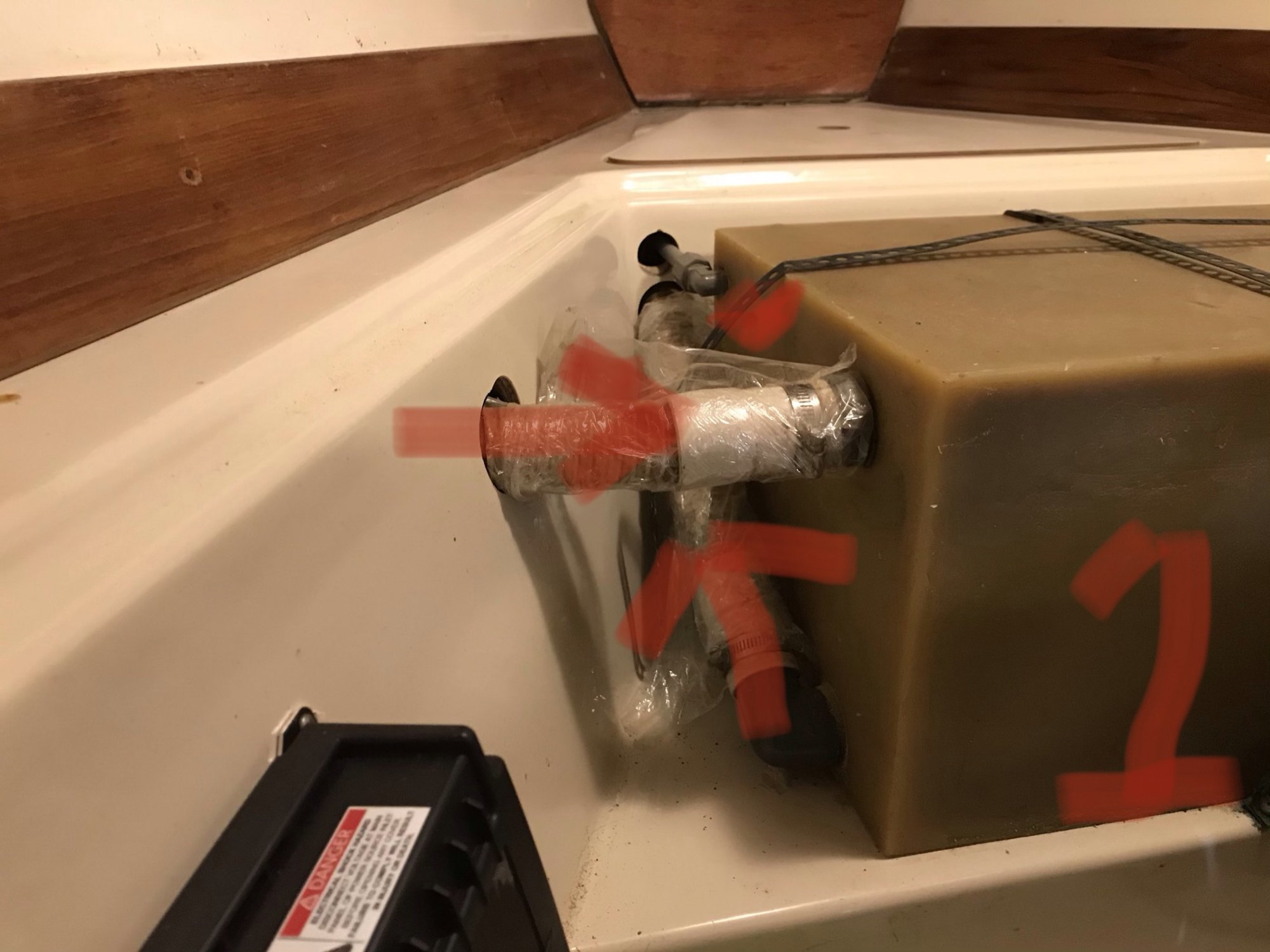

Think I will have both ingress and egress waste lines plumbed into the tank side (not the top) then elbow internally to a vertical standpipe for discharge pickup. (Photo 1 shows ingress and egress lines currently with red arrows and I’ll have the egress line raised on the side as indicated by the red dot).

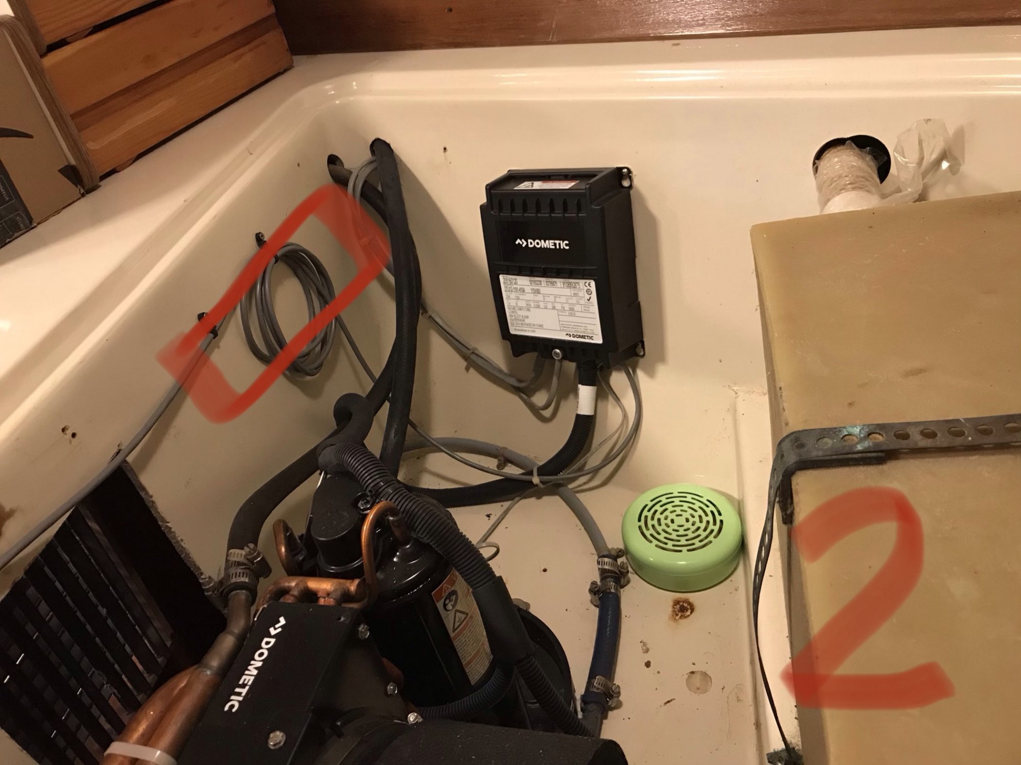

I’ll mount the Dometic T pump horizontally on the compartment bulkhead just aft of the tank (red box in photo 2).

#1 arrow is deck pump out line
#2 arrow is waste ingress line into tank direct from head
#3 arrow is waste discharge line to the pump then to thru hull
All tank fittings will be as high on the tank side as possible. (Not enough clearance to have the openings on the tank top)

It looks like you may have room for a somewhat triangular shaped tank, 'cuz there's a good bit of space on both sides of the tank in your photos...and spreading it out a bit may lower the height enough to give you the clearance you need to put the fittings on the top of it. As you go through the drawings in the Ronco catalogs, you may not realize that tanks can be oriented in any direction 'cuz there is no top or bottom until the fittings go in, and you decide where they go. So rotate, flip end-for-end, front-back...you might be surprised at all the options you'll find.
I just realized that you neglected to include a vent fitting in your list. Vents are essential! It should be 1", which will require replacing the vent thru-hull with an open bulkhead aka "mushroom" fitting. The provides much better air exchange and also lets you prevent vent blockages by sticking a hose nozzle against it to back flush the vent line every time you wash the boat. All the details are in my book.
