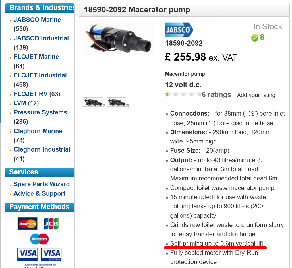

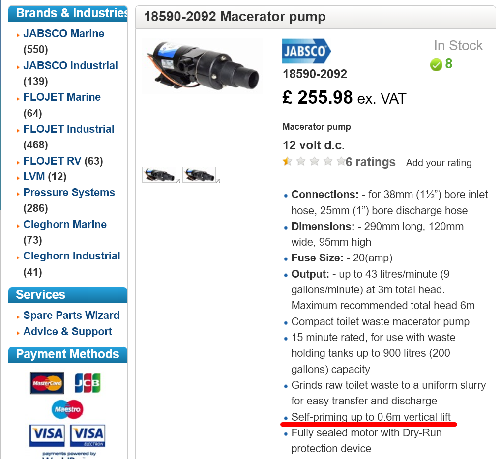

Looking at the limit for self priming, this is 0.6m = 23.6 inches. And usually this is wishful thinking for an impellor type pump on the part of the manufacturer. You mentioned that the macerator sits about 18-24" above the top of the tank but how far above the water line in the tank is the real question to ask. If the tank water level is 10" below the top of the tank, you may now be trying to pull something up to 30" which the pump just can't do. I think you may be a little too high for the pump to lift in order to prime the pump.
Unfortunately, both the "T" and the macerator will have to be lowered to just above the level of the top of the tank for this to work. Calculate if you have a small enough suction head when the tank is near empty for this to work,
This could easily be the issue and might be worse than @Ralph Johnstone suggests as the pump draws from the bottom of the tank. It will get a slight boost when the tank is full because of the head in the dip tube, however, as the level drops, it loses that head and has to lift ever higher which it can't do. Add to that the back pressure from the pump being below the waterline and it will just sit there spinning its macerator.
