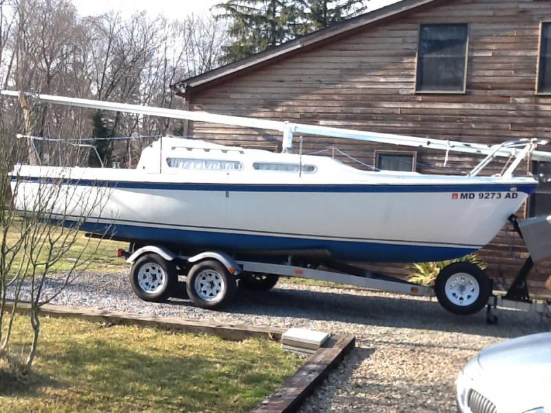

Take the rudder off when trailering. Buy another pair of rudder pintles, and attach them to a 2x4, and put the assembly in the gudgeons on the stern of the boat. make a v-shaped end for the 2x4 to hold the mast.
Likes: rgranger
12,557
:plus:That is exactly how my old Mac 22 was set up.

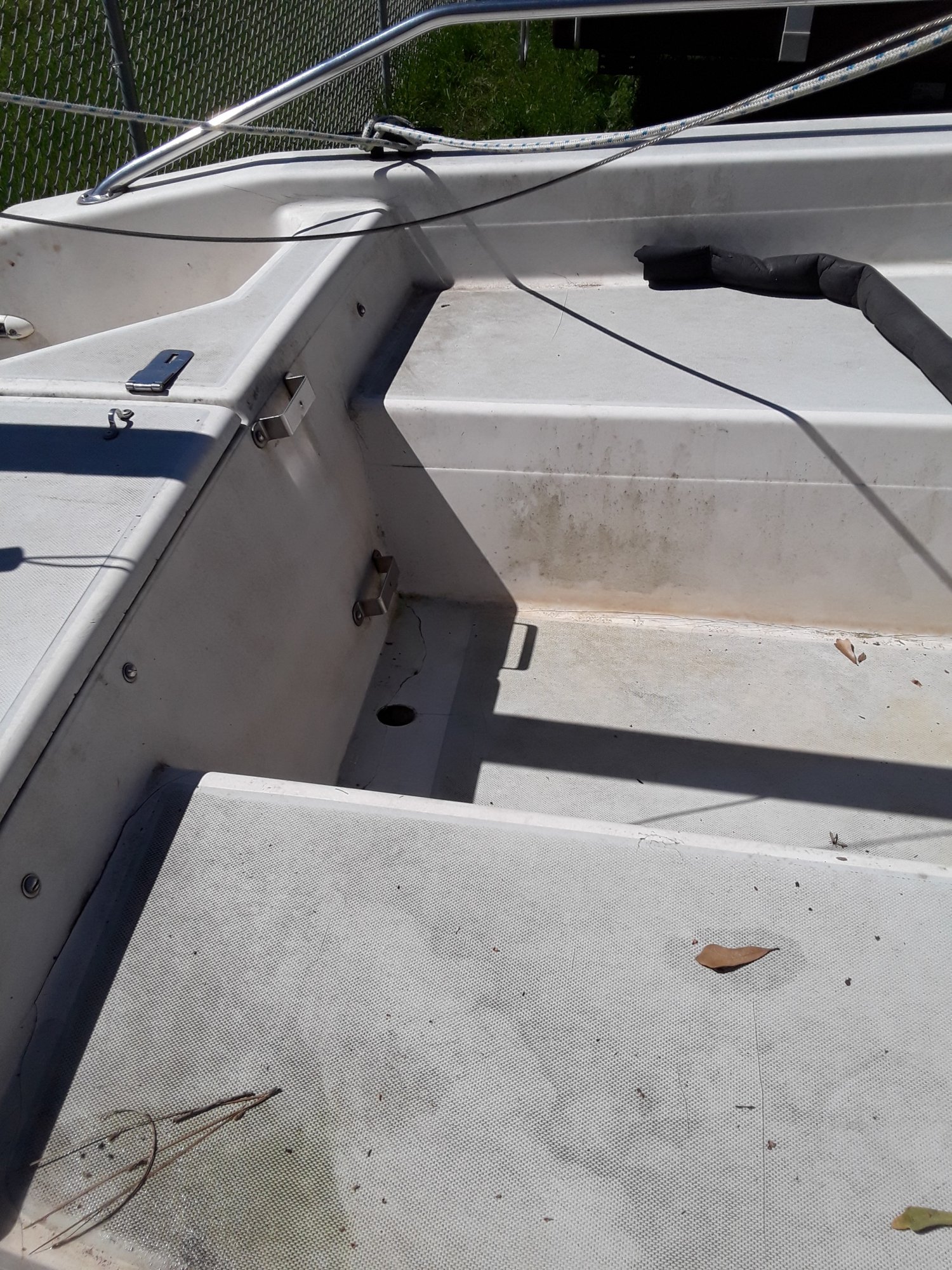

The 4x4 over the mast step sounds neat. I have an unused set of 2x4 brackets at the aft end of the cockpit. I think that is a good place for the top of the mast while trailering.
Dirt is from former owner, I will add mine on top of his!!!
