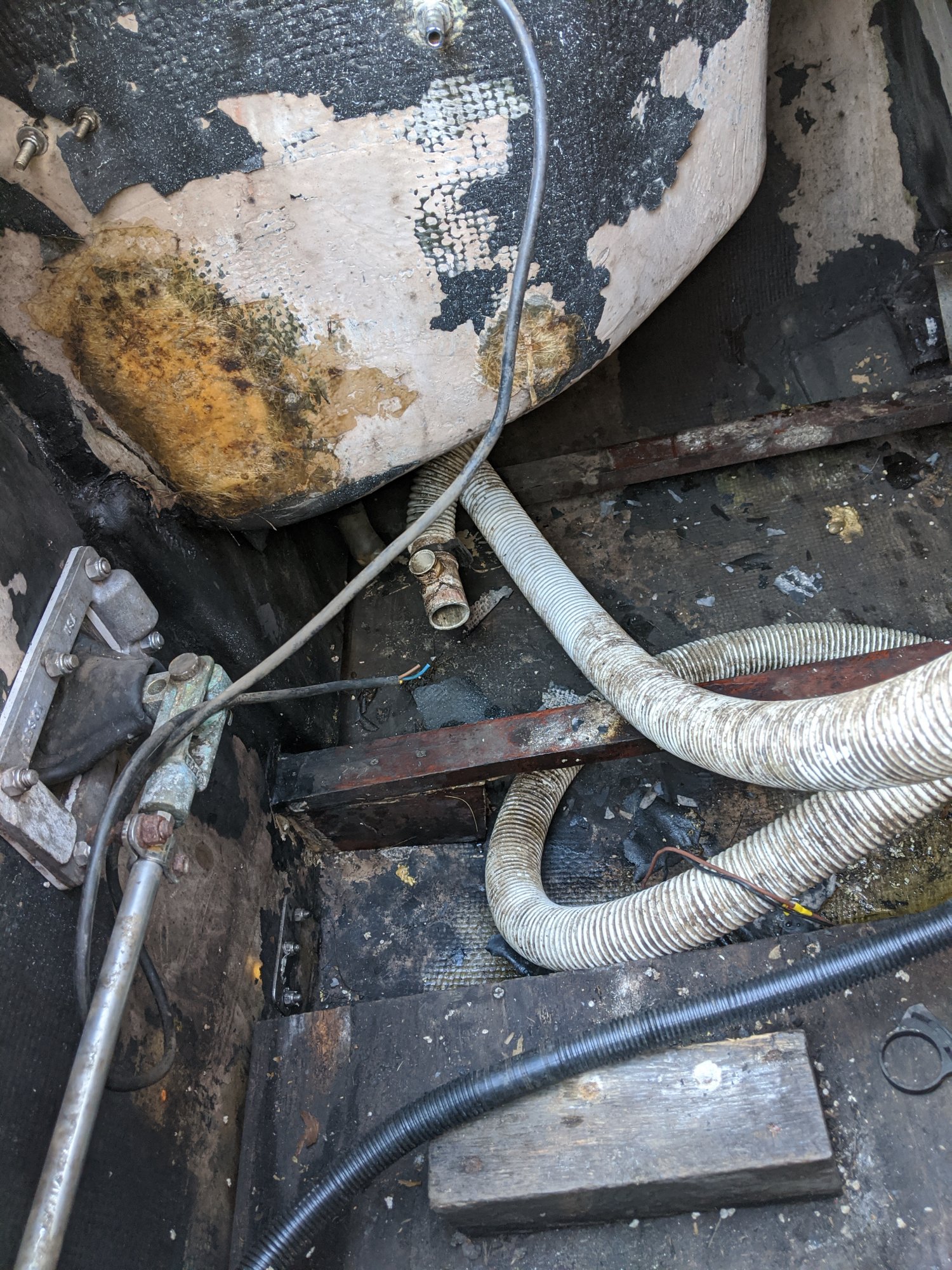

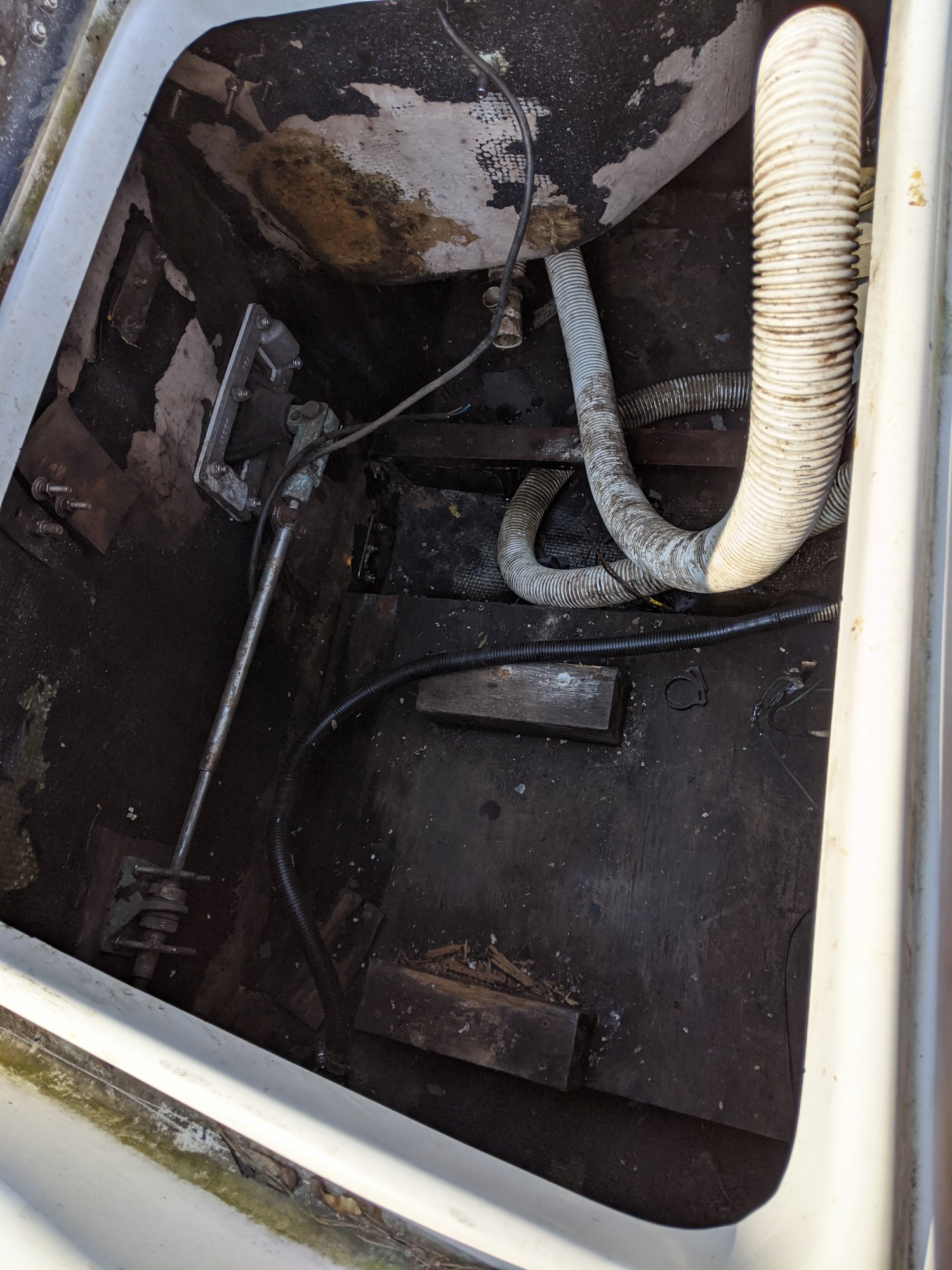

Today's progress! I got the seaward propane system and the 18 gallon fuel tank out, next is re plumbing the drains and installing a pump to help fight back the rainwater collection

I’ll wager that you won’t see enough water to pump after you fix that drain hose. I ended up using a reinforced pool vacuum hose to help support the weight of the water in the line. The bottom of the laz may get damp but you shouldn’t get any standing water. It’s not a comfortable place to work lol.
