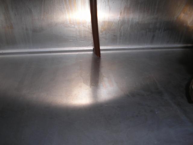

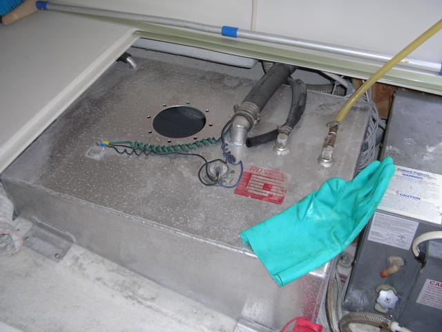

It's a hole that is large enough to see the inside. some tanks have them and some don't. Some owners add them. You can use them to see inside (with a flashlight) and clean out the tank. Similar to the ones on the fresh water tank.

Have you checked to see if the fuel pickup screen has been removed from your fuel fill line inside the tank?

og, read the link, fuel pickup screen in the end of the fuel hose from the tank to the engine. Only way to know is to look. I don't know if the C310 skippers have experienced this "issue" on their boats, but it is something to check if you're gonna be down there anyway. It's at the end of the fuel line inside the tank.

I had the same problem couple years ago and did the same things but had to change the fuel to resolve the issue. I used the fuel pump to empty the tank by putting a long hose on it. Made emptying the tank fairly easy. Gary
