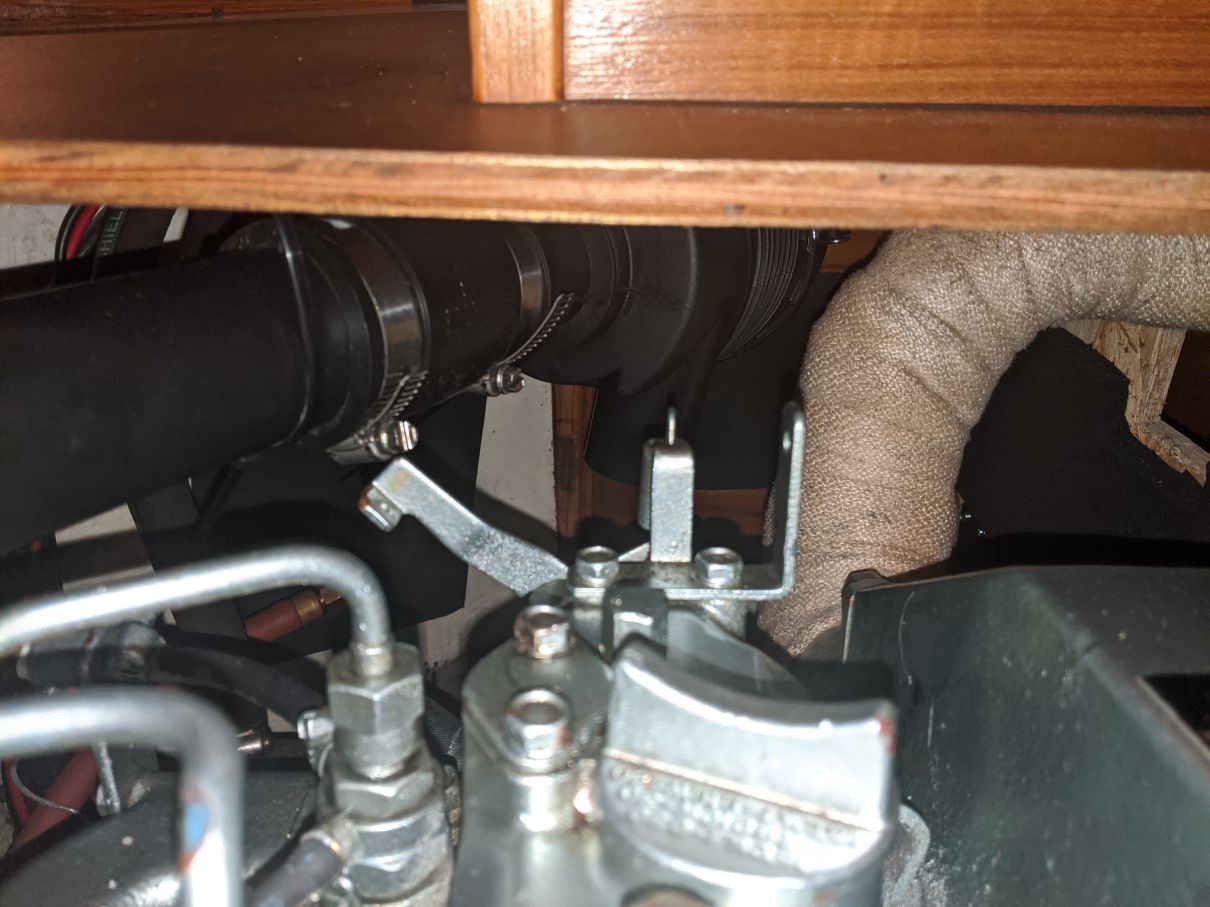

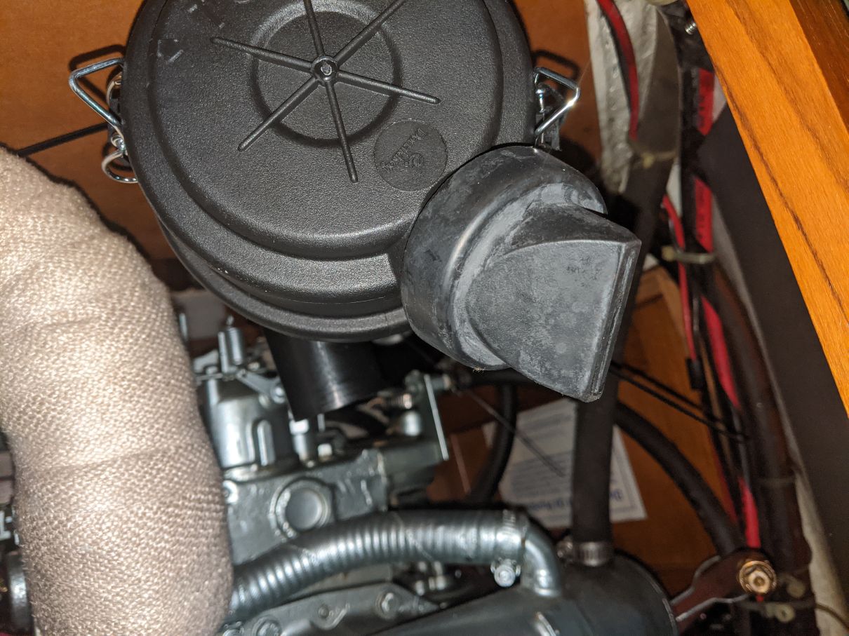

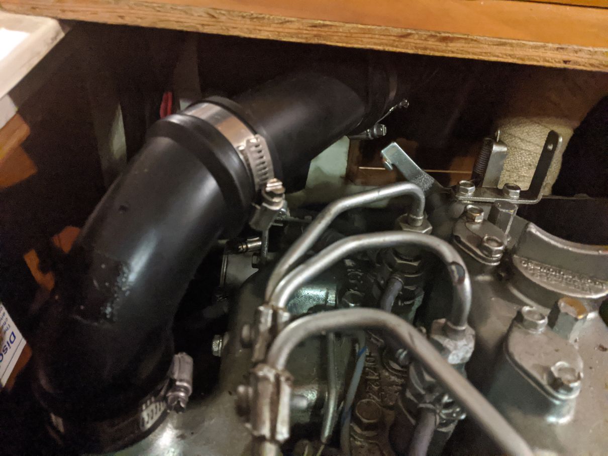

I did some research and came up with my own solution.
Based on a rough air flow requirement calculation (52 cubic inch engine at 3000 room) (calculator is here: Air Flow (CFM) | Widman International SRL ) it would appear that the motor needs around 41 CFM of air flow.
I found a filter unit, a Donaldson G042544, that exceeded the air flow need ( Donaldson G042544 ). I purchased this from Amazon. I purchased a 1.5" rubber elbow joint, 1.5" coupler,, and 1.5" PVC pipe from a local hardware store.
I angled the pipe and filter to hang underneath the galley drawers. They are currently supported with zip ties but I plan on ordering a mounting kit (I didn't want to do anything permanent before seeing how things worked).
The filter made a HUGE difference in the motor sound. It still sounds like a diesel--but a conversation in the cabin is now possible, and sitting in the cockpit sounds no different than sitting in the cabin of my diesel Dodge pickup.
We motored around in a variety of weather and water. I did not notice any power or performance difference with the motor. I usually run the motor at 2800 RPM, we saw 5.8-6 knots most of time (except when we motored upwind in 3-4 foot swells--then it was more like 5 to 5.5 knots, per the speed sensor).
I also purchased an oil separator to route the crankcase vent into the air intake, but I decided to go sailing instead of working on that project.
I'm not sure if others have made similar modifications, but I figured folks may be interested in the outcome of this project.
