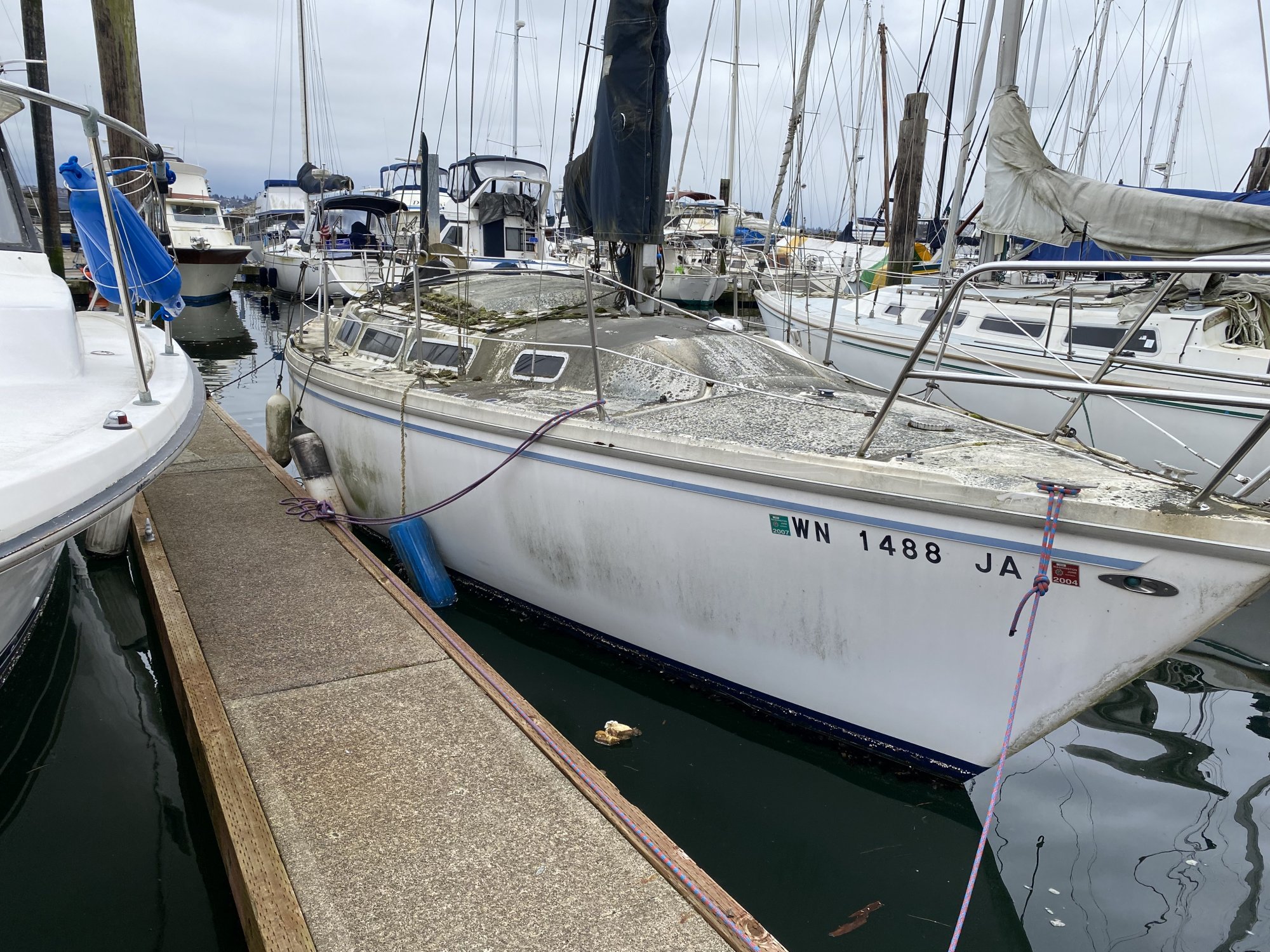

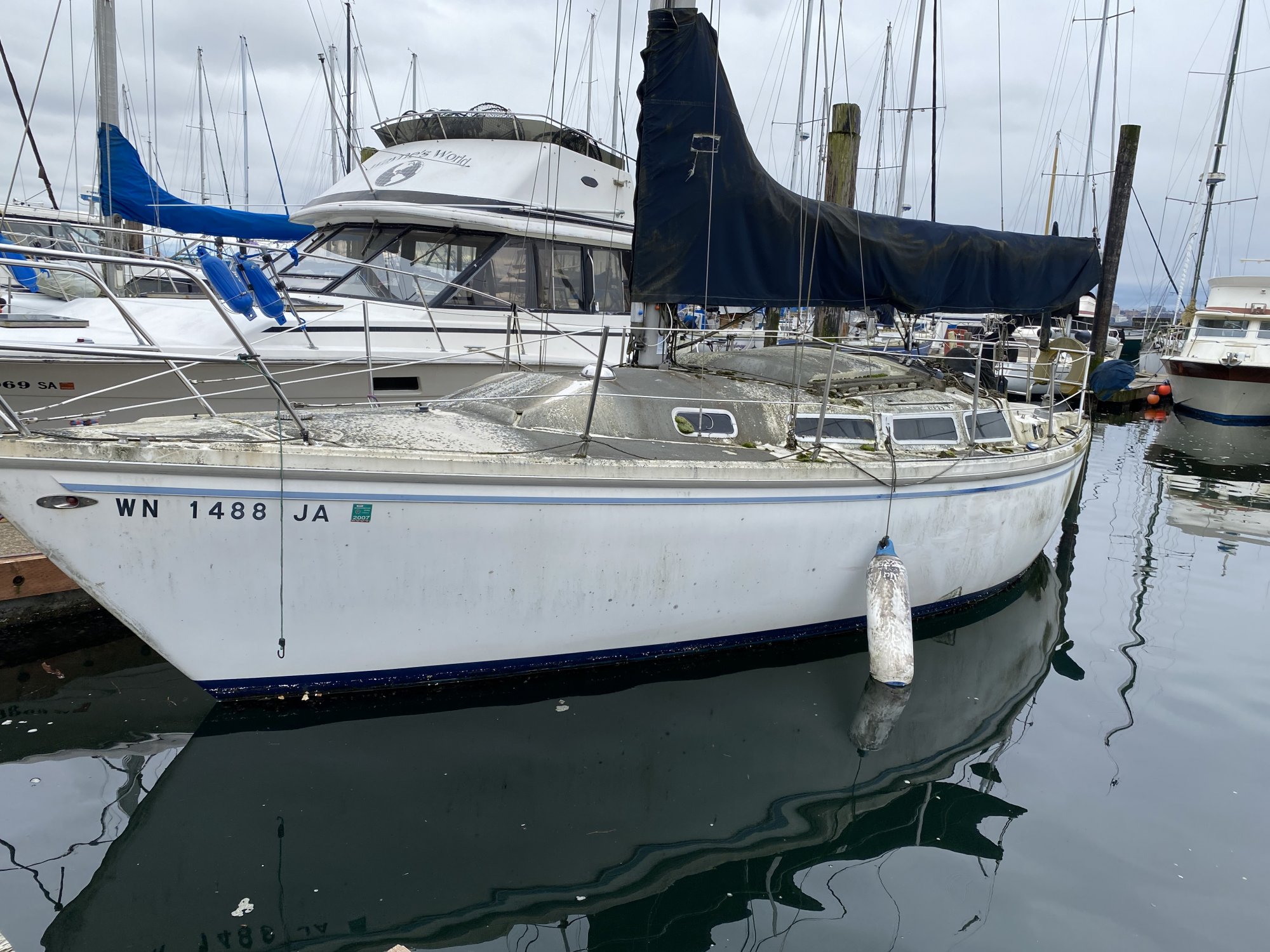

Hey everyone! Mike here, I just jumped into the Catalina pool with the purchase of a 1979 Catalina 30. I am going to call her Luna. She needs help… Thankfully a few months ago she found me… or did I find her… either way I bought her yesterday! Her previous owner passed away in about 2007 and she has just been sitting at the marina ever since. She has moss on her decks, and I’m talking fuzzy moss like what you see in a forest! Her running rig is worthless, but it’s all still there so I can easily replace it with new ropes. Her sails are in good condition, the jib/Genoa are in bags inside and the main has been kept in a sail bag on the boom. From what I can see the sailbag has done a great job protecting the sail, but the bag needs to be replaced.
Now you may be wondering why buy a boat in this condition…
Well the interior is actually in pretty good shape overall. Someone did steal her shore power cable and left the hatch open when we had some pretty good rains a few weeks ago so she has a bit of water inside now, but I will get that pumped out this week sometime. None of the cushions got wet so we are good to go there. It looks like we have everything we need to go sailing… well almost, I need to do a lot of scraping the hull, get her hauled out and cleaned/painted.
I do have a couple of questions for all of you guys out there. i have a little lever coming out of the cockpit sea directly behind the helm that appears to be a pump of some sort… what is it? Where can a get a nut for the helm wheel and also a new compass for the helm?
Here are a couple of pics of Luna.

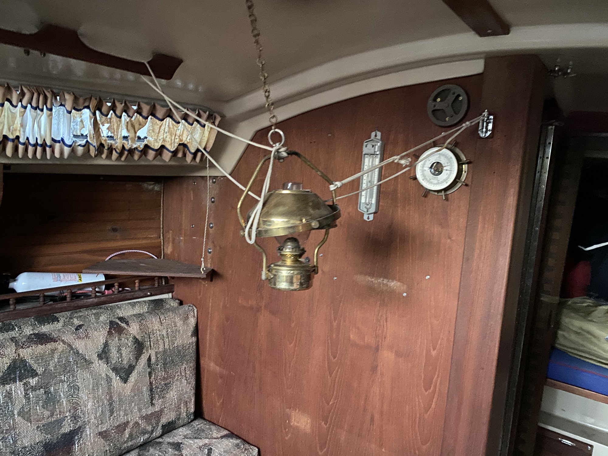

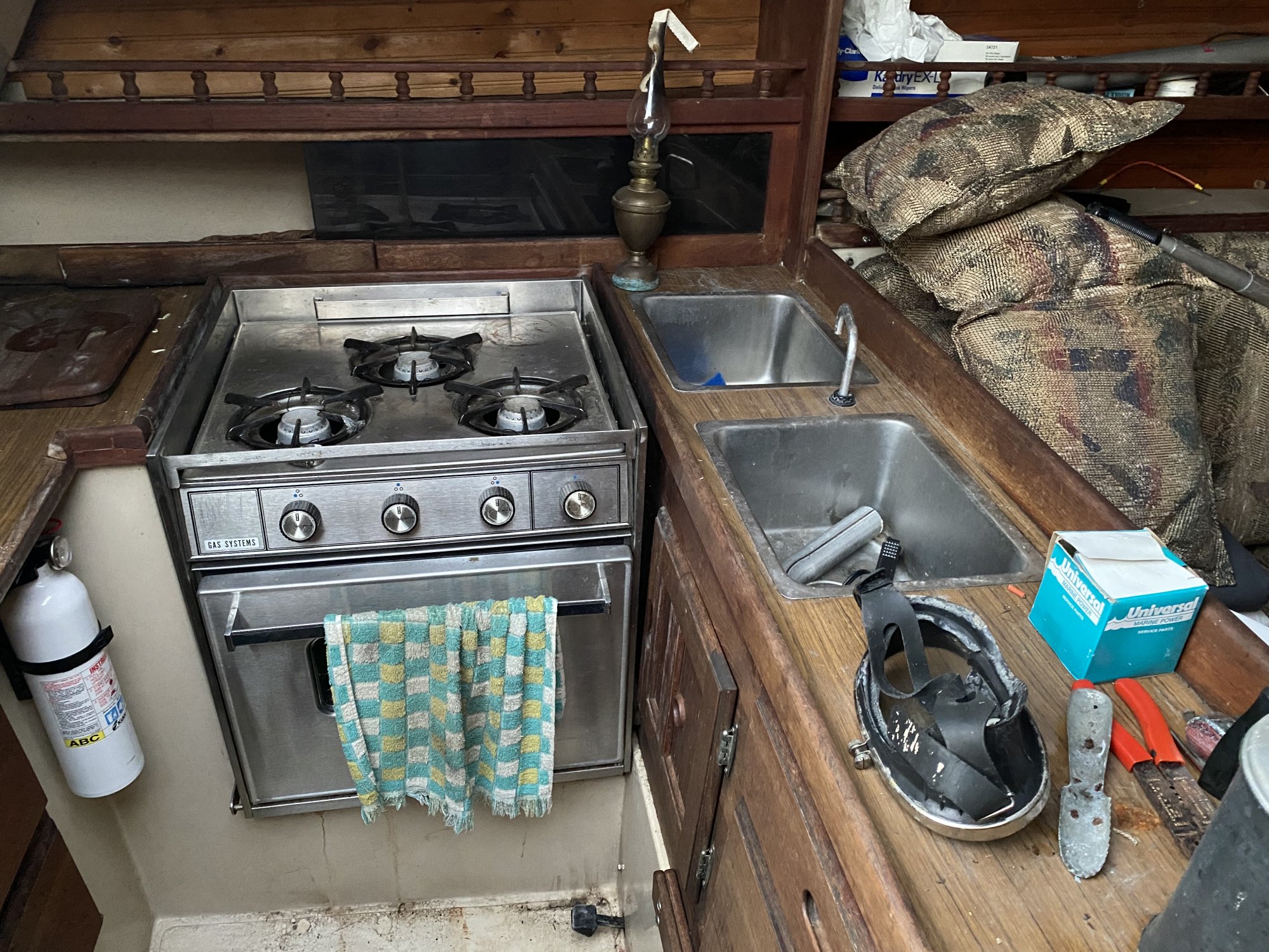

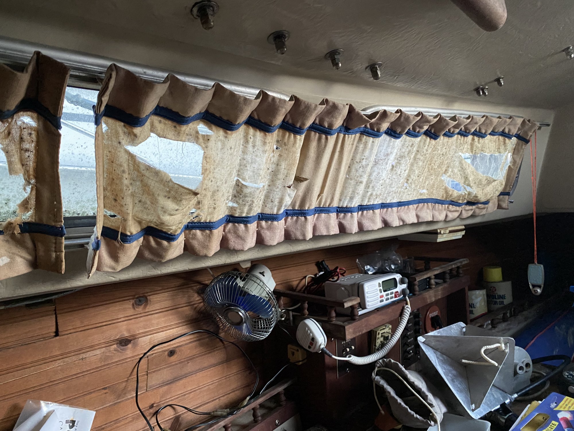

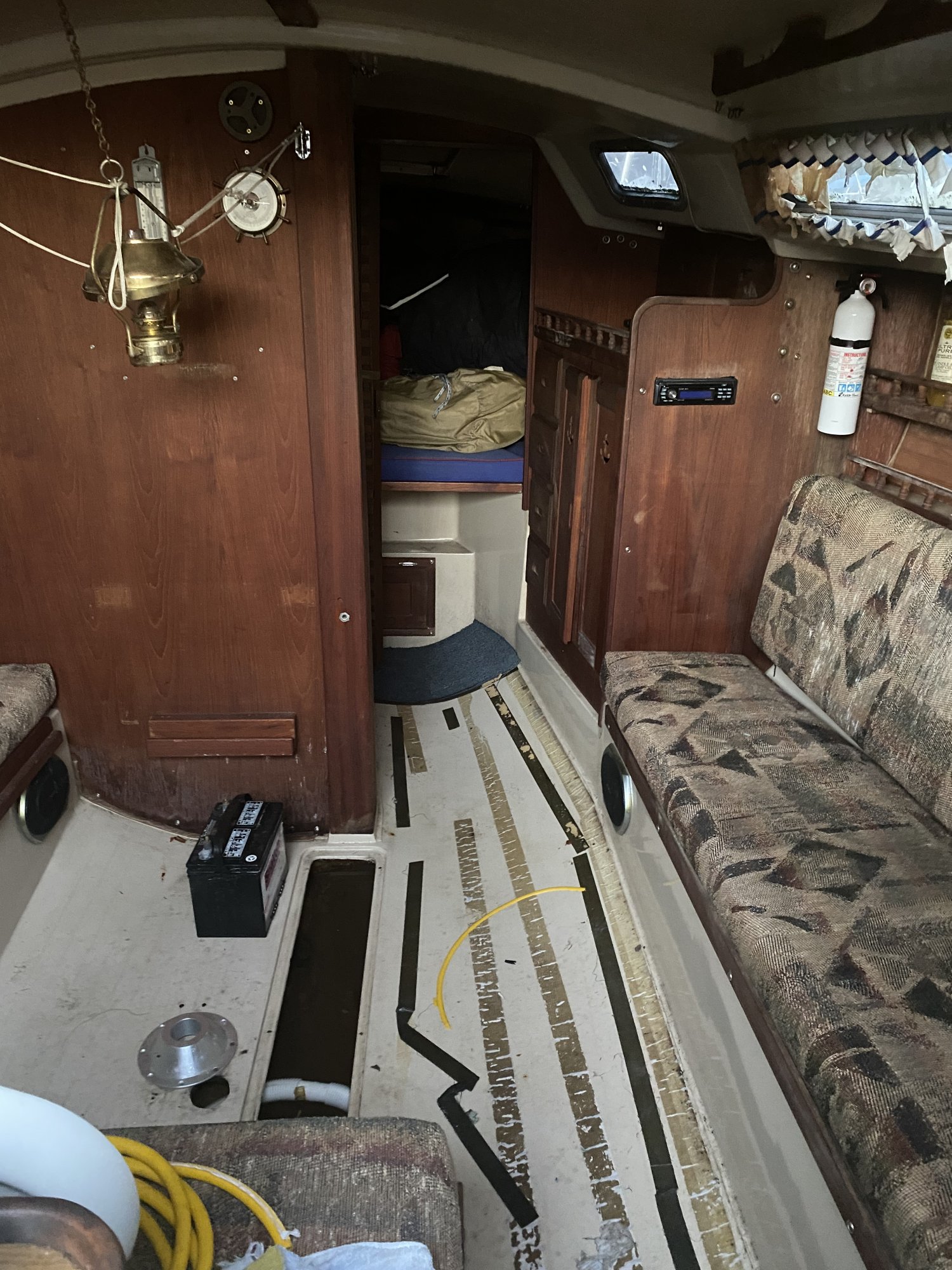

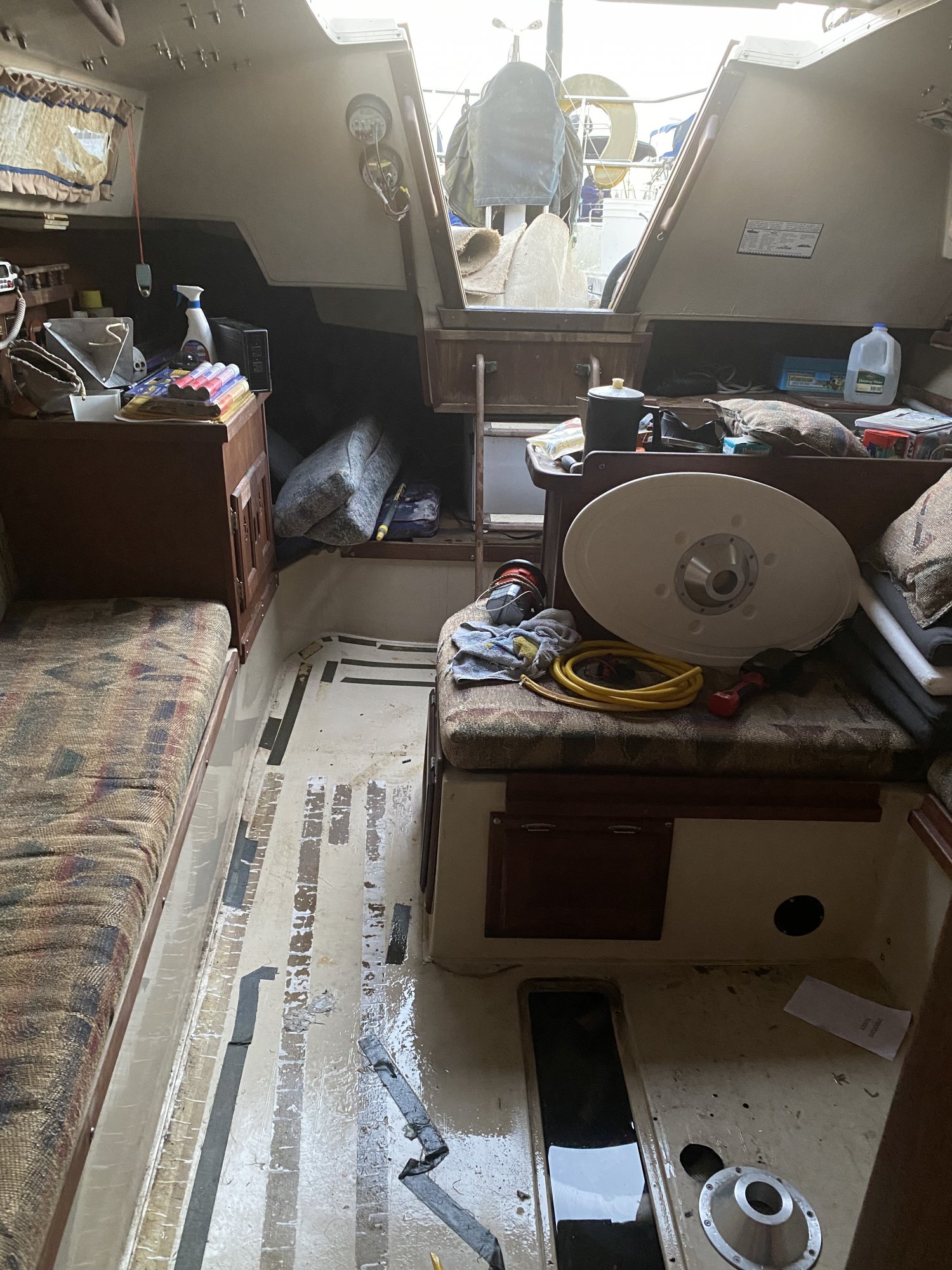

I got a few pics of the interior when I was out cleaning her up today. Yes there is water in my bilge, I did bail some out to get it off the floor and only in the bilge. It’s fresh water either from some leaking chain plates (found 2 that were wet) or from windows leaking, I found at least one of them. I have plenty of work to do, but that honestly is my favorite part, I love making old junk new again. I get way more satisfaction that just buying shiny. So the curtains are rotted, I need to make some new ones, the cushions are actually ok, and I have a bit of mold removal still to do. Oh and the lines on the deck were from the tape that used to hold the carpet in place. It was house carpet that was oddly overlapped and cut from many different pieces. I plan on making some patterns and cutting all weather carpet into “logical” pieces that will allow bilge access and what have you.
I think I need to learn how to sew… lol. This is the 3rd boat I currently own that needs sewing services. Well the first one has all the sewing done now, but my Bayliner Capri is all rotted and so are some of the pieces of this boat. At least there is a quality radio on board… I have a newer Standard Horizon radio with GPS and all that, but the one here is not bad. I don’t know if it works yet, I have not put power to the boat. I don’t like where the house batteries live, but I have not found a better location yet I need new ones of those too.
