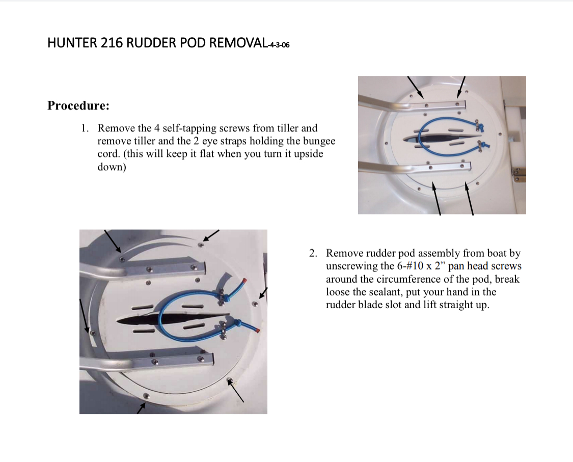

If you think you need to pull it out to inspect here are instructions that came from Hunter.
