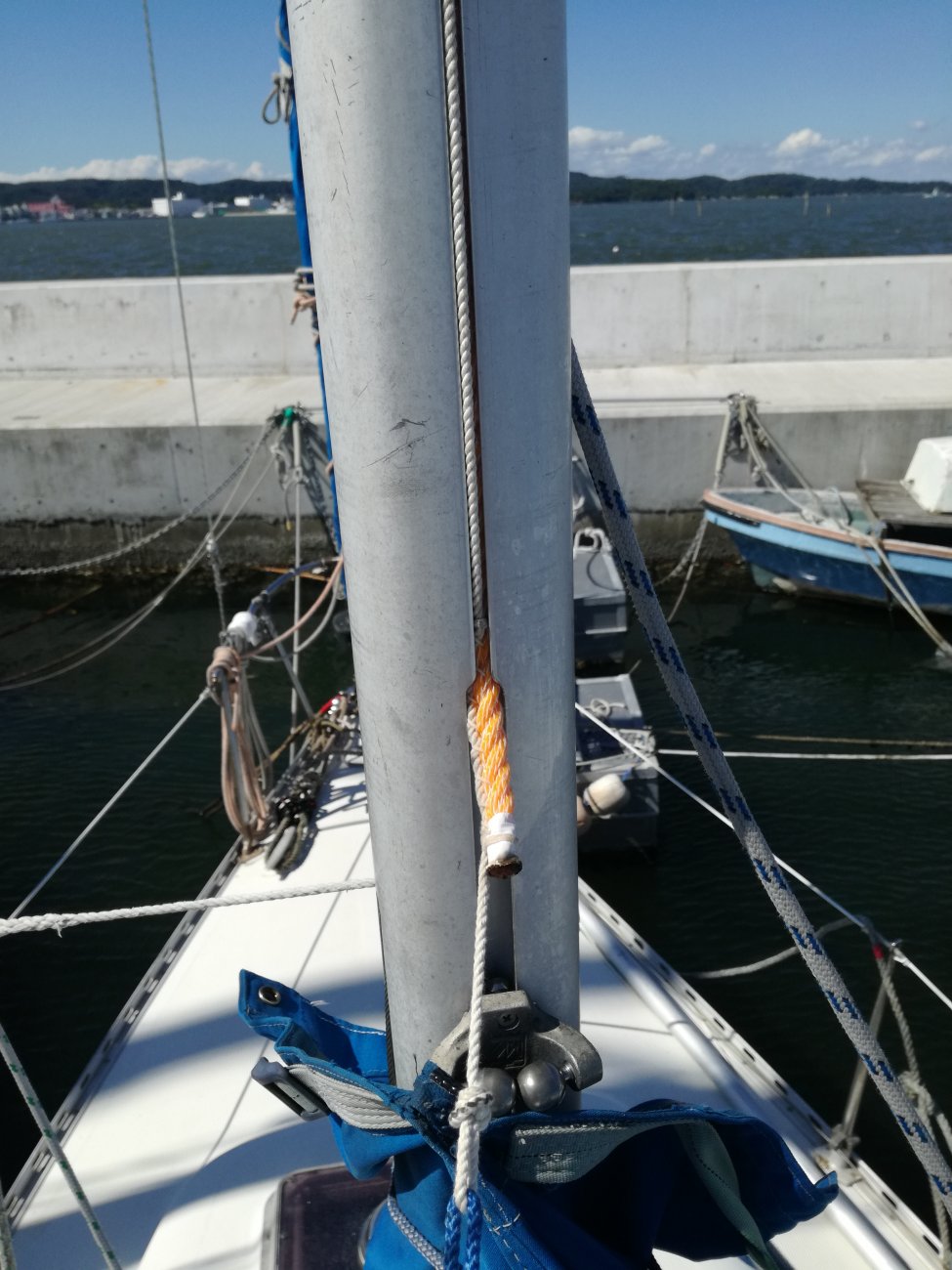

You need about a foot of rough cleaning rope that fits the track pretty snugly.
Parallel to the rope you whip on a piece of lighter line that is 2 or 3 inches longer at each end (See Pic 1).
There should be an eye in each end of the lighter line.
The whipping will make the diameter of the rough cleaning rope even snugger in the track.
Connect the main halyard to one eye and feed cleaning rope into track. (See Pic 2)

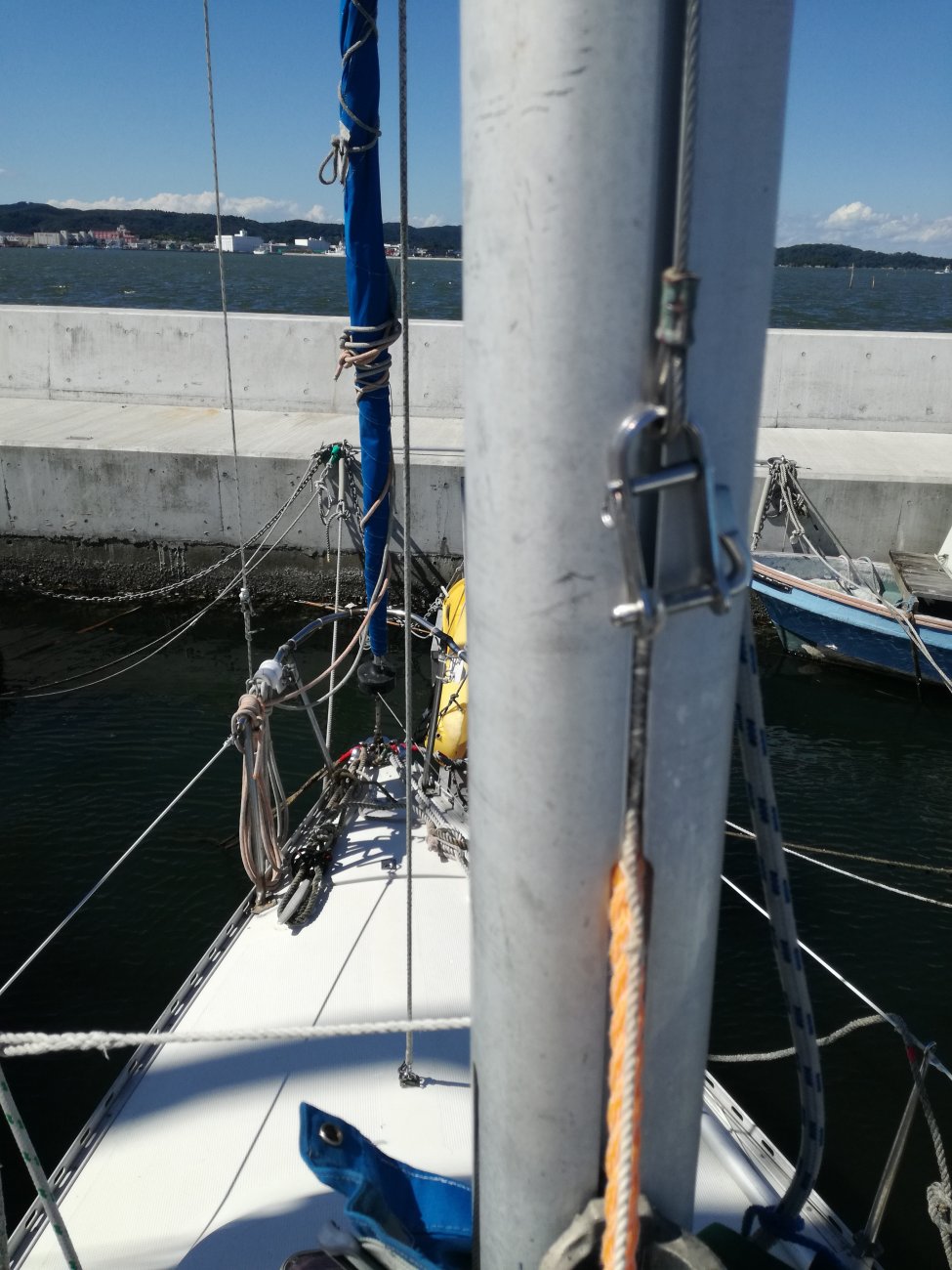

Connect a light down haul line to the bottom eye.(See Pic 3)
Haul up a yard or so and haul down a few times then repeat as you raise the line up the track.

When you have cleaned the whole track haul the cleaning rope
down , spray it with track lubricant and repeat the haul up/down to lube the complete track.
Will take 30 minutes to make the cleaner and 30 minutes to clean and lube the track. I do it once a year as a part of maintenance.
